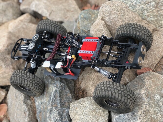

Here is a comparable build I did a couple years back. HH/TGH Sherpa chassis very similar to what VP offers in the carbon. (same axles I stole from a Phoenix kit). I want to make the carbon build lighter and better CG with the VFD and Stubby kit.
