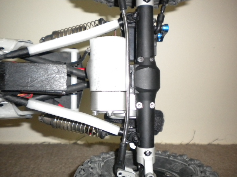

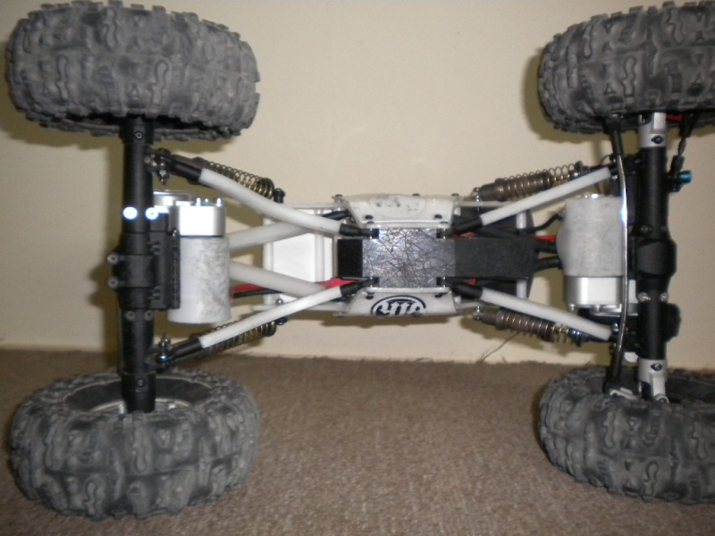

i did try a little front bias set-up ....
rear lowers:
chassis - jato rod ends
axle - jato rod ends
front lowers:
chassis - trimmed 4mm jato rod ends
axle - revo rod ends

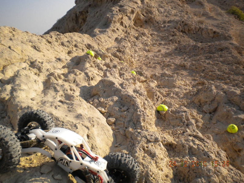

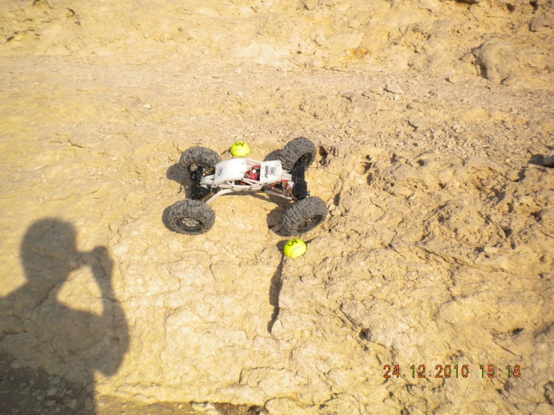

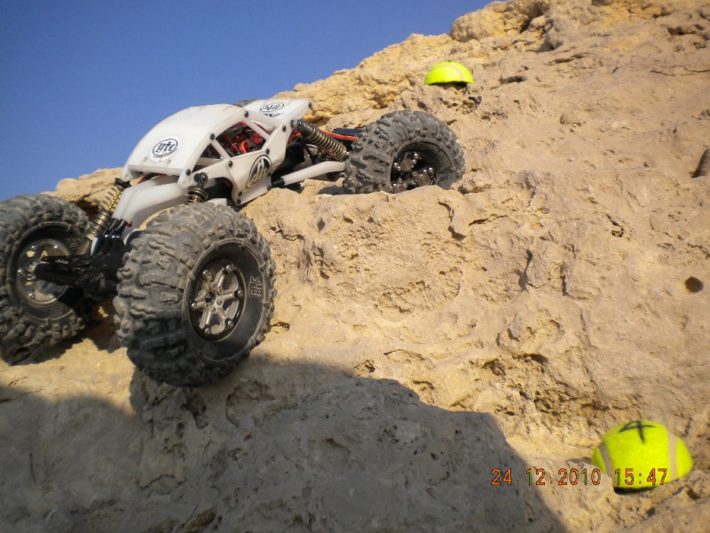

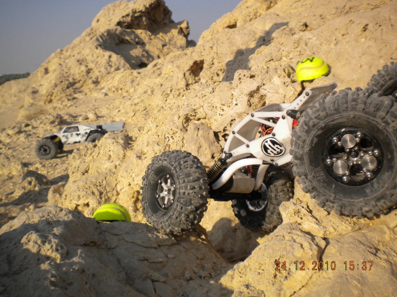

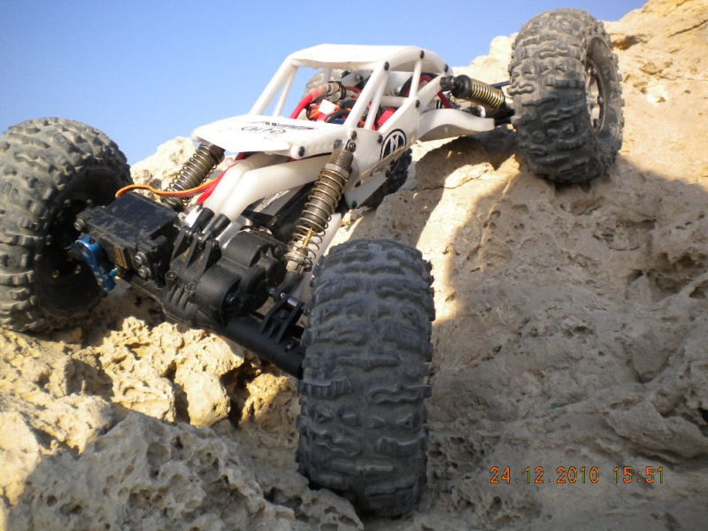

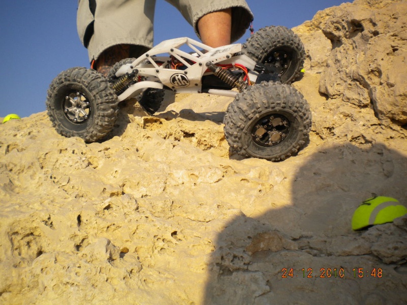

did some christmas eve crawling

Did you notice much change in handling when you moved your front shocks inward? I'm having trouble with my tires hitting the preload adjusters when at full turn and spinning them. May have to try this.
nice looking rig there"thumbsup" looks like a nice place to go crawling!
thanks ... we got a great spot in the middle of the city .... still in the dessert though ... but the rocks are amazing
Rig looking sharp!!
thanks ... so far so good .... when i placed the shocks inboard .... i used 460 offsets for the rear to compensate for sidehilling ....
not much of a big difference in handling except for the fact that my tires dont rub the shocks as much when turning "thumbsup"
Those rocks are very cool and look HIGH GRIP!
That is in the middle of the city?
hey DT .... some areas have high grip surfaces which will rip your tires open .... some areas have slippery surfaces as well ....
and yes its in the middle of the city ....

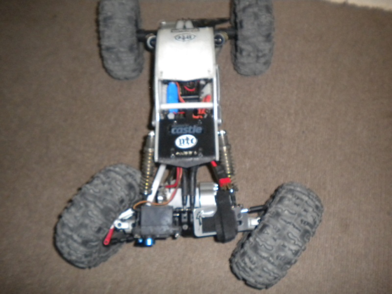

just weighting in .....
Pro DH's have 3 VP slugs and 3 Nova slugs on each wheel .... waiting on rowdy's battery plates to reduce the batt weight from the chassis and more front bias ...
Not a bad weight at all!

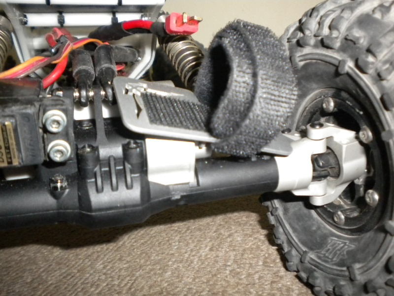

ive added rowdy racings batt plate on the front axle .... got me more unsprung weight off the chassis .... added crawler innovations slugs to fill up my DH's up front as well ...
rig weights in at 5.75lbs RTR .... it handles and drives a lot more predictable now "thumbsup"
and "yes" moving the battery out of the chassis DOES make a big difference in handling predictability

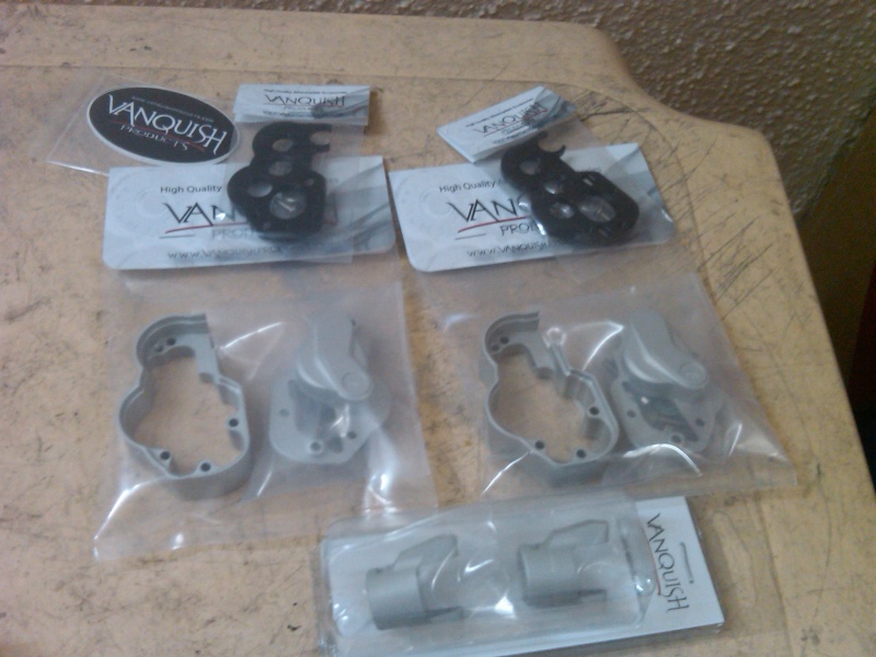

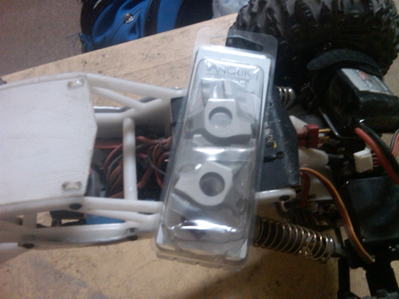

Transmission Cases .... Motor Plates ..... Knuckles and Chubs!!!!
stock gears which ive been running since October 2010 are still in very good condition!!!! the 9mm mod does work!!!
"thumbsup""thumbsup""thumbsup"
im gonna tear up the front and rear axles later and have the babababaling installed!!!!

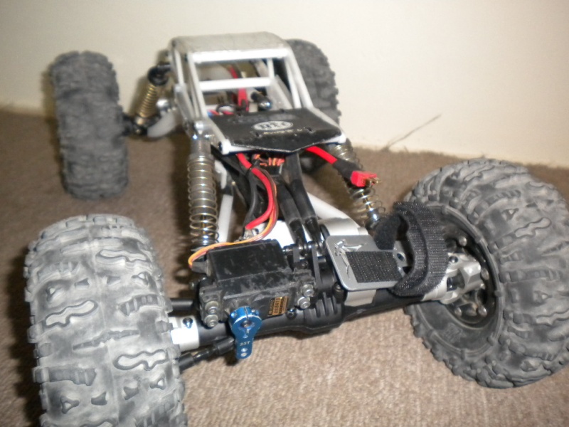

this is how she stands now .....
Rowdy Racings Battery Mount "thumbsup"
Steering "thumbsup" plus my custom ss tie rod with jato ends "thumbsup"

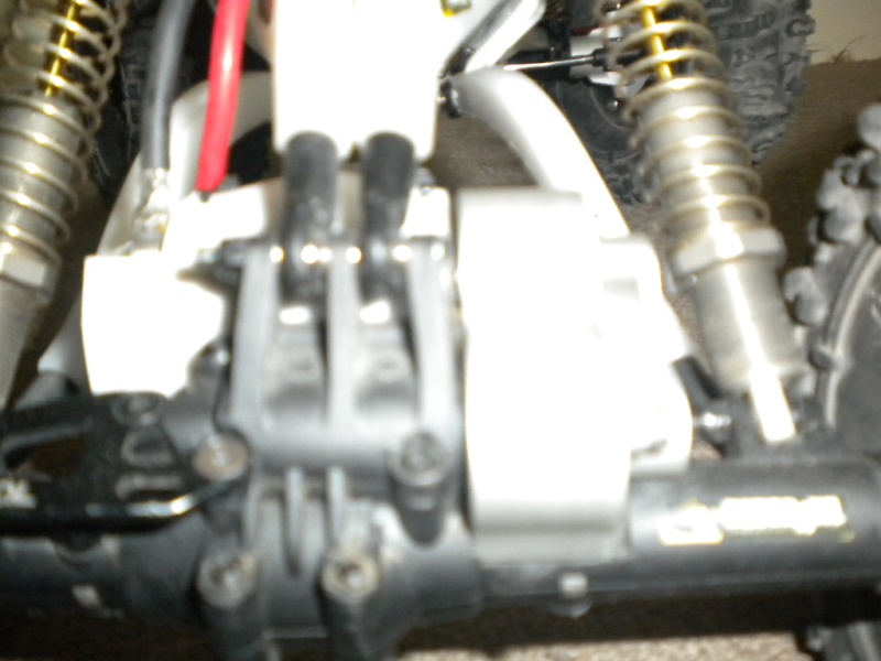

more VP Bling "thumbsup"
im really happy with how the rig is set up and how predictable it is now .....
one thing though is that did anyone else notice the transmission cases get a little bit noisier after the VP case and Plates were installed? :roll::shock:
