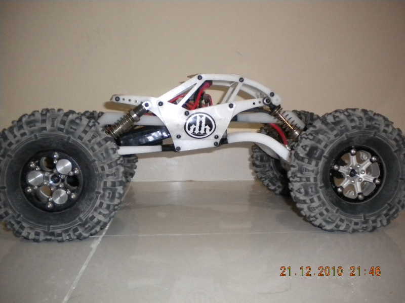

Lowboy v3 XR-10
looks like your running the same lower link I am. I used the following for my rod ends to get the 12.5" WB

Put some Losi gold springs on there and you should be set. Oh, and get rid of those Axial upper links, they will bend easily. Otherwise great looking build so far."thumbsup"
the stock uppers are a bit flimsy :roll: ..... might go with the axial aluminum bent links ....... the losi golds have always skipped my mind when placing my orders .... i'll make sure to get a set .... ive read good reviews about them as well ... "thumbsup"8)

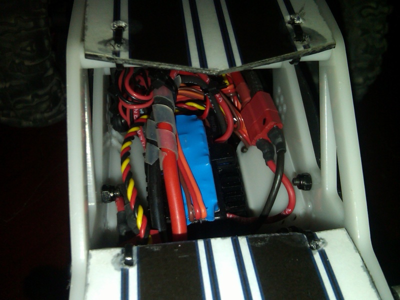

place the micros back to back as ol' gravy did
i was a bit worried at first cos they did nothing but sputter and cog but after hookin em up with the castle link .... they were smooth from the first throttle and the drag brake is insane ....
they barely heat up as well

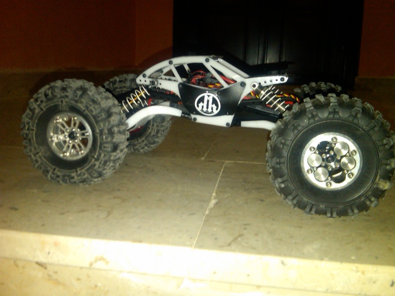

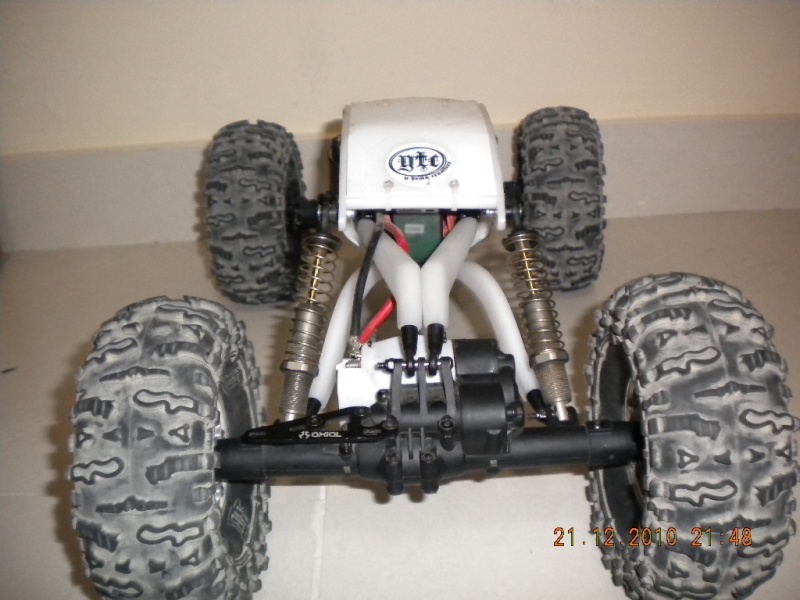

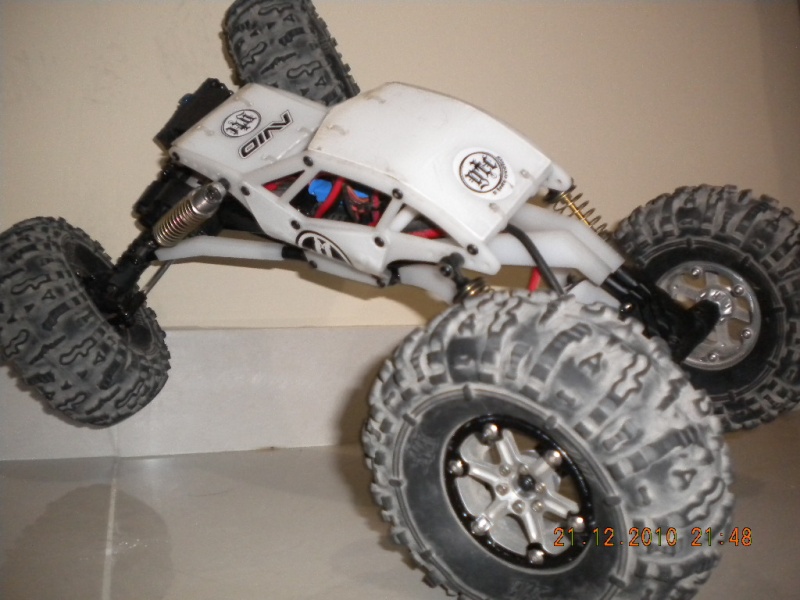

just some crappy finished pics just outside the porch .... wheelbase sits at exactly 12.5" now
i need to customize me some delrin uppers and yes .... i do need losi golds ...
Looks good!

just a couple of pics ...

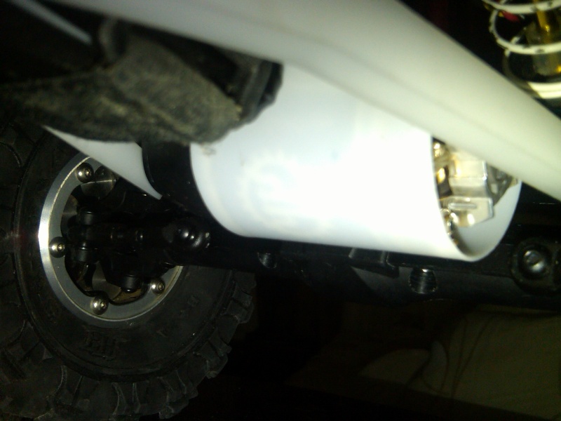

customized me some motor skids from white plastic folders .... zip tied together :mrgreen:

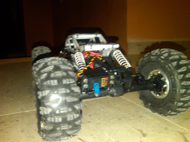

moved the shocks inside and extended the shock rod end so that the wheels dont rub on full steer angle "thumbsup"
the electronics crammed inside ... the micros are tiny .... lots of space in the v3 ;-)

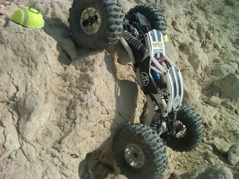

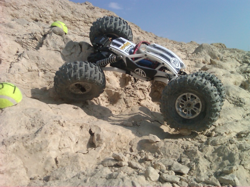

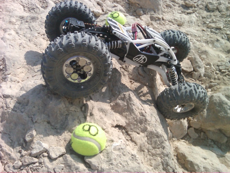

im gonna get her out on the rocks on friday and will post aaction shots ... ive been doin some crazy throttle blips on carpet and it looks like the 9mm bearing mod is doing its job!!! "thumbsup""thumbsup""thumbsup"

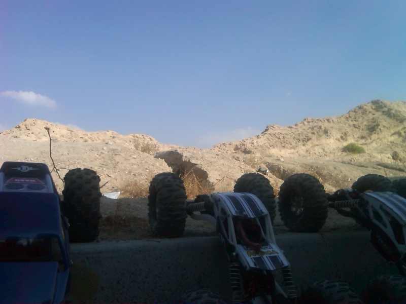

video will be up soon ..... had a gtg with the crawlers here in dubai .... just a couple of action shots .... "thumbsup"
:mrgreen: :mrgreen: :mrgreen:

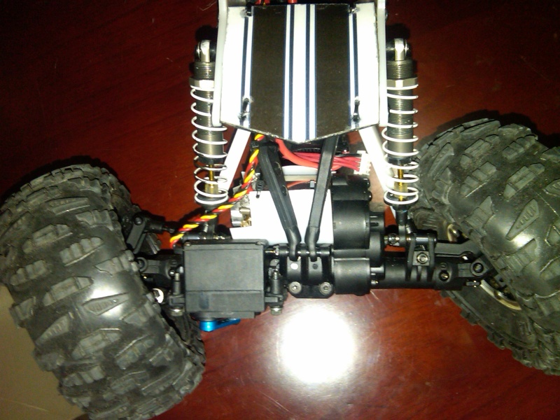

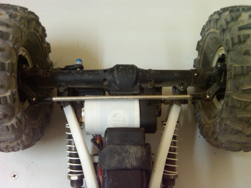

did an aluminum threaded rod mod to the BTA steering .... the stock linkages just wobble like anything while turning :shock:
i ran 4 packs of 1200mah 3s on the xr-10 axles yesterday with all sorts of crazy throttle combos ..... the 9mm bearing mod seems to be doings its job ...
What size rod did you use? Which rod ends? Did you have to shave the case like the others? (looks like you did)
i used 149mm threaded rods (end to end with out rod ends) ..... the rod ends are the standard revo rod ends from traxxas .... "thumbsup"
i didnt shave the BTA case .... left it as is and limited the EPA on my transmitter .... the tires will rub against the shocks if i do let it steer maxed out anyways .... so i left it as is :mrgreen:
the threaded aluminum rod did take out all the slop in steering .... nice and solid now "thumbsup"
Sweet! Where did you get the rod from?
