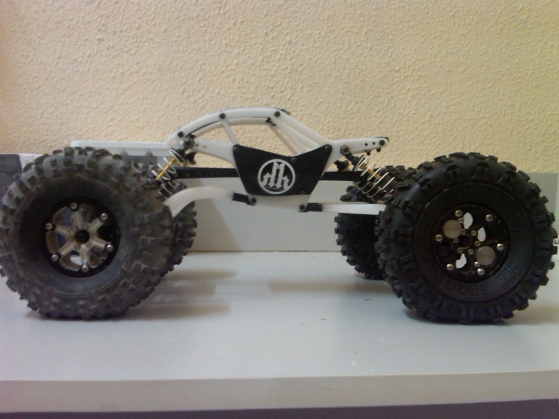

this is how the rig stands now! just not sure if i need to lower the chassis? .... :roll:
im sure the clearance will be a little higher than what it is now after i get the sedonas mounted ... :)
Measure at the front of the chassis, lowest point. That's where everyone else does. Looks like it might be a bit higher than the avg, but not too bad
i'm thinking of limiting the shocks internally so i can lower the COG .... but im really not sure on the average belly clearance and over-all height of the beetlejuice chassis ....
its almost a full inch higher in the belly compared to my fastback ...

You wont get a true measurement of clearance til you get the battery and electrics in. So i wouldnt go adjusting anything yet.

To get my ride height correct I ended up drilling another set of holes behind the front shock mount locations. I kept the spacing the same and followed the same slight curve of the other holes when laying it out. Worked great. Limiting the front shocks internally wouldnt have been enough travel if I put in enoug limiters to get it where I wanted. It works great at 3" static (fully built with battery).
thanks .... "thumbsup"
that would lower the front end of the skid and maintain the same ride height at the rear ... "thumbsup" ... great advice ....
i placed 10mm limiters inside the shocks before so i was hesitant in limiting them more cos the amount of compression in the shocks would not be enough ....

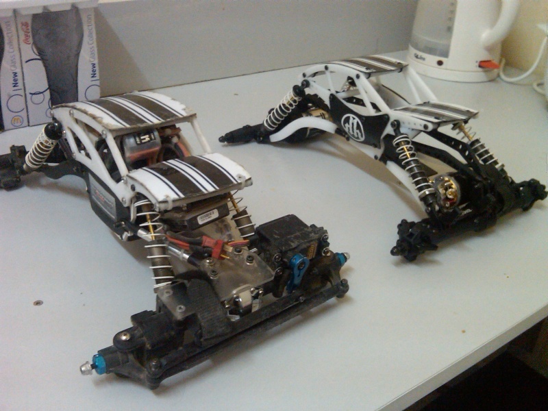

sittin beside my UGC Fastback R1 ... with some new panels
this is how she stands right now .... :ror:
i need to get me some rock poser shots though :lmao::mrgreen:
