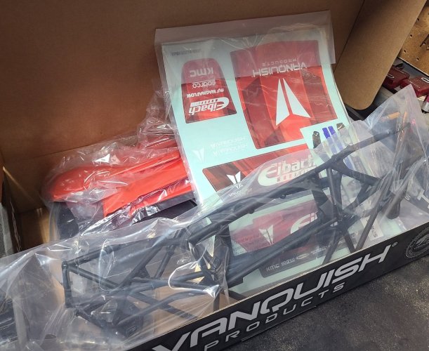

I bought this kit for my son Samuel for Christmas. He's currently 6 years old. Out of all of my kids (I have 5) he's the only one who enjoys RC crawling, scale details and careful, realistic driving. So he got an H10 kit for Christmas. Everyone else got coal.
And he got the red, Eibach livery. Which I'm pretty thankful for. And he is excited about it. My Miller Motorsports truck will have a 1.9 wheeled partner now.

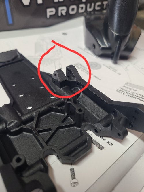

As @Col_Sanders mentioned in the "Optic Kit Coming" thread, the front, passenger's side link mount needs to be shaved for a Hobbywing Quicrun Fusion SE 1800KV motor / ESC combo to fit on the skid plate.
The inboard side needs a very slight shave. 5 minutes with a bastard file was more than enough.

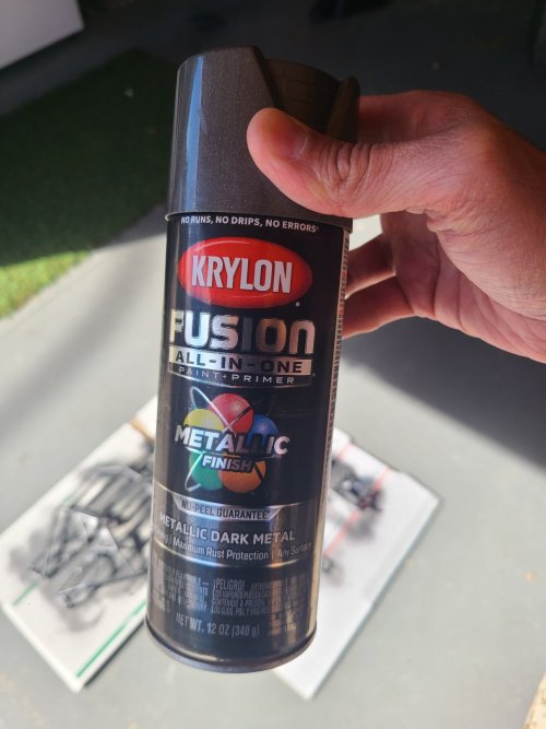

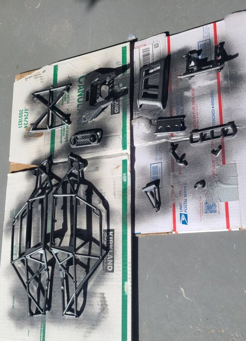

And take that Vanquish Origin! A metallic looking cage without paying $4K.
I know it's not as cool, but this is as close as I'll ever get to a full-metal tube chassis. And the Krylon Fusion Metallic colors are even more durable than the non metallic colors they offer.

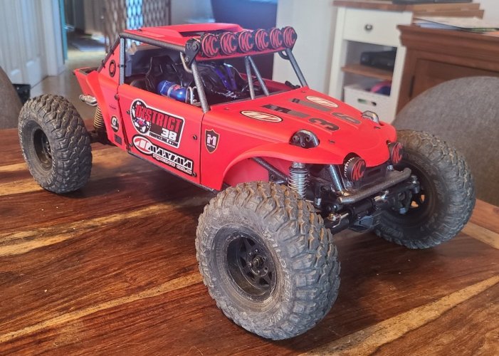

We finished this truck several months ago, and have been driving it with a 13T pinion and the 1800KV motor on 3S.
My son's birthday gave rise to the opportunity for me to buy him the Terra Bug kit from Knight Customs. Brian W on the forum here printed it and sent it to me.
We finished installing the panels today. We also geared up to a 16T pinion. We then commenced to stickering it up using left over stickers from my stash.
The kit went together easily as planned. The only change the instructions need is to have you glue the air filter on AFTER you install the engine into the chassis. The duct blocks access to one of the installation screws.
My son wanted to keep the stock interior. He also really likes the power tank, but the new radiator can't fit with the tank in the stock location. I moved it to the passenger seat, as there's really no room for a passenger anyway.
I hope you enjoy the pictures. And let me know of you're interested in some free red Eibach panels for your H10.
That's the best built Optic wtih those panesl I've seen, excellent work!

The cage looks great too in the close up pic. The metallic paint makes it look so much better!
Thanks! Krylon Fusion's Metallic Dark Metal is awesome for cage painting.
It's easy to apply too, you have to fuck up pretty bad for mistakes to show. The only hard part is being patient. It needs several days to cure before you start being rough with it.
