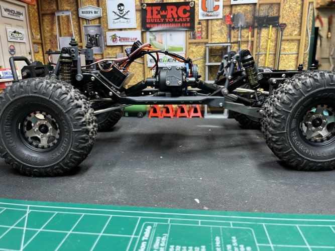

And in my case I put one in a Capra, so I was able to use the stealth x and the stock interior without cutting holes on it.
I've been wondering how a X fits in a Capra, seems like it would solve 2 shortcomings in one cheap transmission. The belt drive looks like it could be a great option for a 3 gear swap w/portals. Normal swap ends up really slow.

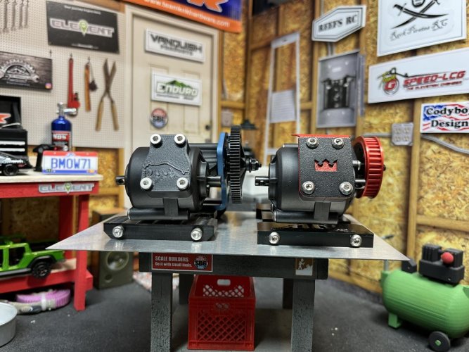

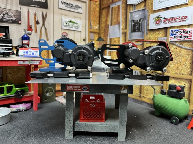

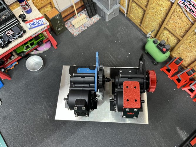

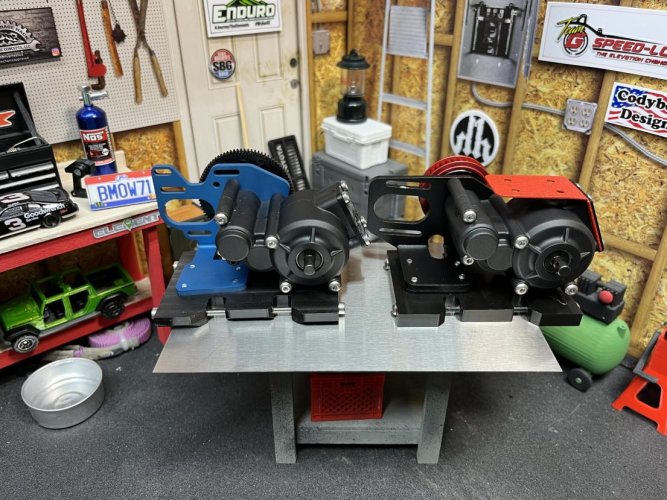

Here is a look at the side-by-side comparison of the IERC LDT and the Foxbelly V2. The Foxbelly V2 has upper holes added in the alum plate to attach wiring too. The IERC has an angled plate up and over the top of the trans to aide in attaching wiring too and has longer slots in the motor mount to accommodate larger pinion sizes. Also to add, the IERC comes with another alum plate that can be mounted to lift up the trans if needed. In the pics below, I have the plate installed.
Both great designs and hold the Stealth-X trans in a similar position.
In the last pic, I placed the the IERC LDT without the delrin skid onto the stock Element skid to give and idea of what it looks like compared to the skid.

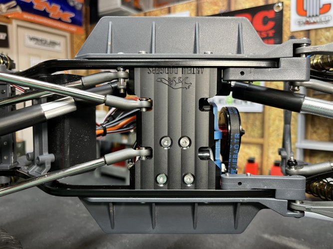

For now, I'm using this new Ecto to show off the Artfull Dodgers Foxbelly V2 LCG motor mount.
Straight forward install. All of the mounting holes line up with chassis rails holes and all stock hardware can be used. As seen, I did replace all of the stock Element black oxide screws with Team KNK stainless steel screws. One thing to note, I had to install the rear upper link screw backwards with a nut on the outside on the shock tower to clear the rear driveshaft. The Foxbelly pushes the output shafts farther out near the rails and the threads of the screws was touching the driveshaft.

That is a way cool transmission setup. I imagine it's whisper quiet with that belt drive.
It is cool and different! The perfect setup for a semi-full interior build.
It is super quiet. Like a 1:1 electric car all that is heard is tire lug gripping noise.

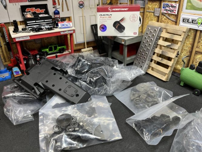

It's been awhile since any updates here. I actually forgot that I started this thread!:roll:
Anywho, I came across a great deal on FB Marketplace the other day. Someone had a brand new Vanquish VFD Twin with alum gear plates and machined gear set for a price that I couldn't pass up. Already had a Fusion SE 1800kv ordered from Amain Hobbies and both of these showed up at my door today.
So (like I need another rig like I need another hole in the head) I'm gonna use this VFD and start a new build here in this thread. No need to start another build thread for another rig that I probably won't complete anytime soon. I'll just log all of the info here as I find time to build it.

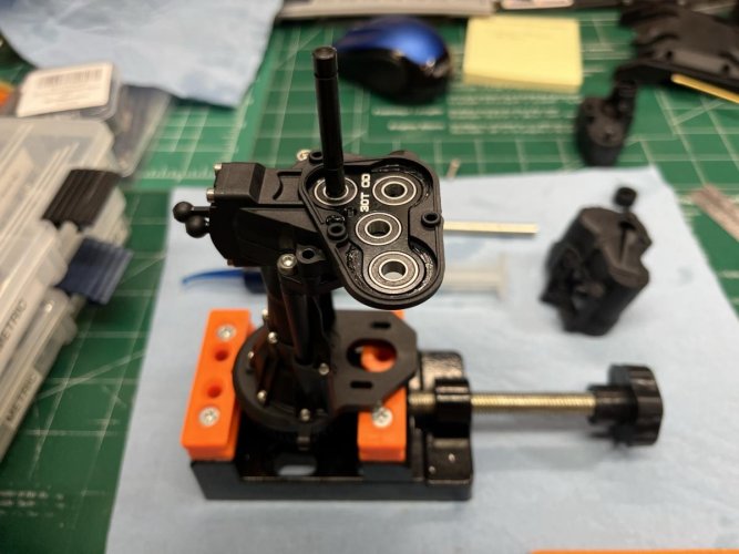

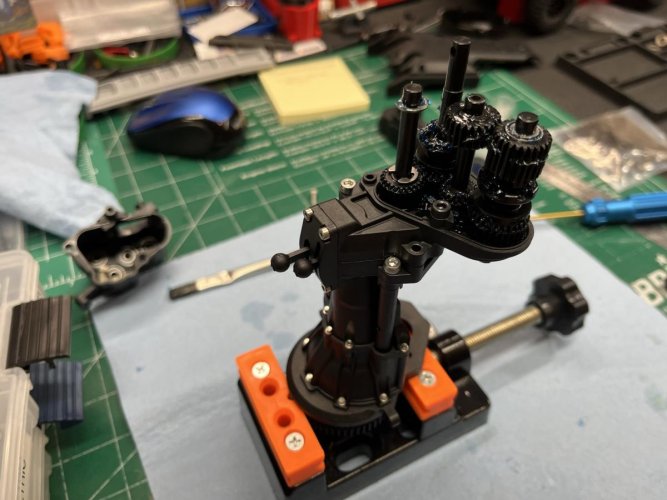

Put the VFD Twin together. I went ahead and used the alum bearing plates and machined gear set. Only parts missing to make this trans complete is the alum standoffs and an alum motor plate. I'm not a big fan of the plastic motor plate or standoffs, so I'll have to place an order at VP for them.
I had some scale M2 screws left over from another VFD, so I installed them on this one. Also replaced the rest of the M3 screws with Team KNK stainless steel screws.

Update on the VFD Twin build that has been sidelined until just recently. New GSpeed V1-C1 rails have arrived along with a set of ShrinkRC hard body slider mounts.
This new build will get it's own thread in the coming days.
It's been awhile! A couple unfinished builds back in the garage. One or both will eventually get their own build thread eventually.
This one is the GSpeed V1-C1 chassis equipped with a VP VFD Twin and Axial AR45 straight axles.

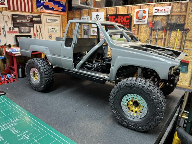

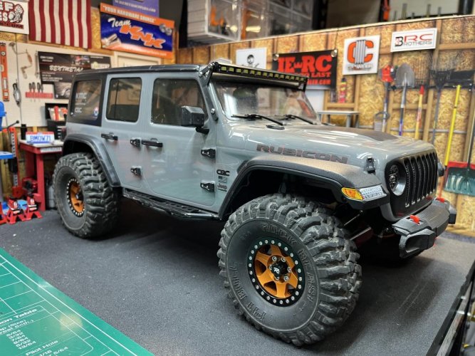

This one has been hanging around the shop for months now. It started life as a VP VS4-10 Builder's Bundle from last years Holiday deals. Someday I hope it will be a nice, scale Toyota Extra-Cab pickup truck. I really need to get back on this build!:roll:
Installed these "take-offs" wheels and tires I stole from another rig to put on the Axial JLU. These are Vanquish Method 310's wrapped in a set of well used, but still road legal Pitbull Rock Beast tires. This combo will live here until they find another home!:roll:
Love the look of the extra cab. Ive got a couple builds im workin on myself, or atleast tryin to get done lol
