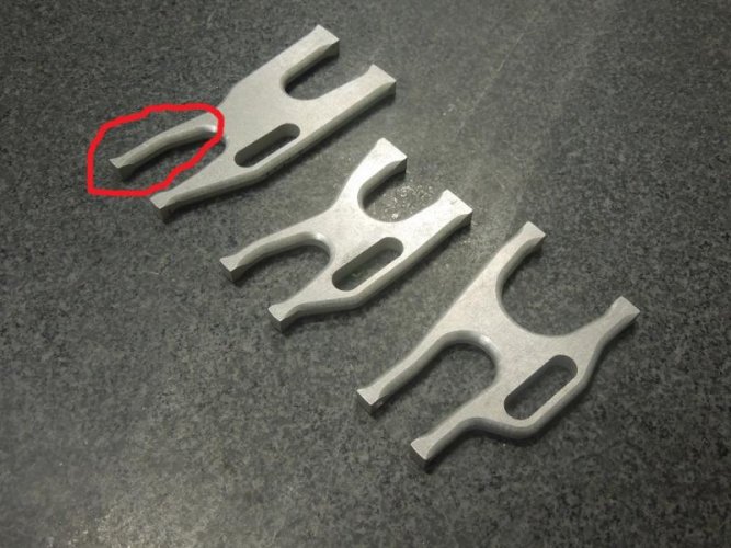

here are a few of the lower control arms i've been playing with. from top to bottom:
EXO in a wraith/yeti
EXO in an SCX10
Traxxas in an SCX10
plenty clearance for large CVDs. i thought about bending them too because it would be sexy but i think that would take away ground clearance and i'm not sure i want to go in that direction.

BM,
Add more material thickness in the area shown. Because of the floating outer hinge pin design a frontal impact (to the tire) puts all of the stress on that area and they will bend. Otherwise they look awesome!

so i did a little redesign on the control arms over the weekend and the result was pretty sweet. i had to order a reamer for the pivot areas which should be here tomorrow then i'll be able to machine a few sets and shoot some pics. can't wait to show off the finished product! "thumbsup"

the new BMRC front control arms are truly awesome... nothing like anything else i've seen. pics/preorder on monday. shipping 8/15. they will give you almost 1/4" of additional ground clearance over stock and aftermarket aluminum control arms. they are also designed clear the biggest shocks and CVDs.
i used everyone's suggestions to redesign and refine the older prototypes pictured earlier in the thread. THANKS BTW!

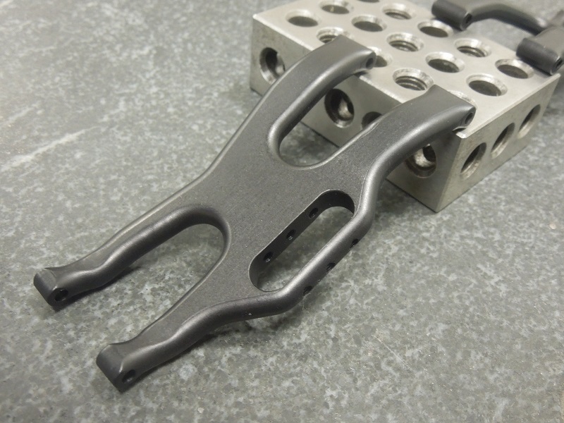

Here are the pics of the Yeti / EXO control arms. the first 4 "actual" pictures are a copy of my last working prototype. as a final step i wanted to go ahead and have a set anodized to see if the holes shrank during the anodizing process. the pivot holes are reamed after bending to ensure proper alignment and need to maintain the correct size or the pin will be too sloppy or too tight and not fit. FYI these are kinda hacked together (made manually). the production control arms will be CNC machined and have a closed bottom to protect your shocks as shown in the last 2 pictures.
I tried to get a good angle so you can see the major ground clearance improvement simply by adding another bend a the top. If the arm was any higher - your MIP CVDs would be lower than the bottom of the control arms and vulnerable to rock rash.​
