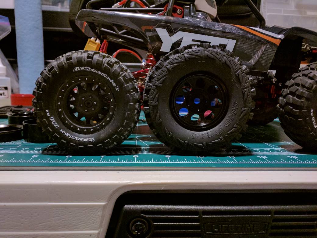

Finally made the move to proper wheels and tires
Boom Racing terra beadlocks
Rc4wd Wrangler MT/R 1.55
Crawler innovation lil'nova single stage foams

The tires are super soft and the Rubber is as High end as it gets.
The stock rc4wd foams are firm and fill the tire completly. They are still squishy on the side walls.
The crawler innovation foams are extra hard, single stage. They have no squishiness on the side walls, pretty much wont roll at all.
They dont fill the tires there seems to be about 1/8 of an inch, maybe more, of free space.
Im not an expert but i guess the CI foams would have more contact with the road so more traction and less roll over due to the hard closed cell design.
The stock foams would look bigger and maybe crawl better being softer.
I will add pictures when I mount the beadlocks.
