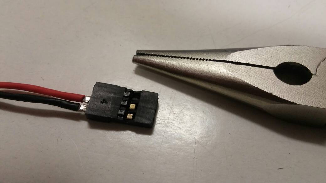

Testing setup for lights. Without lights :-D Just checked with voltmeter and it works as expected.
Next on the list is some soldering!

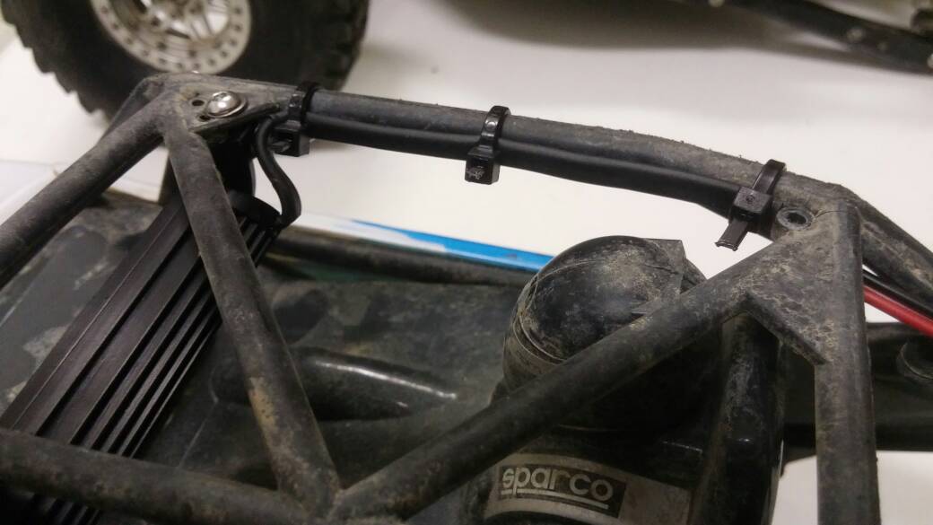

Rear lightbar ready for soldering...

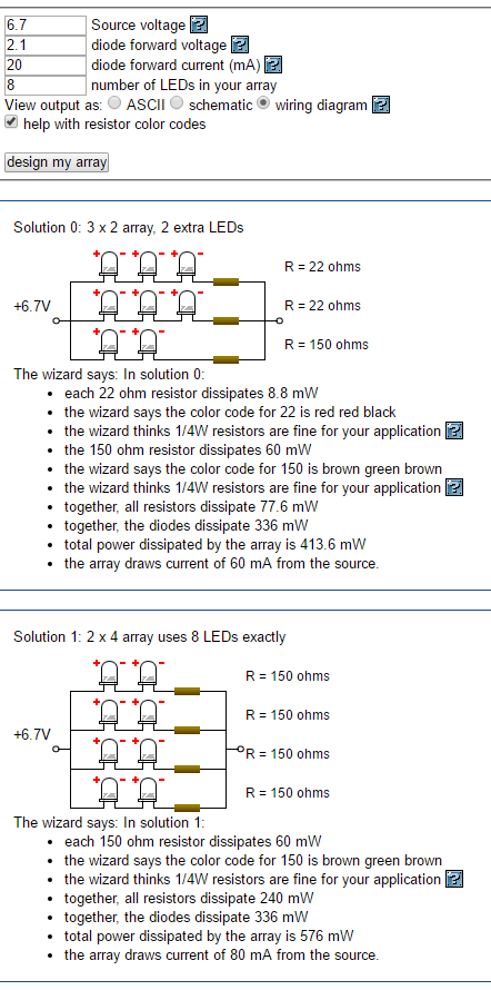

I measured voltage on heyok outputs and it is 6.7 both for 2S and 3S pack. I used 150 ohm resistor for each two LEDs in series. Then each pair od LEDs is connected in parallel to power supply.

I can now finish rear lights shortly - planning to add another four light buckets to accompany rear lightbar. It will be basically same wiring. After this I will put everything back together and destroy it!
