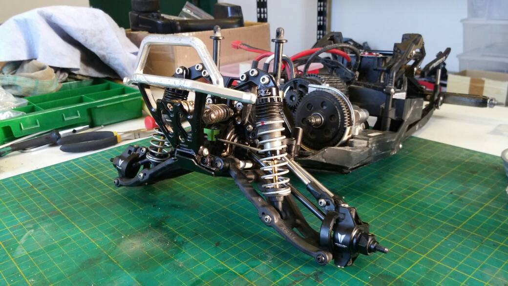

Rebuilding front end.
Worn front diff outputs.
Freshly rebuilt shocks.
Freshly rebuild front diff bulkhead.
