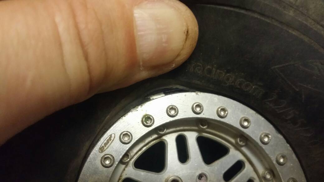

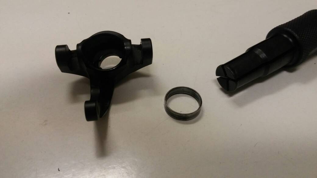

Swapped wheel hubs. Now I use even shorter .350 on front and .475 on the rear. This should prevent any bend shafts. Even with .475 on front and .650 on the rear it was almost OK. And I still have those spare titanium shafts from CREEPERBOB...
hat same prob. if you look from the tyre side you see small gaps in the ring. i was able getting mine out with a small flat screw driver and a little hammer. very carefully forcing the broken bearing out switching sides . but i will also get a bearing retainer soon and bearings......
