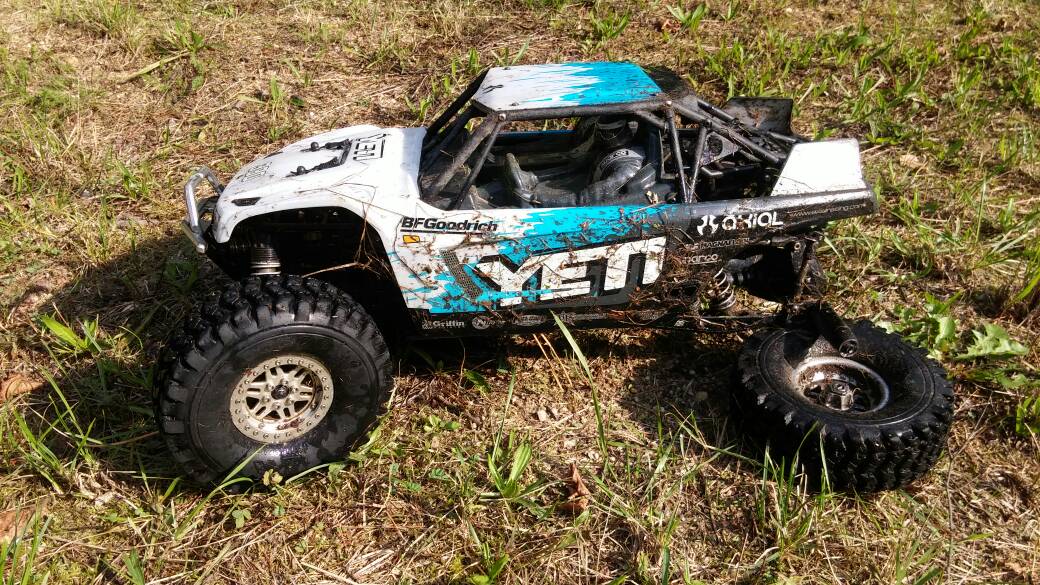

Second pack and this happened during one flipover on asphalt. I stepped up one level - not bending shafts anymore, Im breaking them and even with shorter wheel hubs! [emoji48]
This is Vanquish shaft. Have one replacement pair on hand and also CBRB titanium ones (saving them for later use). Everything else is holding wery well. No broken rod ends anymore...
I will not run on asphalt again, I will not run on asphalt again, I will not run on asphalt again, I will not run on asphalt again, I will not run on asphalt again, I will not run on asphalt again, I will not run on asphalt again, I will not run on asphalt again!
