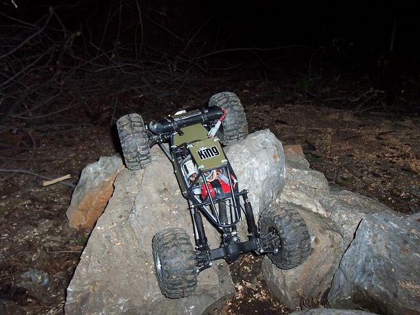

My WK trail rig :
- Cut chassis
- Battery upfront
- Grooved tires
- RCGuy servo mount + diff locking spools
- HexTronic HX12K servo
- 15T pinion + 96T spur
- E-Savage driveshafts
- Custom links (6-32 allthread, K&S tubing #3061 and HellFire rod ends)
- Reversed shocks with 40wt oil
- 12.75'' WB
- 9'' high
- 2 1/2'' standover clearance
Trail/Fun Truck
12" w.b.
55t lathe
Duratrax 12esc
Hitec 645mg servo
Moab's w/ bb's in front
Moab's w/ 1/2 width foam in rear.
Nothing fancy but fun.
Custom Jeep tube frame.
Custom clocked trans/motor mount.
Custom rear steer lockout.
Custom links.
12.25" wheel base,
Diffs locked with JB weld. Trans slipper mod.
13/96 pinion spur combo.
Proboat waterproof esc.
Integy 75t motor.
Custom steering servo mount, and steering links.
MG 995 steering servo.
Waterproof electronics.
My King 4X4:
Stock ESC
Integy 65 turn motor
Layed down Stock tranny
Modified Revo driveshafts
Hitec 645mg
Hpi GT tires
Maximizer beadlocks
47b7cc33b3127cceb1b42e934a4200000026100CZMWThs3cMX
47b7cc33b3127cceb1b429f18b8b00000026100CZMWThs3cMX
she's ticked it's too slow to chase now:sad:
55t integy lathe
high clearance 4 link mod
JR xr3 w/ 645mg servo
mudrock 2.2 beads
Proline Moabs
mine
Reign chassis
55t integy
xtm shocks and tranny-locked
locked wheely king axles
losi claws
rpm wheels for now
traxxas links and drivelines
hpi baja bug body just got finished painting
and some other crap..8)

  • Novak Crawler esc
  • Integy 55T motor
  • Maxx Driveshafts
  • CKRC Cirrus servo
  • Narrowed stock wheels
  • Axial Rock Lizard tires
  • Stretched to 12.5in using carbon fiber rod and 440 allthread. Dubro heavy duty rod ends.
  • Axle mounted steering servo- front

crawler motor 55t
novak xrs
cool bec
93t
15t
jb diffs
traxxas links
rcgay servo mounts
mg 995 towerpro
custom steering and rear lock out...................

here are three TESTED (they work like a champ) WK project tubers.
stock eletronics after market T-Maxx shocks. hand made chassis, clocked tranny mount, and servo mounts........
My Wk
Extened wheel base - 11.5 -
Locked Axles - JB weld -
Relocated Battery - Velcro -
It works good, just don't know how to make a servo mount myself, saving for a Integy 55t. rear drive shaft is in the mail.:flipoff:
My Blue Chevy King
Stock Transmission, axles , shocks and electronics. Made the chassis with 12" wheelbase. Stock gearing.
For Monster Truckin...I just put on the stock WK tires and adjust the links and shocks.
For a scale ride...I use stock Tamiya Hi Lift wheels and tires.
Body size compared to original WK body
okay, here's mine:
Custom tube chassis - 3/16" brake line
Integy 55T motor
96/15 gears
Tower Pro MG945 steering servo with custom mount
WK axles, tranny, ESC, and rx (for now!)
JB weld lockers
full droop with 80wt oil - no internal springs (yet?)
front shocks have down travel limited with fuel tubing
cutting board skid plate
12.5" WB
Rock Claw tires
stock WK wheels
