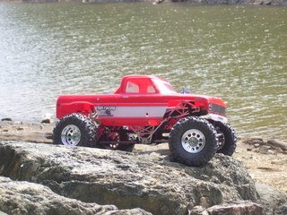

here is my WK crawler fresh from its first comp! can ya see the broken driveshaft on pic #4? oh yea gotta love it!"thumbsup"
. stock trans
. 2.2 maobs on stock wheels
. stock motor (waiting on usps wth my 45t!)
. streched to 12.5''
. JR radio gear

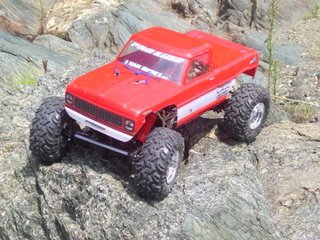

Well here's mine
motor - don't know what turn it is but it puts out 2.8 pounds of torque per square centimetre
pinion - 15t
spur - 96t
12.5 wheelbase
modified rims and tyres
evo 7 lancer body :lol:
