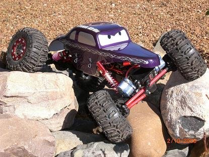

first hobby grade crawler mild mods
roughly 11.25 wb, custom aluminum driveshaft half, bbs in front, link mounts rotated 90 deg., ckrc wiggle servo on custom mount, rooster crawler

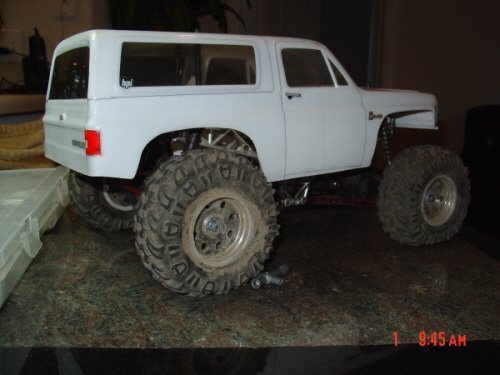

Stock Transmission, axles , shocks and electronics. Made the chassis with 12" wheelbase. Stock gearing.
For Monster Truckin...I just put on the stock WK tires and adjust the links and shocks.
For a scale ride...I use stock Tamiya Hi Lift wheels and tires.
Body size compared to original WK body
