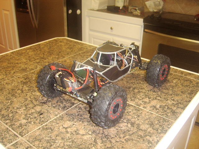

Here is mine.
Flipped chassis
12.5" wb
revo links
custom steering links
t-maxx driveshafts
2.2 moabs on axial black chrome beadlocks.
locked diffs
axle mounted high torque servo
55 t integy motor
15/96 gearing ( right now)
novak XRS esc
stock wk body trimmed
Custom tube chassis
12.5" WB
Custom front links/3link
Front DIG
9/72 32p gears
HPI spikes w/moabs
Hitec 645mg
Mamba max
3s lipo
HH crawlmaster 3014

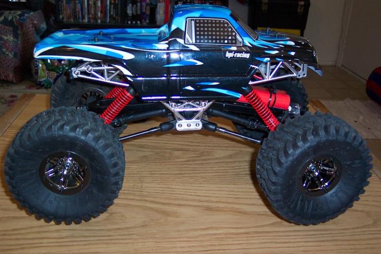

took it out for testing after build. few things will change on it now to this
gearing - 14/93
stretched to 12.5" wheelbase
60/40 links with hpi ball ends/440 thread
HPI WK aluminum shocks
holmes revolver 2
pheonix 25 esc
2-cell 2100 li-po battery
moab 2000 tires on narrowed hpi rims
Real nice action shot "thumbsup" well photographed
Stretched slightly (Trying to keep it "scale" looking)11.5 inch wheelbase.
Traxxas bottom links. Custom uppers.
Custom cut and fit EMax driveshafts
2.2 Moabs on stock wheels
Locked Diffs (Putty)
HItech 645mg with custom axle mount. With custom metal links.
Custom tranny skid plate.
Gearing: 96 tooth spur. Stock pinion.
Integy 55t
Moved battery case to front with rear aluminum esc mount.
52 chevy body.
