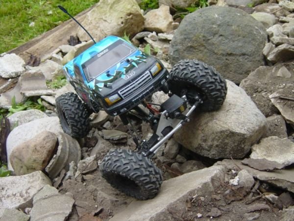

Truck Base : HPI Wheely King (Reversed Axles)
ESC: Novak Rooster Crawler Ed.
Radio: Traxxas TQ3
Motor(s): Ingety 55T
Servo(s): Hitech 5645
Trans: Wheely King 96/14 Gearing
Axles: Wheely King, CVD's
Tires: Pro Line Moab, Axial Beadlocks and rock Rings, Star Cut Foams
WB: 12.5"
Overall Width: 11.5"
Diff clearance: 1.5"
Center Chassis clearance: 2.6"
Overall height: 10.5"
Flipped chassis
Integy 50 turn V10
Traxxas Links 12.5" WB
Axle mounted Servo towerpro 995
Droop suspension / Savage Shocks
Locked axles
Mamba Maxx
narrowed pede wheels / moabs
new since this picture:
custom aluminum upper link mount, aluminum axle shock mount
nice rig, only limiting factor now is the original wk frame...

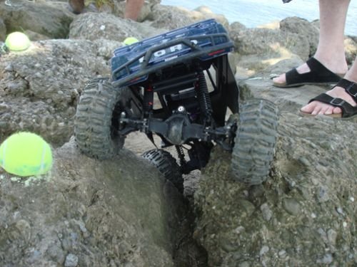

Here's my specs:
- Reversed chassis
- 12" wheelbase
- 60/40 gig with Savage shock bodies and springs in rear
- 15/90 gears
- Proline mashers on stock narrowed wheels
- Proline body
- TowerPro 945mg servo
- diffs locks, wheels weighted and all that usual stuff
Pic:

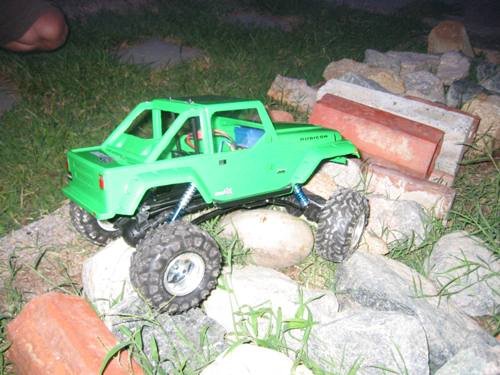

Here my first crawler
I built the e-maxx right after I was done with my wheely king thank Hpi and thank you RcCrawler for the great website
Latest WK shots
Here is one of my WK's on the rocks. I need to get more recent pics, as I have added a winch, axial beadlocks and rock lizards. I want to get a vid of winching my crawler straight up to the ceiling.
Specs:
WK axles with TCS lockers.
jwcustomwurks delrin chassis
delrin links
jpcustoms 110mm shocks
HiTec HS5645 servo
custom steering links
RC4WD R2 tranny v2
MOPED esc
TQ3 RX/TX with 3rd channel mod for winch, with 3way switch and adjustable trim thumb control (a must to keep winch centered)
custom servo and winch mount
Rubicon body - painted same as my 1:1
custom toolbox under hood (made from HiTec servo box, excellent for storage of must need items on the trail)
Not pictured:
Axial beadlocks and rock lizards
MG995 winch servo with 100lb spiderwire and 12" steel lead.

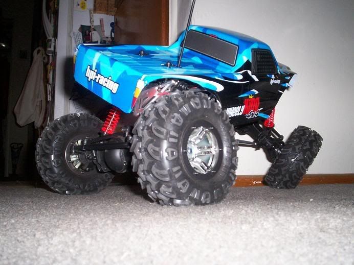

STRETCHED WHEELY KING 11.5"
TRAXXAS LINKS
STOCK CHASSSIS
STOCK SHOCKS
STOCK ELECTRICS
STOCK WHEELS WITH CUSTOM WEIGHTS
BEADLOCKS WITH PROLINE MOABS WEIGHTED
CUSTOME WEIGHTS ON FRONT BUBMPER

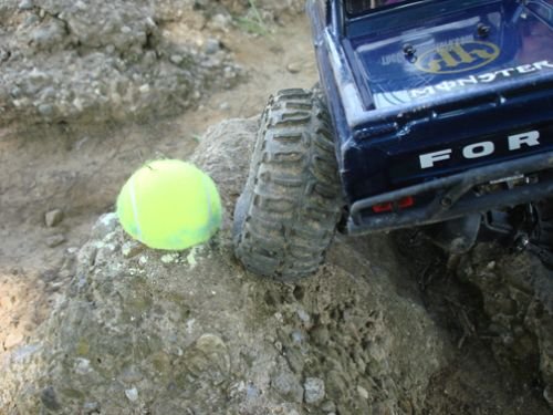

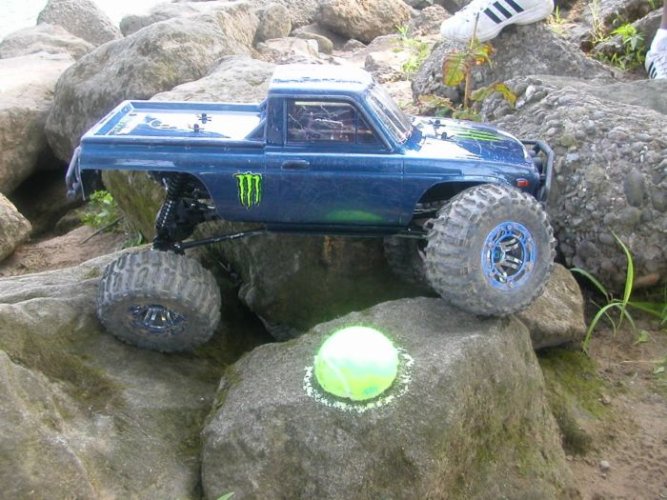

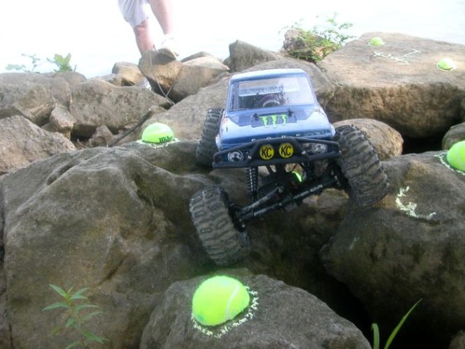

the comp WK
this is my normal player & comp rig. I well tell u. the best thing i did was a belly tuck :shock: mamba-crawlmaster - 1/2" links all 8.
