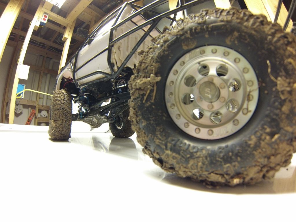

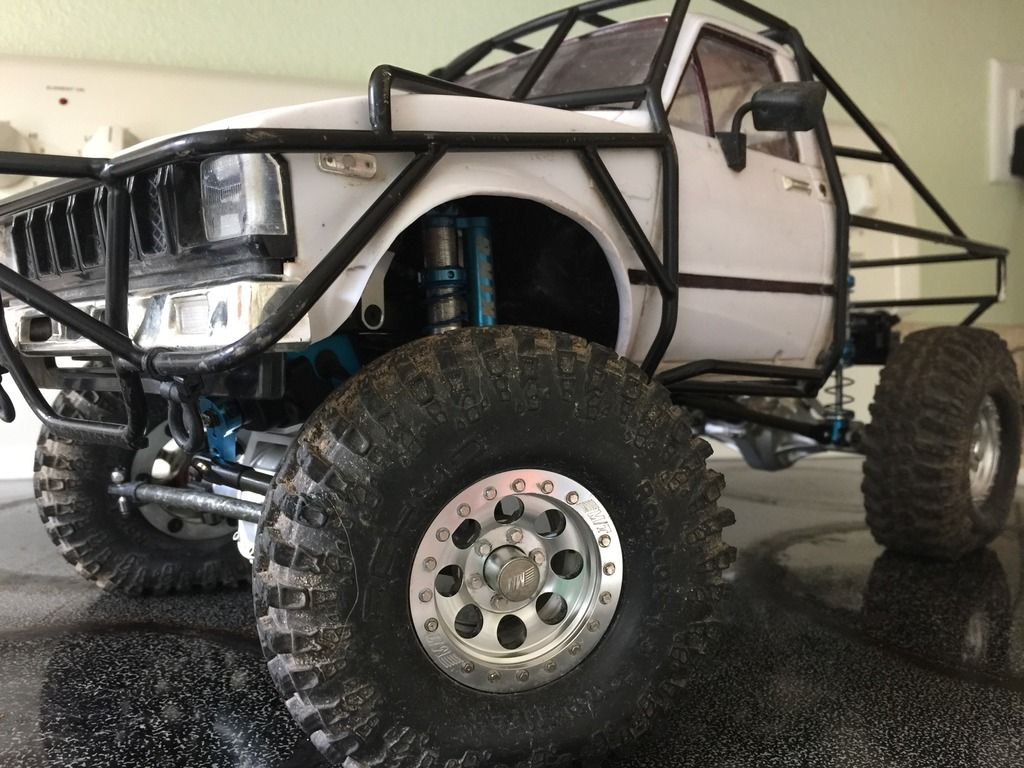

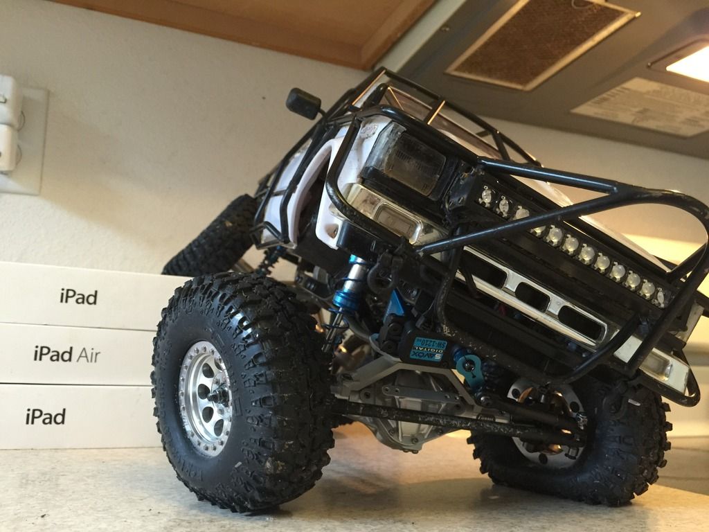

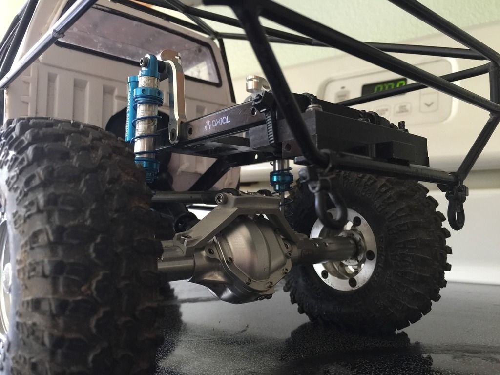

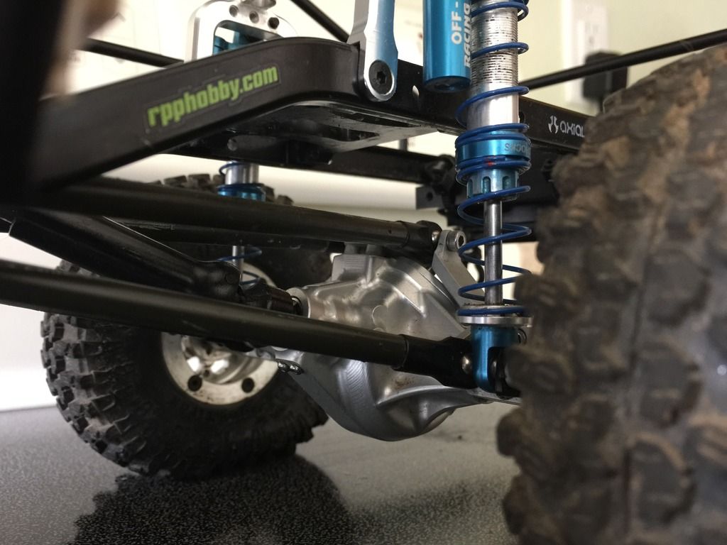

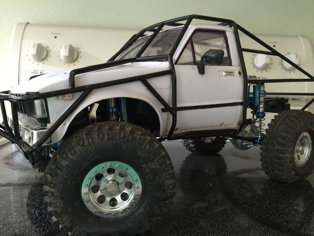

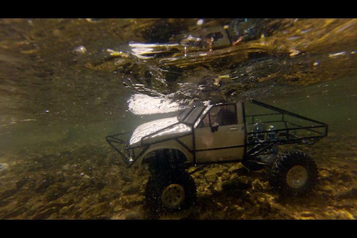

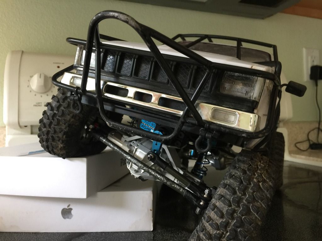

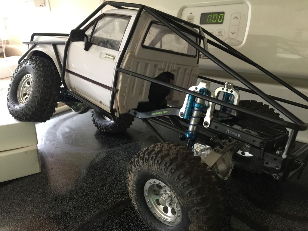

I wanted to create something unique and meet these needs:
1) Money no object. wanted some bling, but overall want the best quality parts and performance

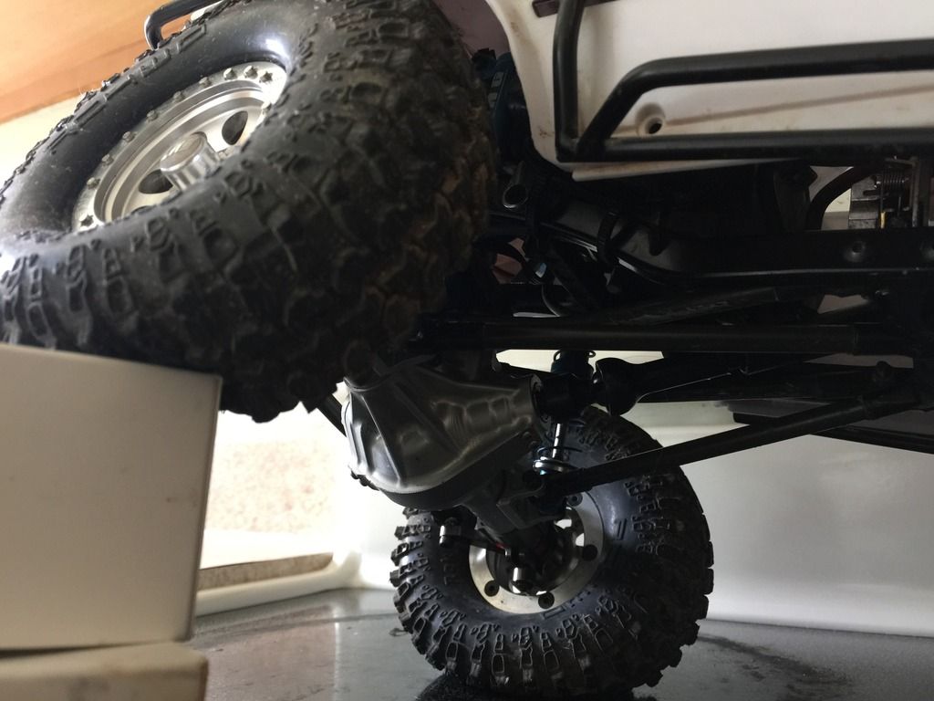

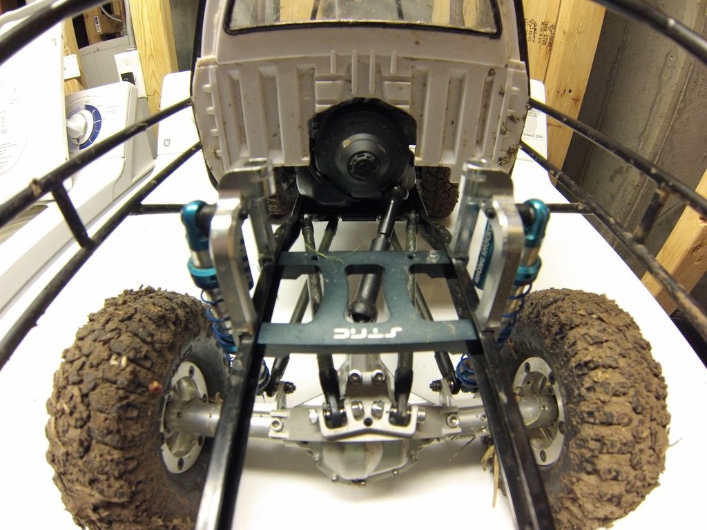

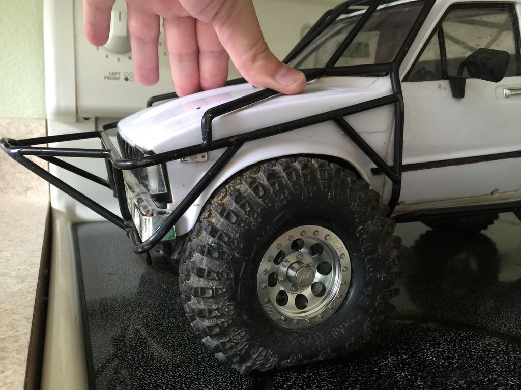

2) Parts had to work well together for articulation! Which meant, no leaf springs, good shocks at 110 mm, no bed, cutting of the hard body for increased articulation and cutting of the RC4WD tube chassis. The rig had to flex and grip rocks, just wanted a good performing SCX10 platform
3) Had to be a Toyota Hard body (truggy in my case)
4) Wanted a scale look but no compromise on performance!

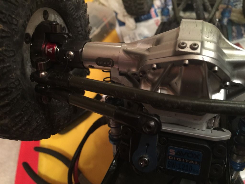

5) Axle mounted servo for better performance vs. a vanquish 3 link where I had multiple problems with articulation. Wanted performance over scale so went axle mounted servo

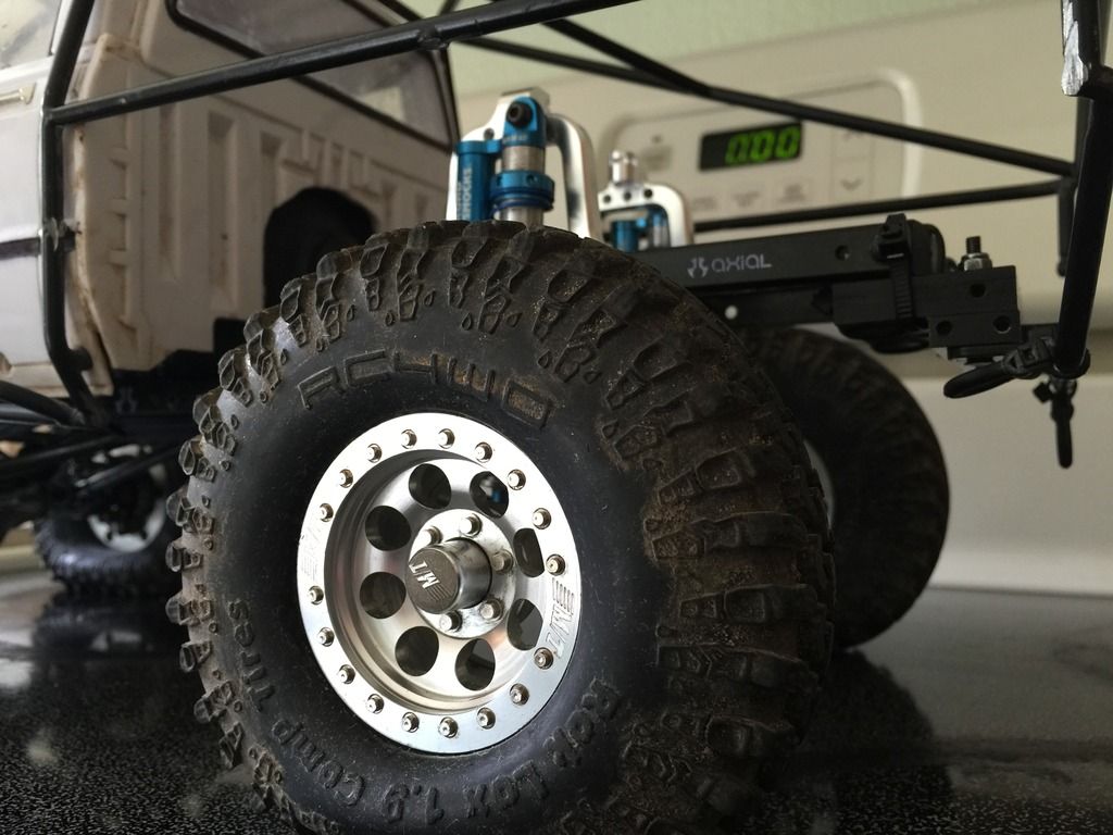

6) Had to be a Class 1 crawler which meant using 1.9 Tires, etc ... tires not wider than 1/2 the wheel wells, tube chassis bumper not widerthan windshield, etc.
7) Had to have the best electronics (no need for 7.4 volt servo) 6 Volts with enough torque was sufficient in my case
<?xml:namespace prefix = "v" ns = "urn:schemas-microsoft-com:vml" /><v:shapetype id=_x0000_t75 stroked="f" filled="f" path="m@4@5l@4@11@9@11@9@5xe" oreferrelative="t" o:spt="75" coordsize="21600,21600"><v:stroke joinstyle="miter"></v:stroke><v:formulas><v:f eqn="if lineDrawn pixelLineWidth 0"></v:f><v:f eqn="sum @0 1 0"></v:f><v:f eqn="sum 0 0 @1"></v:f><v:f eqn="prod @2 1 2"></v:f><v:f eqn="prod @3 21600 pixelWidth"></v:f><v:f eqn="prod @3 21600 pixelHeight"></v:f><v:f eqn="sum @0 0 1"></v:f><v:f eqn="prod @6 1 2"></v:f><v:f eqn="prod @7 21600 pixelWidth"></v:f><v:f eqn="sum @8 21600 0"></v:f><v:f eqn="prod @7 21600 pixelHeight"></v:f><v:f eqn="sum @10 21600 0"></v:f></v:formulas><vath o:connecttype="rect" gradientshapeok="t" o:extrusionok="f"></vath><?xml:namespace prefix = "o" ns = "urn:schemas-microsoft-comfficeffice" /><o:lock aspectratio="t" v:ext="edit"></o:lock></v:shapetype><v:shape id=Picture_x0020_1 style="HEIGHT: 11.25pt; WIDTH: 11.25pt; VISIBILITY: visible; mso-wrap-style: square" type="#_x0000_t75" alt="http://www.rccrawler.com/forum/images/smilies/icon_cool.gif" o:spid="_x0000_i1025"><v:imagedata o:title="icon_cool" src="file:///C:\Users\Tim\AppData\Local\Temp\msohtmlclip1\01\clip_image001.gif"></v:imagedata></v:shape>100% water proof (lots and lots of plasti dipping), wanted to never worry where this rig goes. wanted to create the best underwater crawling gopro video youtube has ever seen. still worling on that though lol
9) Had to run an awesome modified tube cage to protect hard body
10) No shelf queen!, this baby is meant to be used and abused and left dirty at the end of the day, no exception
11) wanted to finally run some $130 rims with 1.9 tires. I love scale rims.

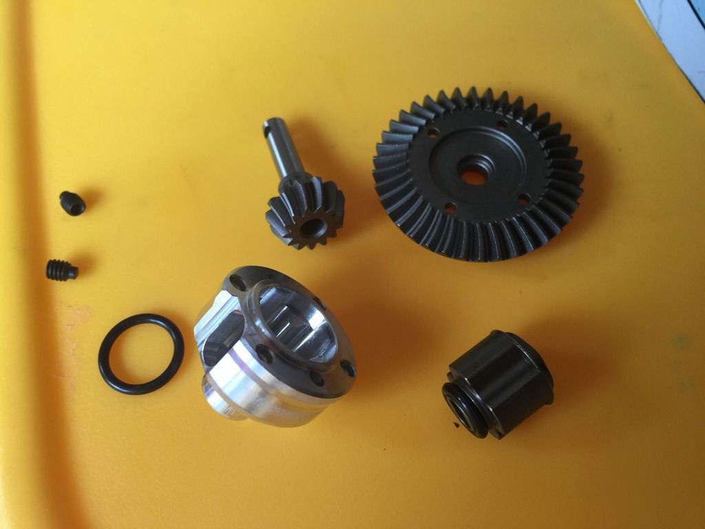

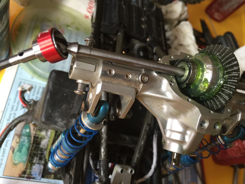

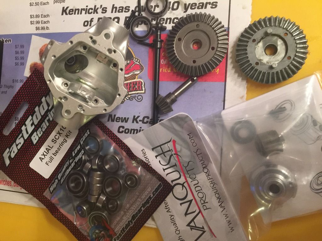

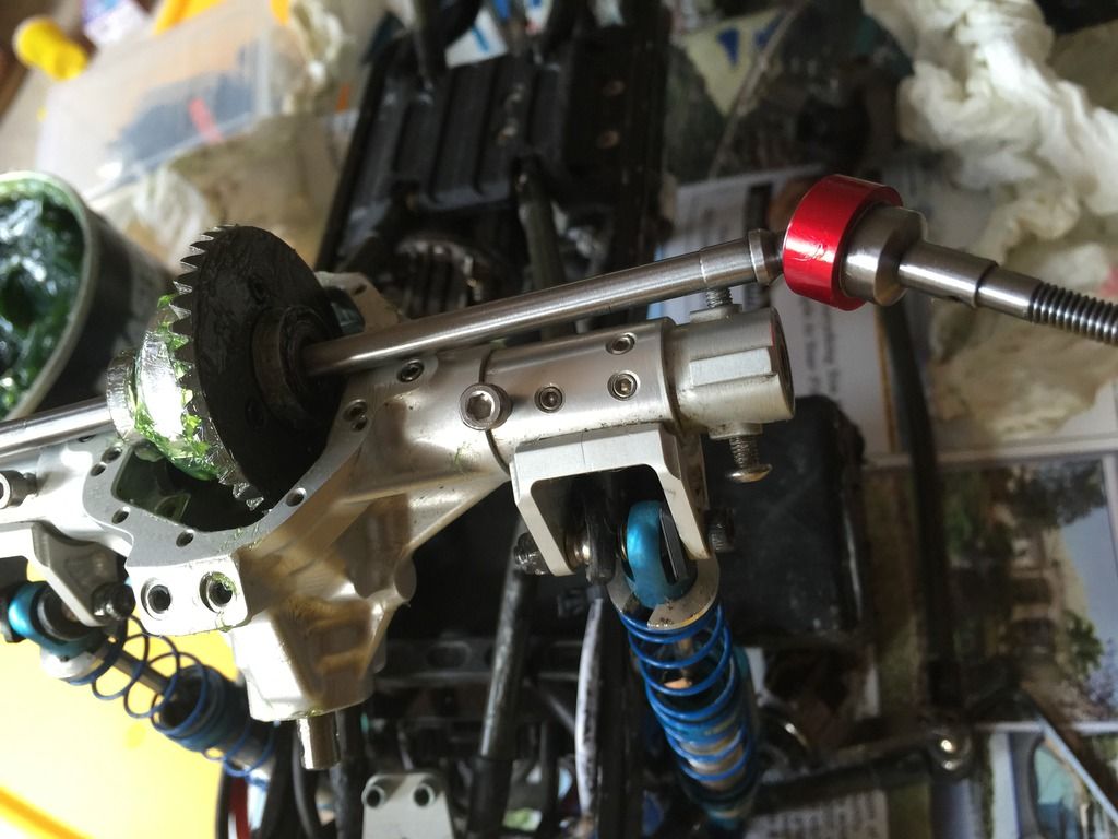

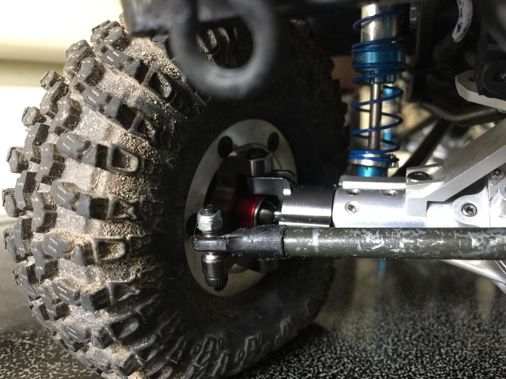

12) Truck had to have lots of weight down low, so went with the heavy vanquish Currie axles. The internals are using the heavy HD bevel gears and diff lockers for both front and back, truck weighs in at 14 lbs, wow!
13) wanted to under-drive the rear gears for better performance, lots of information on this, wow, what a difference!
14) and just have fun with my scale build and keep it original to my own ideas on how I like things.
Here's the parts I used:
SCX10 Kit Ebay New (no wheels, no electronics $179.00
TLR Silicone Shock Oil 20 wt x 2 $7.99
Gearhead RC Scale Trail Torch LED Light Bar White and Blue waterproof $57.99
RC4WD Mickey Thompson Classic Lock 1.9" Internal Beadlock Wheel $129.99
RC4WD Complete Mojave Body Set $109.99
RC4WD Mojave Bench Seat $8.99
TorqueMaster Pro $64.99

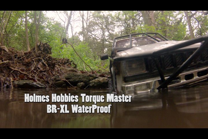

Holmes Hobbies TorqueMaster BR-XL WaterProof $109.99
Castle Creations Castle Link Programming Kit $24.99
RC4WD Rok Lox 1.9 Comp Tires (2) $24.99
RC4WD Hilux and Mojave Tube Exocage for Trail Finder and Bruiser $149.99
King Off-Road Scale Piggyback Shocks w/Faux Reservoir (100mm) (2) $46.99
Savox SW-1210SG Waterproof Coreless Steel Gear Digital Servo $94.99
56 pitch 13 tooth pinion gear $4.99
Deans plugs and 12 guage wire $7.99
Aluminum Racing Servo Horn $10.99
4 Link suspension (10 Links) $89.99
Spektrum DX4C DSMR 4-Channel Radio w/ SRS4210 waterproof RX $139.99
LiPo 5450 3-cell 11.1v Battery Pack $65.99
VANQUISH Currie Front SCX-10 AX-10 Axle Silver $169.00
VANQUISH Currie Rear SCX-10 AX-10 Axle Rear $150.00
Steel MIP Drive Shafts (Black) $54.99
Vanquish Products Axial Alum Trans Housing (Silver) $50.00
STRC STEER KNUCKLES SCX10 (2) Gun Metal $20.00
STRC ALUM HUB CARRIERS SCX10 (2) Gun Metal $20.00
Robinson Racing Hard Steel Idler Gear AX10/SCX10 $12.99
STRC ALUM. REAR SHOCK TOWER (1 PAIR) SCX10 Silver $17.99
Robinson Racing Hardened Aluminum Diff Gear: AX10/SX10 $15.00
King Shocks Spring Kit RC4WD $8.00
RC4WD Rubber Mirrors $8.00
STRC Aluminum Chassis H Brace SCX10 (Black) $10.49
Plastidip (Home Depot) To waterproof all Electonics + lipo $5.99
Wheel Bearing Water Proof Grease for repacking all Bearings $5.49
RC4WD Light Kit $17.99
STRC ALUM. REAR SHOCK TOWER (1 PAIR) SCX10 (Silver) $16.99
Team Fast Eddy Axial SCX-10 Bearing Kit $19.99
Vanquish Products SCX10 VVD V1-HD 4mm Stubs $64.99
Rear Vanquish Products Locker for Axial Wraith & Yeti AX-10 type axles $33.99
Front Vanquish Products Locker for Axial Wraith & Yeti AX-10 type axles $33.99
Axial HEAVY DUTY BEVEL GEAR SET 43T/13T (used for Rear under-drive) $23.69
Axial HEAVY DUTY BEVEL GEAR SET 38T/13T (used for front) $23.69
Total Cost: $2,186.06<o></o>
