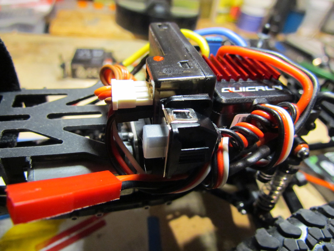

This is what mine currently looks like under the body...
How do you like the 1625? I was thinking about picking one up, but wasn't sure if it had a F/R driving mode or if it was only F/B/R. I'm happy enough with how my rig runs with the 1060 that I'll probably leave it like this for a while. If I do upgrade, I'm thinking the micro brushed/brushless esc from dinkyrc might be a good way to go.
I did rearrange things in mine, now the ESC and RX are mounted low and forward where I had the battery before, and a smaller 400mah battery on the rear tray. In this configuration my weight distribution is improved to 58/42 and cg is lower. Handling is noticeably improved, I'm pretty stoked about how dialed in this thing is right now.
The 1060 imo is a better choice over the 1625. The 1625 only has fwd/ rev/ brake.. no other options. I do like it over the original AE6 regarding a smoother throttle response and no glitching ( mine glitched anyway) but not a huge improvement from stock. Works for me although I would've gone with the 1060 if I had put some more thought into it at the time. Btw.. Really like the look of your rig!
Thanks! I'm just starting the process of cutting up an Associated 1/28 short course truck body to make panels for the cage, which is from a $20 walmart rc car. Imagine like a twin hammers desert truck combined with a proline cliffhanger. Not sure yet if I'm going to continue with the red and black snakeskin thing, or go a completely different direction.
