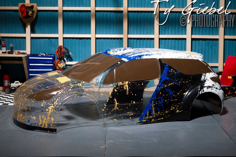

I did a little step by step of the painting for this body. Besides bloching the decals in a few spots it turn out alright. I love the body though!

really nice and original paint scheme on your DS3 Tyler! Good work!
"thumbsup"
p.s. About decal webbing ... did you use water with detergent when placing decals on body please? Vinyl we are using is more elastic then common commercial decals. The advantage is it can perfectly copy the surface of the body especially on complicated shapes. On the other side ... when you stick it not exactly on place or with bubbles, you can't take it back or move without deforming decal itself. It's the reason we reccomend soap water and do not hurry with placing decals. Soft towel for removing water from under decal is good tool. You can use sharp needle or knife to eliminate bubbles on larger decals too.

Its good to see you on here Michal. I was just going to email you.
Yeah decal work is all on me. I was way to excited to take my time and paid for it when it came to a couple of the decals. It's great that you posted here though, so everyone can learn what not to do with the decals from me. :ror: And know what to do from the master himself.
The next one I get from you I plan to take my time and breath deep. :ror: I hope you check in with us and share some of what is going with your crew and help this amazing thing called rally grow throughout the U.S.
