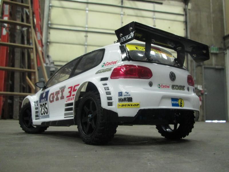

Here is a pic of my XV-01 with my VW body "thumbsup"

BasicMods - Looks good. I don't think it needed the hacking Turtle was doing. Looks like that shovel at the front would clear away a lot of dirt on landings :lmao:
