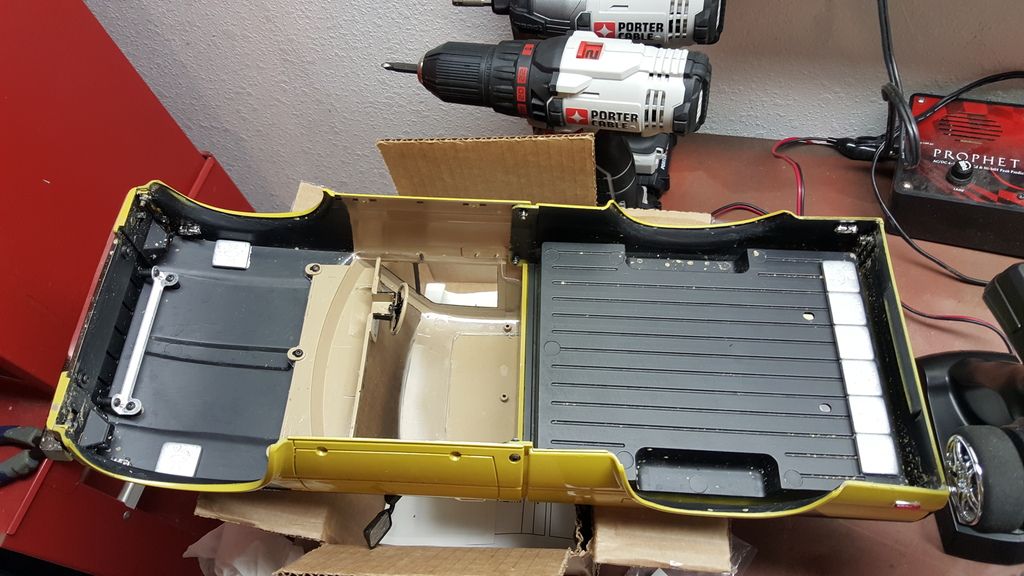

I put some stick on wheel weights on the bottom side of the body to help balance things out since its a bit front heavy.
