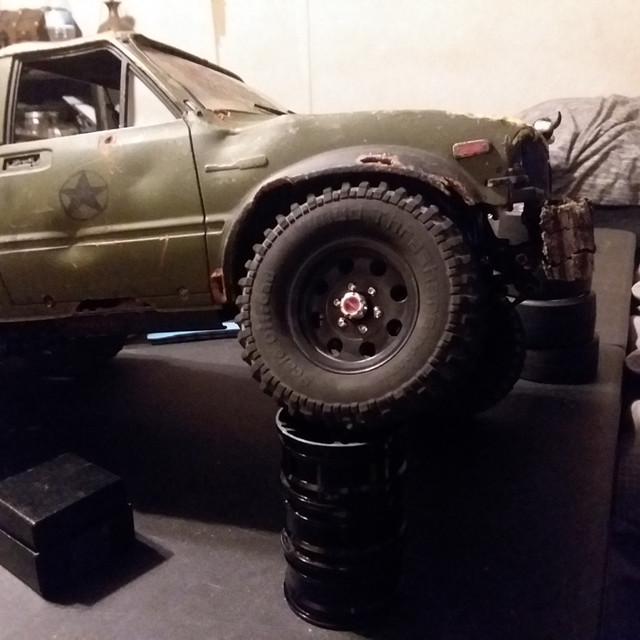

So without further ado, I did the axle flip, and couldn't be happier! Truck now looks proportionate with tiny tires, and the tire tuck is sexy!
An added bonus? Doing the axle flip and mounting the springs under (can be done without the RC4WD leaf under kit), let me put the exhaust back on.
The biggest plus? It just looks right! I lost a little articulation, but that's ok because I gain a lower CG and the steering is way better. Articulation is still over 3 inches all the way around. Plus, it'll now be less likely to flip. The old, cut Mud Thrashers do amazing out in the wild, but being glued to touring car wheels only lasts so long. So I took the foams out of them cause they give fantastic bite, and put them into the newer, uncut Mud Thrashers, and put them back on the beadlocks I have, because they really complete the look of the truck. I'll probably do the same cut to these at a later date. The beadlocks also give a slightly wider track width.

It sure does look good with the body lowered! Looks great and it will definitely handle a whole lot better! Sexy she is!! (whistle! whistle!):)
I've always been a big fan of running my rigs as low as possible to help lower the COG. It sure does help when out on the steeper rocks!

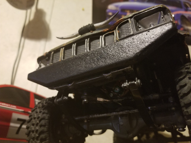

Its now an issue with approach angle. I should be able to design and print a new front bumper to fit the truck though, and make it fit the theme as well.
Took some inspiration from High Plains Drifter's fabricated front bumper to design a 3D printed bumper. After the axle flip, the organic bumper hinders approach angle quite a bit. Went a bit too heavy on the Plastidip trying to cover up a few gaps in the print lines, but that actually made it fit the theme of the truck, so I'm ok with it.
Red one was the first design, blue is the second revision.

Thanks man! And for sure thank you for getting those measurements for me; It made it alot less work to design!

The 3D printed bumper and mount performed EXTREMELY well. Barely was an issue with approach angle at all. It would catch on the sides in certain areas, but other than that it's a large improvement all around.

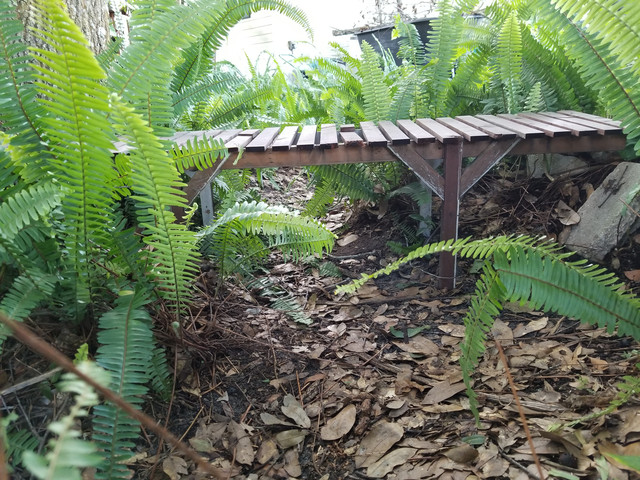

Been itching to add to the crawler garden trails, and really wanted to do a wooden bridge. So I got together some old hardwood moldings and some cedar flooring pieces and got to work.
Freshly built
After 5 black washes
I'll be doing some more work adding some large rocks I picked up from someone who was moving out of their house. I plan to have the other side of the bridge go back onto some rocks, and add a new section to the trails.

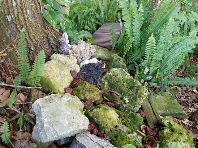

Places I used to get caught up on the rocks in the crawler garden I no longer get hung up on,

Finally got some decent pics of the crawler garden. Posted in order so you can perhaps get a feel for the rocky section. The rest of it is just trails through the ferns and plants for now. I did add a bunch of orange LED lights from the Halloween clearance stuff. I think it came out pretty cool, but the pics are so washed out in orange you can't really tell what it looks like in person. It's not that orange lol.
