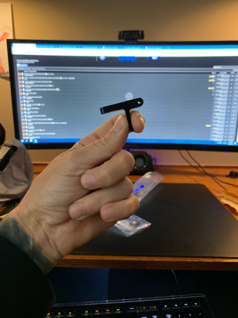

I ordered 2 just because I was so happy to have a fix for 9.99. Finally something that is not BUBBLEGUM soft metal!
THANK YOU LOCKED UP RC if you read this.
Look what I got! Hell yes! Finally I can drive my TF2 without fear of bending it!
Thank you locked up! Thank you!!!

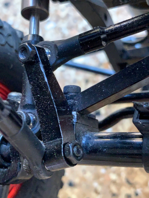

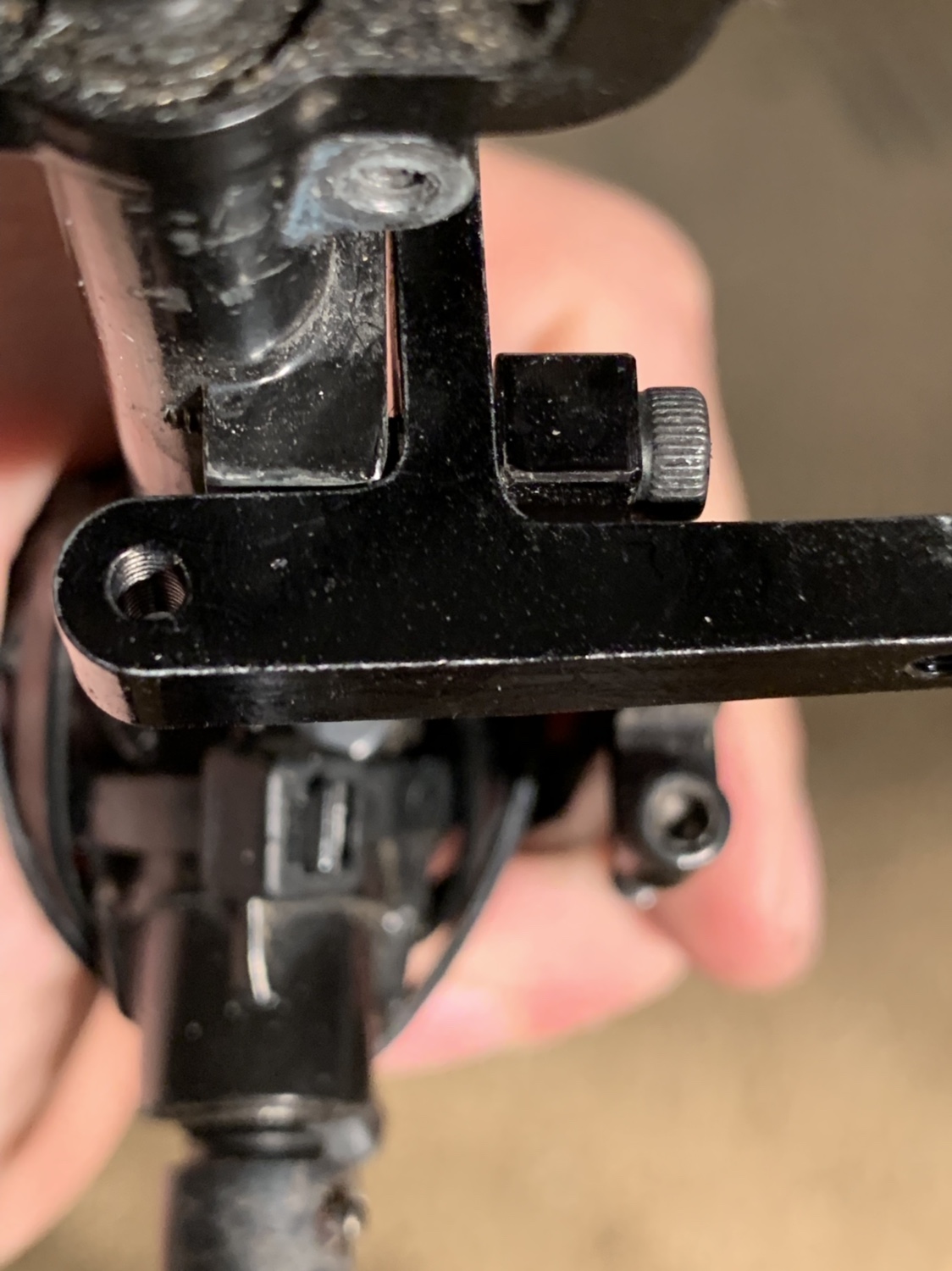

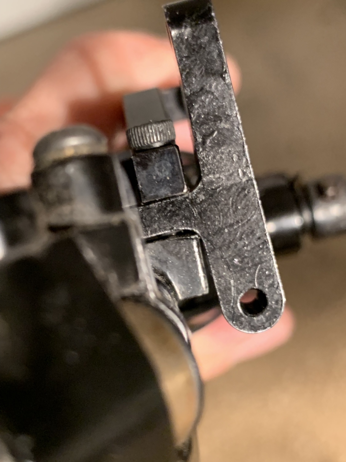

Installed! Mine did not sit flush with the K44 axles. I had to dremel the inner corner of the mount where it makes a 90% corner. Not a big deal. This is a solid not going to bend piece!
Very happy.
After the dremel. And I only nicked the inside corner of the mount for a second.
