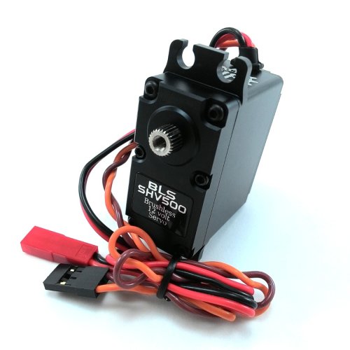

I am proud to announce the SHV500 servo, a concept I have been working on for the past year! It was a personal project for my own rigs, like most products I develop. I redesigned the motor and changed the drive electronics for rock solid use with 3s lipo power. No BEC needed, just straight battery power! After proving the concept and getting a nice performance boost, we decided to take the jump and offer it for sale. This was only possible because of the support our customers give us, so thank you all! Here is the details from my site:
The BLS SHV500 servo is designed for R/C Rock Crawlers, but at home in any vehicle. It is powered directly from a 3s lipo, eliminating the need for an external BEC! Clean up your wiring, gain space in a tight rig, and enjoy near silent performance with the upgraded brushless motor and circuitry.
FEATURES:
Water-Resistant Alloy Case
O-Ring Seals
All Metal Gears
Brushless Super High Voltage motor
Upgraded N38EH 200c rated magnets
24cm servo lead
24cm 12v power lead with JST plug
3s Lipo compatible (16v max)
1 Year Warranty
SPECIFICATIONS:
Weight: 73g
Dimensions: 41x20x40mm
Spline: 25 tooth (Futaba type) M3 threaded
Torque @ 11.1v: 32.4 kg/cm (450 oz/inch)
Speed @ 11.1v: 0.10 sec
Torque @ 14v: 37.5 kg/cm (520 oz/inch)
Speed @ 14v: 0.08 sec

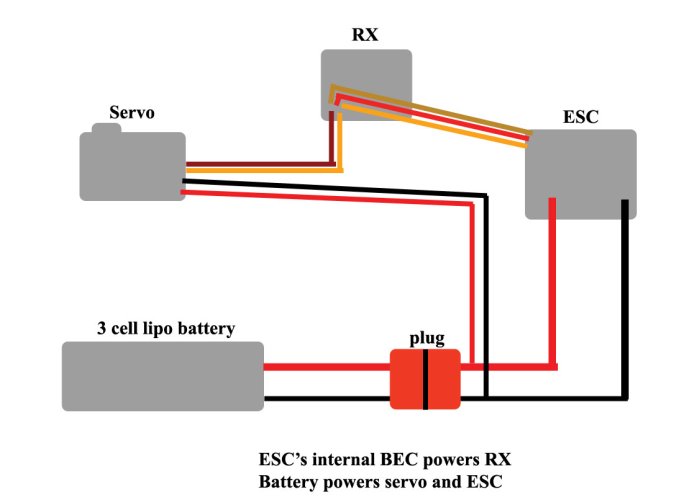

I was about to place an order for a HV500. How does this connect to the power source? Do I run a pigtail off the ESC or run a separate 3s battery. The rig it will be used in will be only run on 3s.
Crude drawing I made, but hopefully it gets the idea across. I should probably spend some time in CAD to make good looking ones.
The servo has a JST female plug on it, and we are supplying the male pigtail with it. So wire in the JST male pigtail into your deans plug like a normal BEC would, and plug the servo into it. Or folks can hardwire it in to get rid of a plug.

Thanks John. I like the idea of no BEC.
