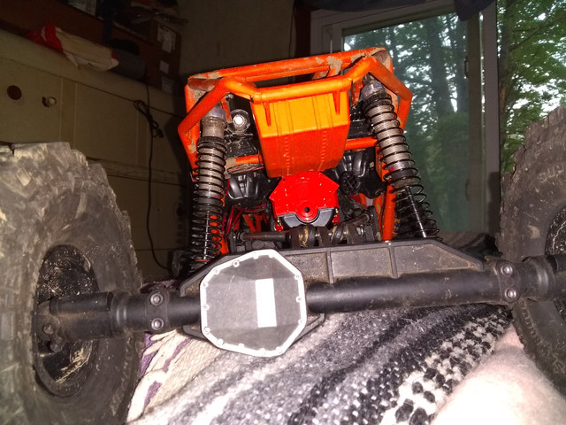

Power Plant is almost done and in place. I need to paint it and add the headers, and timing chain cover to it. seal it to the cover a bit better, then add some finishing details like plug wires, some hoses. maybe a Radiator........
Color added to the engine and getting ready for plug wires etc. Need to paint the carb area yet. May add some fuel lines, maybe try to make some hoses at some point. Also mounted the headers. May try to make a couple dual exhaust pipes to fit in, but this will probably be good enough for who its for.
Plug wires in place. Still need to add a little color to them and glue them into place permanently, then it will be ready to go back into the Ryft.
I agree nice work. SSD motor?
Yes. The SSD TK kit motor (same as they sell alone).
Its a tight fit, upper link on one side rubs the header as it compresses fully, but not too bad, it just pushes it out of the way a little bit. May heat the header section and get it to bend out just a bit to clear the link better.

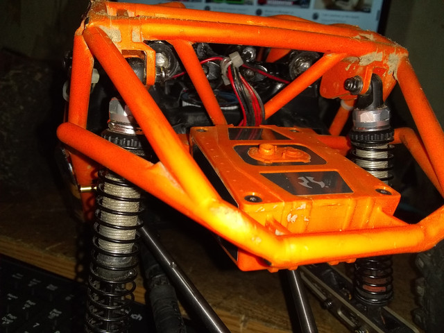

I'm going to assume/guess my Ryft isn't the only one with a considerable amount of slop in the steering. I know several pointed this out when using the kit servo saver. Most of it appears to get corrected by using the Losi LMT servo saver. Well...I tried the (updated) HR LMT servo saver...which, I'll admit, is defiantly better then the kit servo saver. However, it still had way too much slop. I did replace it with the Losi LMT servo saver, and that got rid of most (but not all) of it. So...I decided to install a make-shift "steering stabilizer.
What you see is over of the unused (front) kit shocks, with the spring, spring retainer, and preload ring removed, and the cap's 'wide' ball replaced with a 'narrow' ball off the bottom of one of the other shocks. I filled it with 5000wt diff fluid, and then attached it to the servo saver (on top of the steering arm, using a longer 25mm screw) & left steering knuckle.
End result: ALL but approx 0.5mm (at the wheels) of slop removed. "Thanks" go to Joe (of Exocaged on YouTube) for giving me the idea.
EDIT: For those curious about the alignment of the "stabilizer" shaft to the steering link, they are about as perfectly aligned (before the links left-side bend) as anything possibly could be. Also, if anyone wonders if the "stabilizer" shock hits the pumpkin, the answer is "yes"...but, just barely, and ONLY at the exact moment the steering is at full-right. So, it doesn't interfere at all with the steering. Plus, the area of the shock that (again, barely) makes contact with the pumpkin is the plastic piece at the bottom of the shock body...thus, neither the shock, nor the blue anodizing, would sustain any "damage".
