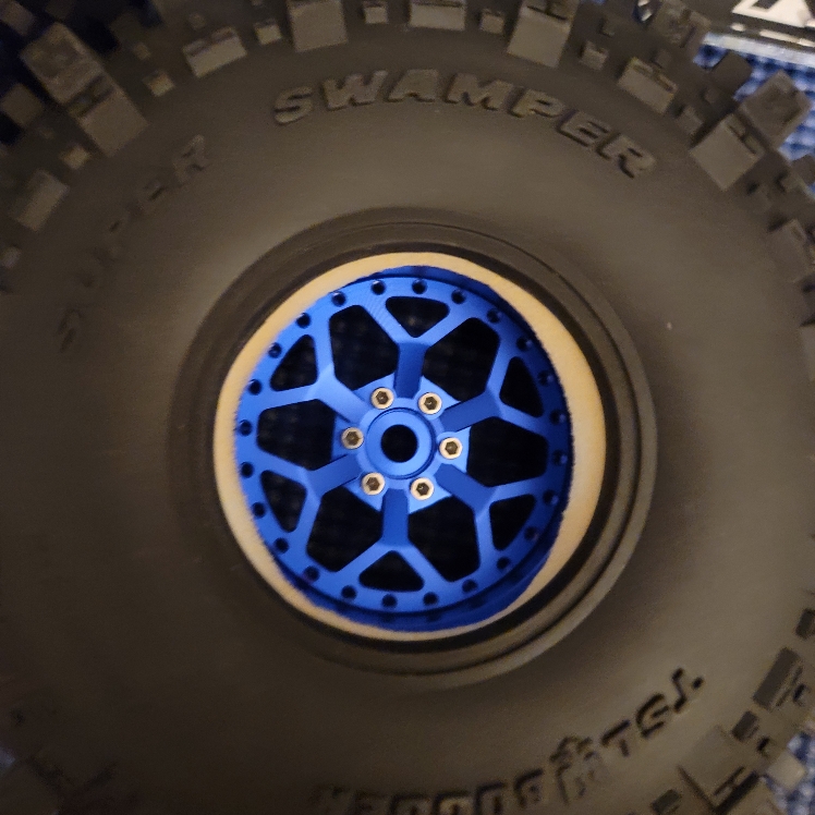

Well I got the stock tires to work on the SSD wheels. I put in some Proline dual stage foams and used a couple longer screws to start everything and tightened them down with fingers crossed. Everything looks to be ok. See my other post in here for my build.
Weird you couldn’t get them to mount first time round, there’s nothing obvious stopping them mounting up
Yeah the only thing I can think of is the stock foam that comes with them was getting stuck between the tire bead and wheel. With the closed cell foam of the prolines there wasn't anything getting stuck there.
I know exactly what you mean. When the stock foams are used on a plastic 1-piece wheel, such as those included in the kit, there's no problem, as the tire is contained entirely within the confines of the wheel, thus the foams are also contained within the wheel. However, as can be seen below, when using beadlock wheels, the stock foams (which are single-stage open-cell) "roll" outside both sides of the capture ring, preventing the tires from properly positioning.
Looks like dual-stage foams are going to be the ONLY solution. Normally, I stick with the CI foams, but I'm willing to give the Pro-Line ones a try (partly because I've been wanting to give them a try, and partly because the CI foams are incredibly difficult to find right now).
For those wondering what wheels these are, they're from Vitavon...and, they are TRUE beadlock wheels. In other words, the beadlock rings are NOT just some decorative feature that you can change with the tires still installed on the wheels - the beadlock rings are integral to holding the tires onto the wheels, just like 1:1 beadlock wheels.

Regarding the stock tire foams, as mentioned in my previous post, the dual-stage foams arrived yesterday. I've only put together one wheel/tire, but I had no problems...none. The only 'problem' (albeit, an incredibly minor one, and common to ALL beadlock wheels) was properly aligning the tire, outer foam, inner foam, inner ring, etc, to "perfect alignment".
With these Vitavon wheels ..again, TRUE beadlock wheels...I did have to do something I've never had to do before - use longer screws to get things started. Not only did I have to use longer screws, but I had to use two different lengths of longer screws. First, I started with 3 evenly-spaced 16mm screws, tightening them until they couldn't be tightened any further (the design of the wheel limits the meconium depth screws can be screwed in). Next, I used 3 evenly-spaced 12mm screws (spaced evenly between the 16mm screws), tightening them most of the way. This left an estimated 6mm between the beadlock ring & wheel. Finally, I added 6 of the intended 8mm screws, one of each side of the 16mm screws, and then removed the 16mm screws. Once all other holes were filled with screws (ok, get your minds out of the gutter...lol), then I removed th 12mm screws, replacing them with the 8mm screws, and then proceeded to tighten all screws in the usual rotate-screw-rotate-screw process. Alright...now my mind is in the gutter. Anyway, the first wheel/tire is done. The other three will have to wait until tomorrow...time to get ready for work. But, here's what they'll all look like.

On the beadlocks. They are, indeed, a work of art ( and should be, for that price) but there’s a reason that a lazy bum like me prefers just to glue tyres..:lmao:
