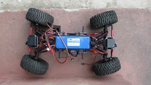

I ordered a steering servo mount kit (VEN-8371) and a steering linkage set (VEN-8361RE) so that I could set up rear steer on my Creeper.
My question: how do I mount these onto the truck? The steering servo mount kit didn't come with any screws, and the linkage set didn't come with any pivot balls to put inside of the rod ends, nor the longer screw required for installation.
So, what's going on, Venom? Where's my hardware:?:
i got servo mount kit with only one (of 3 needed) 6x6 spacer. To mount it you need 3x 6x6 spacer and one 2x6 spacer.
I have bought some screws from hardware store, coz i was missing some during building, so i have all of them in case of (20x of almost every kind, so i paid 30eur)
regarding linkage and missing pivots, no those are not missing at all. You need to to remove rear links and then you can use those pivots. You don't even need to assemble that shorter link, coz you can use the existing one. Same for longer screw.
