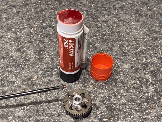

Aluminum locker showed up today, so time for some more assembly…Again. :ror:
Don’t forget your red Loctite!

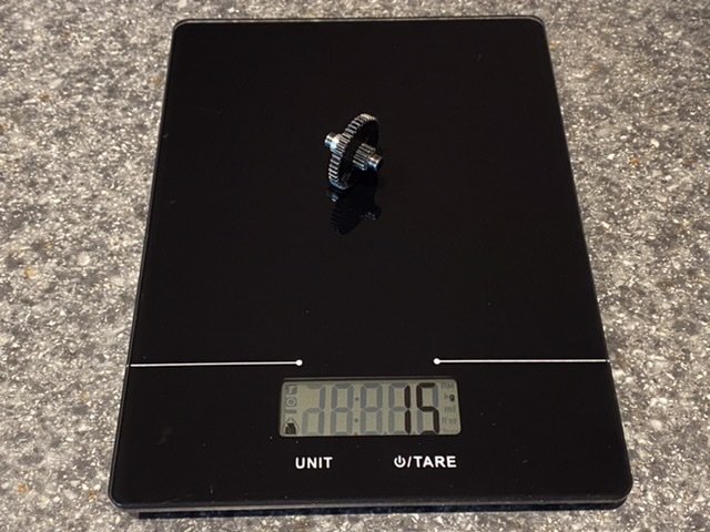

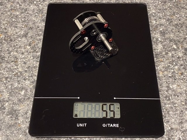

Lost 9g going from G10 to CF and a Ti shaft already, here is another 15g…
Not that I am looking for an ultralight rig especially with these chunky aluminum axles, just shedding some un-needed weight…

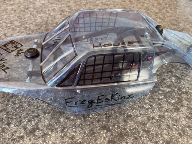

Playing around with some body mounting options. I made these 3/16” 7075 spacer mounts a few years ago.
Not really a fan of them being on the shock mounting holes permanently for tuning reasons,
but I may run them for now since they line up perfectly with an old pre-cut body…

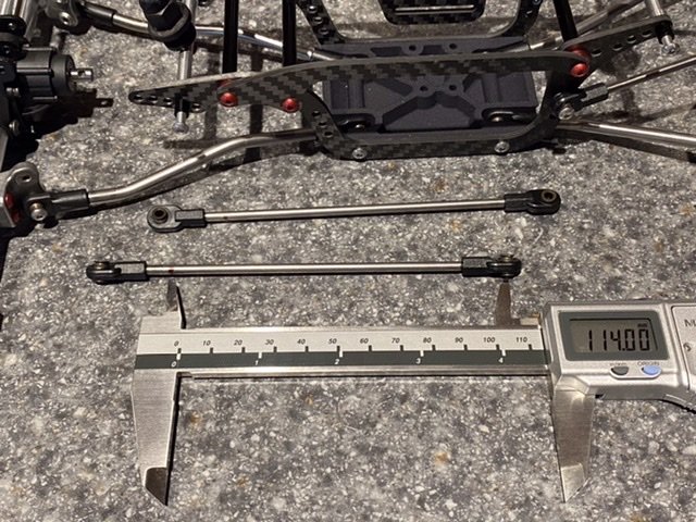

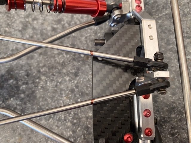

Looking like 114mm is about the right length for the rear uppers on these axles, so a 100mm bare rod.
119mm eye to eye (105mm rod) seems good for the front uppers.
Still haven’t found my 5-40 die so I guess I need to order another one…
I will give that a shot, thanks. "thumbsup"

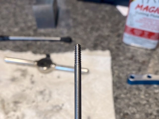

I don’t have a lot of experience with making my own links with the 1/8”
material, as I have always used 3/16” G5 Ti or 7075 Al in the past.
Found the 5-40 die, but ended up using the 6-32 with good results, thanks. "thumbsup"

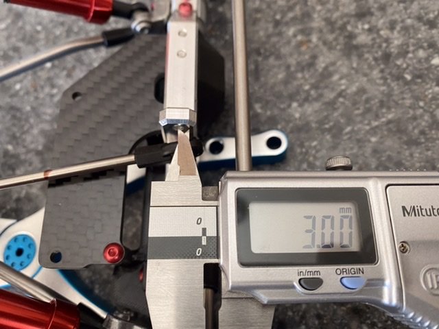

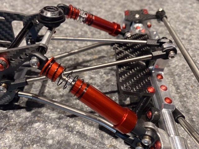

But now the front uppers are too long… :x
To cut down or to bend… Or both. :???:

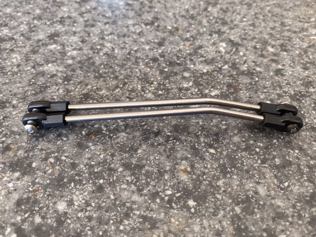

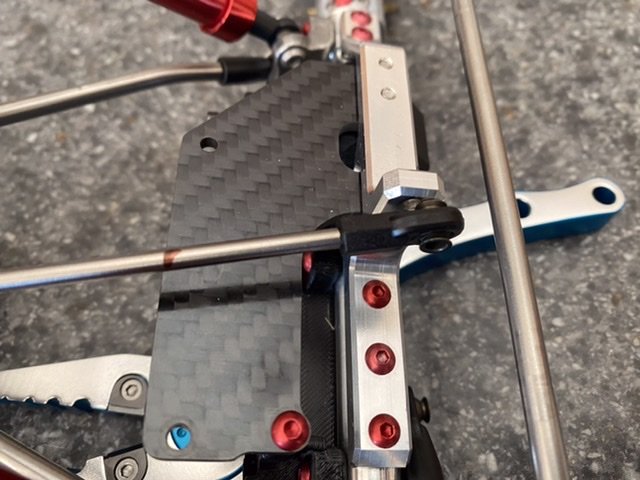

Decided to put a bend in the front upper links first then shorten them if they need it after that.
You can see here that they hit the servo mount under compression and I need them about 3mm shorter to get the front angle that I am going for.

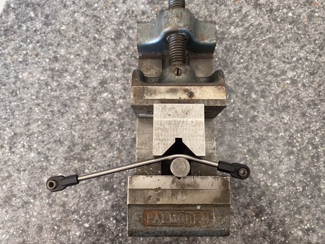

There are a lot of ways to bend links, and these 1/8” rods could probably be done by hand, but I like them to be a bit more consistent than that.
This seems to have done the trick for now…
