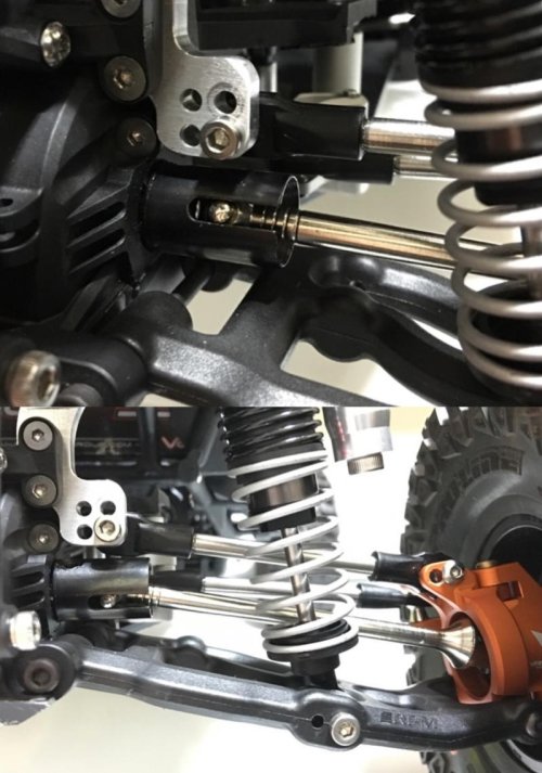

Three full 5000mah packs so far and ZERO pin movement. The whole design is beefier but still works with the Axial Yeti locker and Vanquish or stock style knuckles and caster blocks. I need to update my build thread but I can post a quick pic here if you want.
Everything about the VP and Incision VVDs are identical just different materials. The design and tolerances are the same so it makes sense the reliability issues are shared as well. Shame really.

It's kind of difficult to tell in the pics but the pins, dogbones, shafts, and drive cups are all significantly larger than anything else available with this type of design. These work with the Yeti locker but replace the two included outputs with Ti pins and larger outputs to accept the much larger dogbone end on DLux's universal. The uni stub shaft is an Axial stub shaft so it's compatible with everything else on the knuckle side. Simple and tough with strength added where it's needed. Erik might chime in with availability details but I will say that I just got these version 4.0s last week. The reason why it's taken so long to get to this point is because we were going back and forth getting the length on these shafts perfect. I think we're there and as long as they continue shrugging off the abuse, I think we have a real winner here.

I know that Erik has been working hard to get these available as soon as possible for us. He's very thorough at prototyping and testing so that when he finally has a product ready with his name on it, there's no surprises or excuses. I've really enjoyed working with him on this specific project and am proud to be a small part of it. All of DLux's products are second to none and I now have a little bit of insight as to why.
