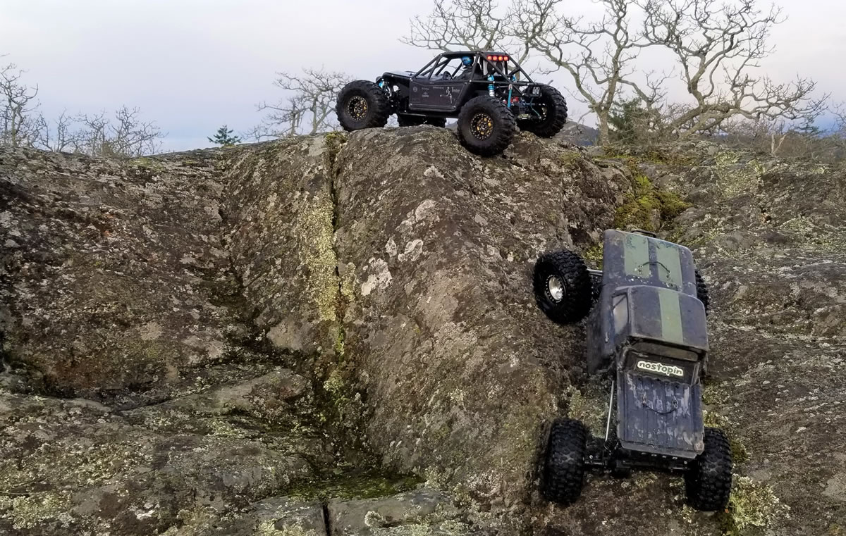

I prefer the the B2B IFS / IRS set-up over the B1B. The suspension is so plush. It's difficult to describe why I prefer the B2B in terms of performance, but I can tell you, it's a really fun rig to crawl, bounce and rock face climb.

I was able to get the B2B out for a few hours on Sunday afternoon with nostopinLucR...I know I have said this many times before, but I have to say it again, this is one hell of a fun machine to pilot. It's a perfect balance between slow crawling and fast bouncing.
