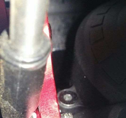

Does your servo horn Rub on the spur cover?
There's not much room in there but it shouldn't hit.
My servo is mounted to the outside of the plate & the linkage is on the inside of the servo arm.
Sorry, real hard to get pics now rig is together.

I bet bilinvic doesn't hit cover since hes still running it. Also looks like his servo ears are mounted inside on the mount too. I have mine mounted on outside of the mount and it hits spur cover. I guess it depends how your tranny adapter plate was drilled. If you look at bils motor, its almost at the end of the skid plate and mine had probably 1/2-3/4" gap from end of the skid plate.

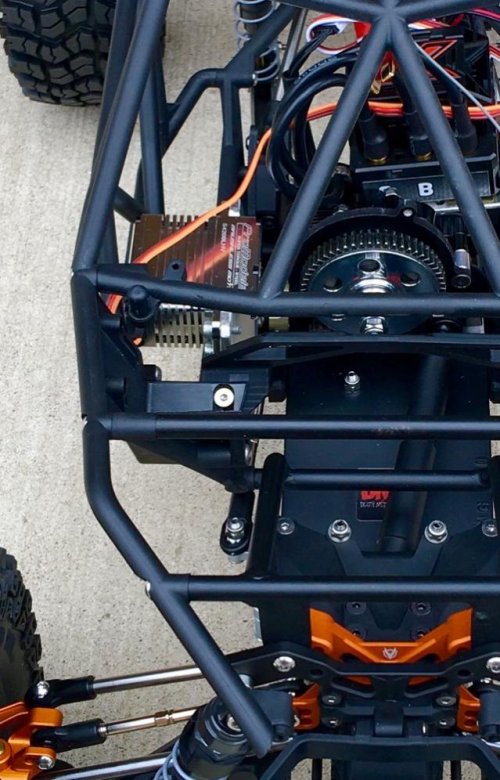

Alt, you and screamer both have your linkage mounted inside of the servo horn. My linkage hits the cage if I try that. Does your linkage mount top or bottom on the steering post?
I have mine mounted same as Alt. Clears everything lock to lock.

Another view. The drag link does get close to the chassis but clears through full sweep.

Thanks for the pictures screamer. You have your servo ears mounted inside as well, I think if I move mine inside, then put linkage behind the horn, it will clear. Since you were able to fit the 103mm center driveshaft in yours too, your adapter plate holes are drilled farther back. For me, the center driveshaft wont fit.
Sorry, didn't have a pic & couldn't remember, had to wait till I was home to check, my steering link is on the underside of the arm on the steering post.
