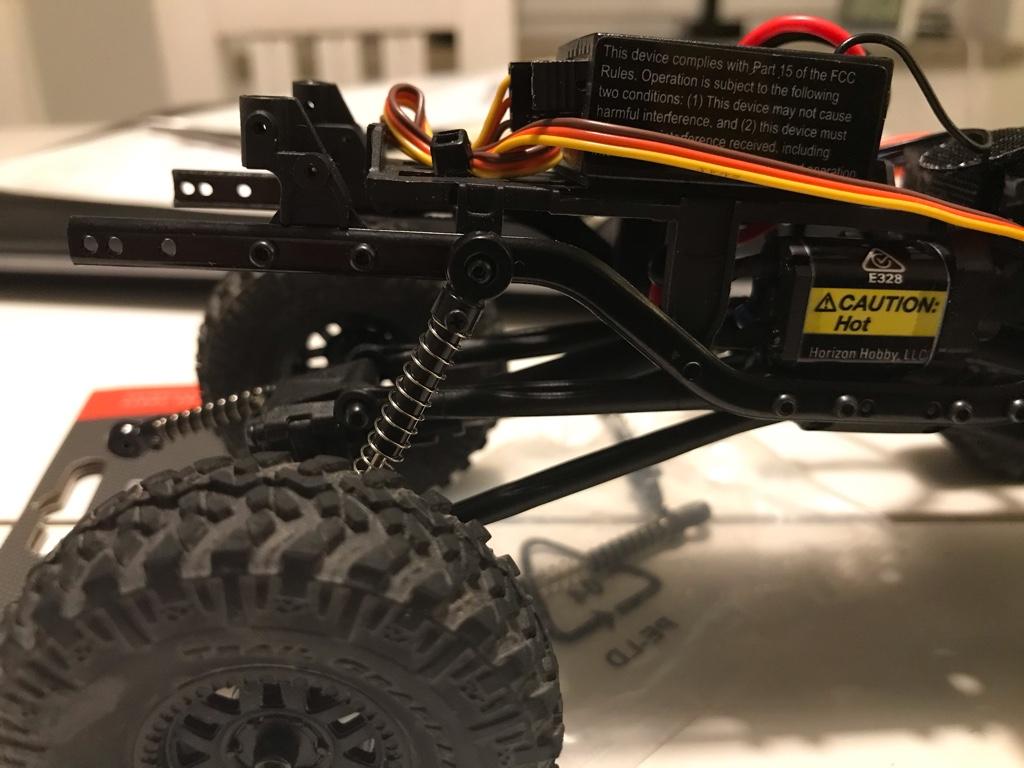

Sorry, just saw this. Um, I think they plugged right in. I only used them in the back and I had different springs on mine that I had laying around. I also had them mounted to the FRAME. Not the stock location in the rear.

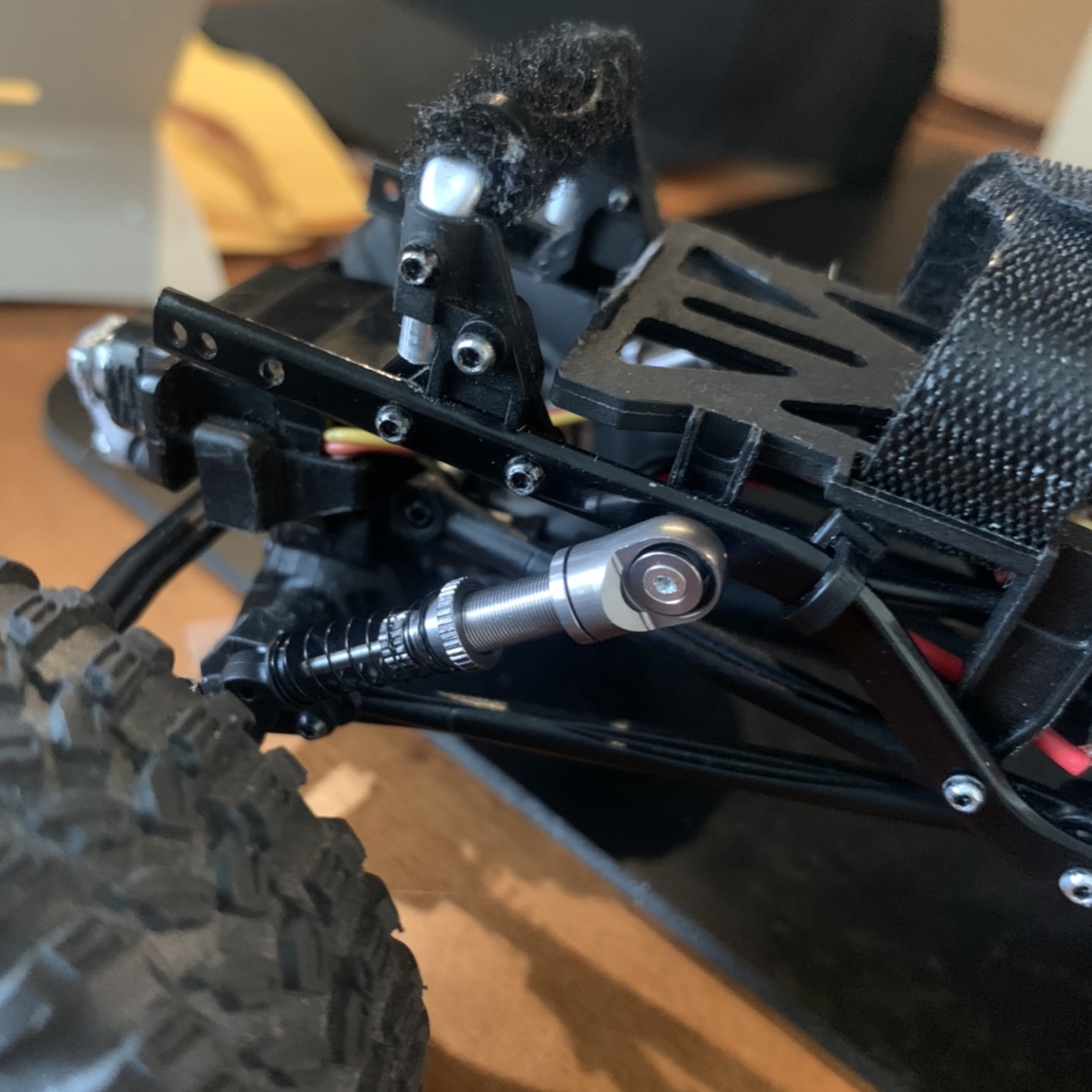

I have since changed this again to Carisma Oil shocks. Those are by far the best yet. BUT they have a much bigger eye hole so I used other hardware to mount mine. What I used, I dont know. Mostly just left over 1/24th ball ends stuff I had laying around.
But the losi shocks in rear mounted how I had mine are a cheap way to get HUGE articulation even with the front STOCK shocks still being used like normal.
So if you want a quick and easy mod, the Losi shocks in rear worked for me. But going to the Carisma oil shocks is hands down the best shock setup Ive found for the SCX24. But I also have so many 1/24th parts that I Frankenstein'd mine.

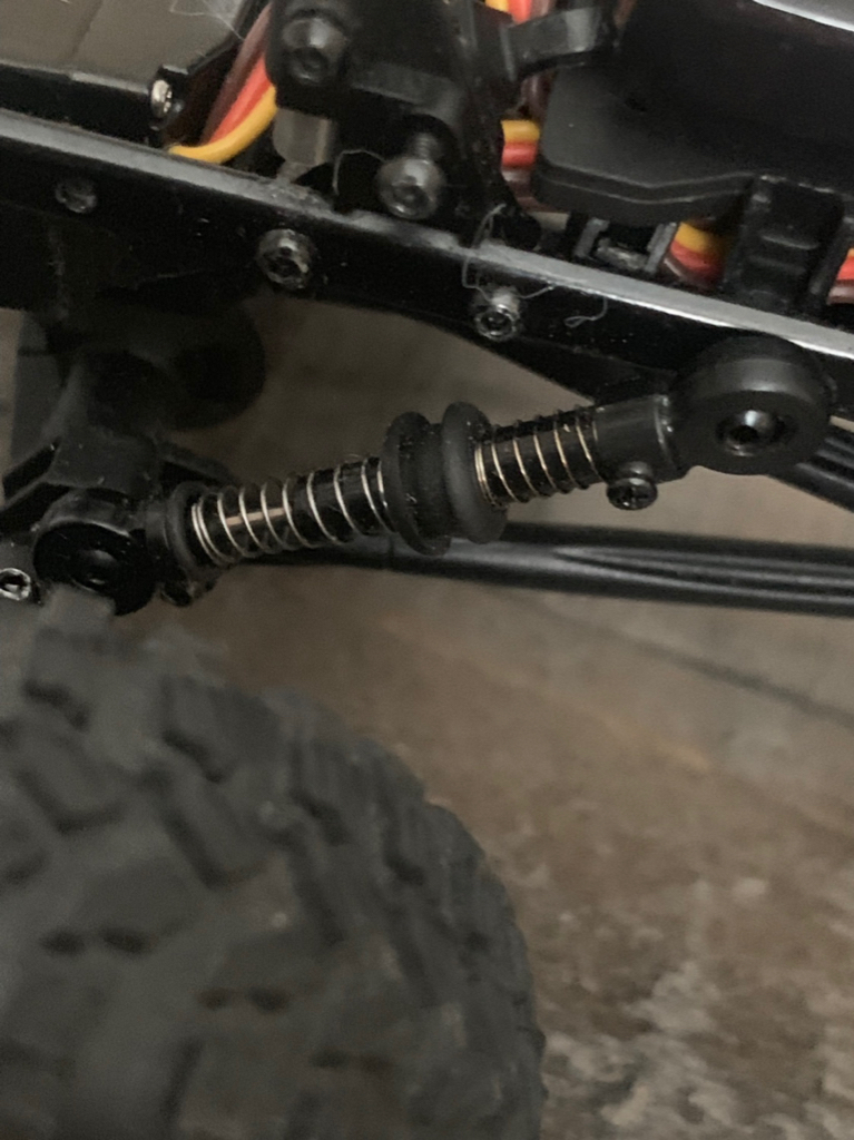

Here is the losi shocks in rear and where I mounted them with different springs I had. The o ring was used for height adjustments. I would slide it up or down for whatever height I wanted. This is REARs only. Stock front end.
And here is the carisma oil shocks I have now...
And its final look with all 4 carisma shocks. In this final build, I used RGT 1/24 shock towers and now my front carisma oil shocks sit correctly. If I used carisma or losi shocks up front in stock locations, the ride height is WAY to high. This is why I moved the rear shock mount to the frame. It lowered the body and offered 4x more articulation.
Tried to mount the Losi shocks but my frame is not the same as yours. If I mount them like you have they have not the same angle and the truck sits really high

You mounted them incorrectly bud. You need to mount them to the battery tray leg. The small one closest to rear end.

My bad, after a second look, it sure does look like you mounted them correctly. Sorry!
You will have to cut coils, try springs from clicker pens, and get inventive,
I think I cut mine or used others and used an o ring around the shock shaft as a perch to adjust my height. I think there are some photos of mine in this thread you can get ideas from.

Thanks for the reply. Drilled new mounting holes in the chassie for the rear shocks. World great!
I just would like to find stiffer springs. Easier said then done.....
Tried some springs from penciles but they were all to small.
