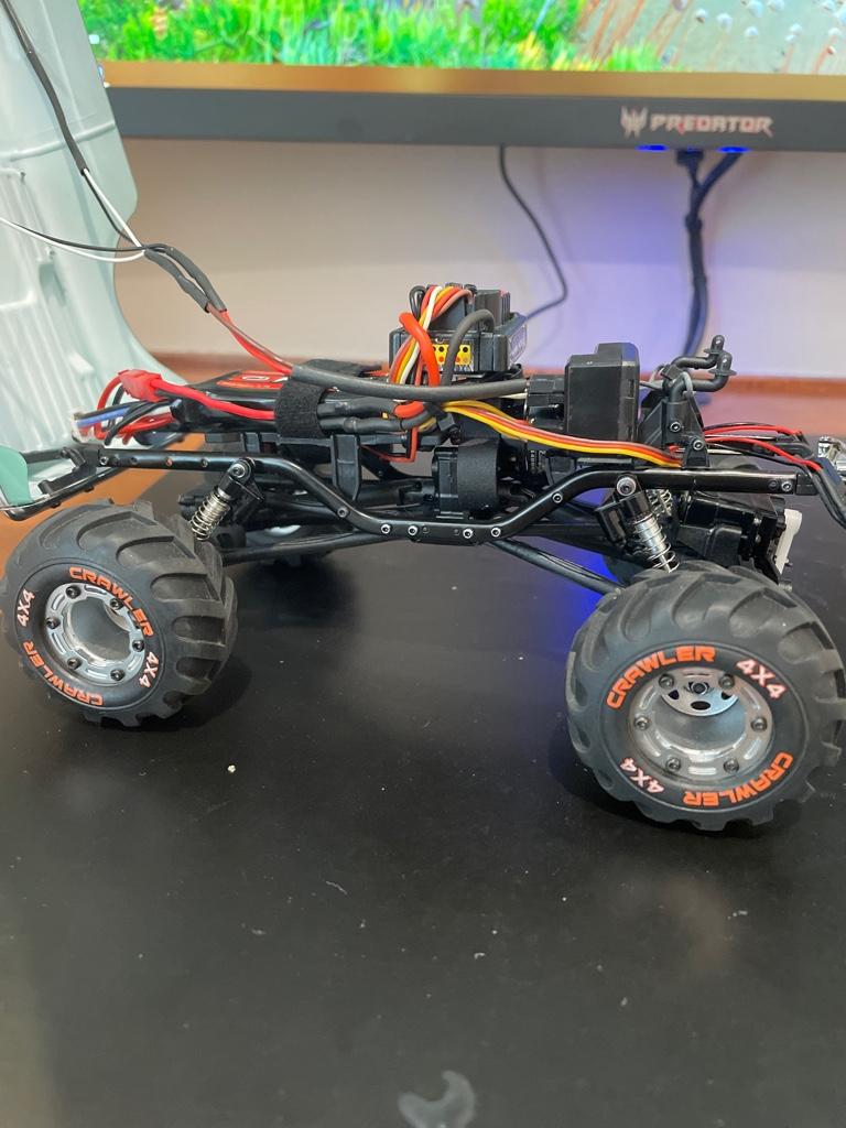

Made an account just to post. That wheel/tire/foam setup looks amazing! I have a C10 and was hoping the wheel offset would push it out far enough to not interfere with the body but I have my doubts. Do you think that setup will work with the C10 body? Thanks!

Hbx devastator wheels
RC4WD 61mm tall scramblers
Crawler Innovations Soft micro foams

Thank you. "thumbsup"
I dont have my C10 yet or I would try them and let you know. I think the HBX wheel with the crappy but very cool looking monster tire they come with would have a better chance than the scramblers if I had to guess. They are pretty tall and they might hit the fenders when you turn. But I will try it and let you know once I get my C10 in a couple days.

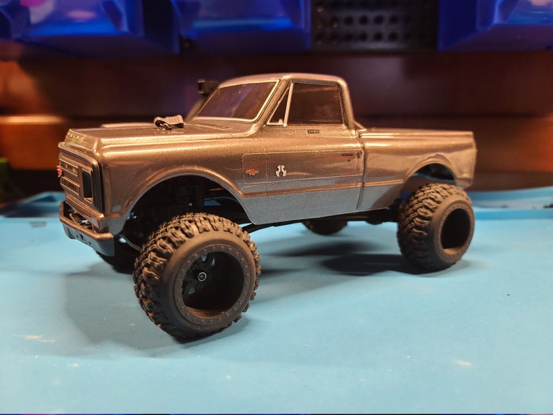

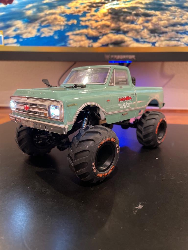

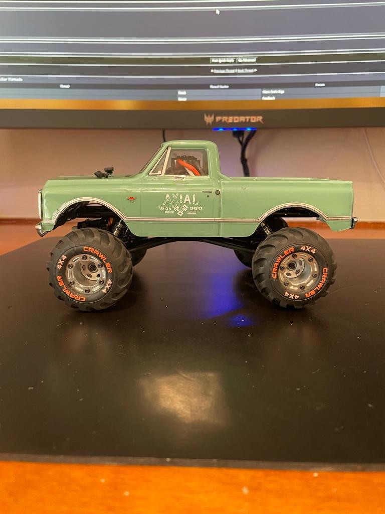

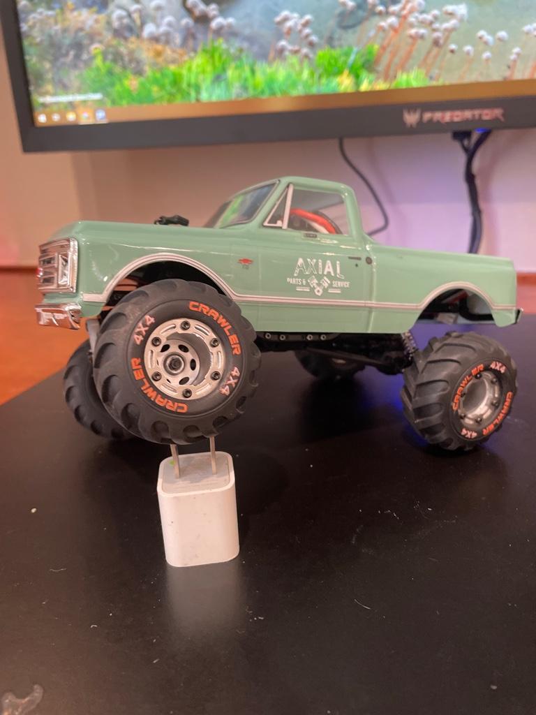

Hey, I got my C10 and I added the HBX wheels with the monster tires that come on those wheels. With stock suspension height, they rub. With it rasied up a bit, they dont rub much at all.
There is no way you will get those rims with scramblers to fit. Deadbolt, sure. But the C10, no way. At least not without cutting the body to much.

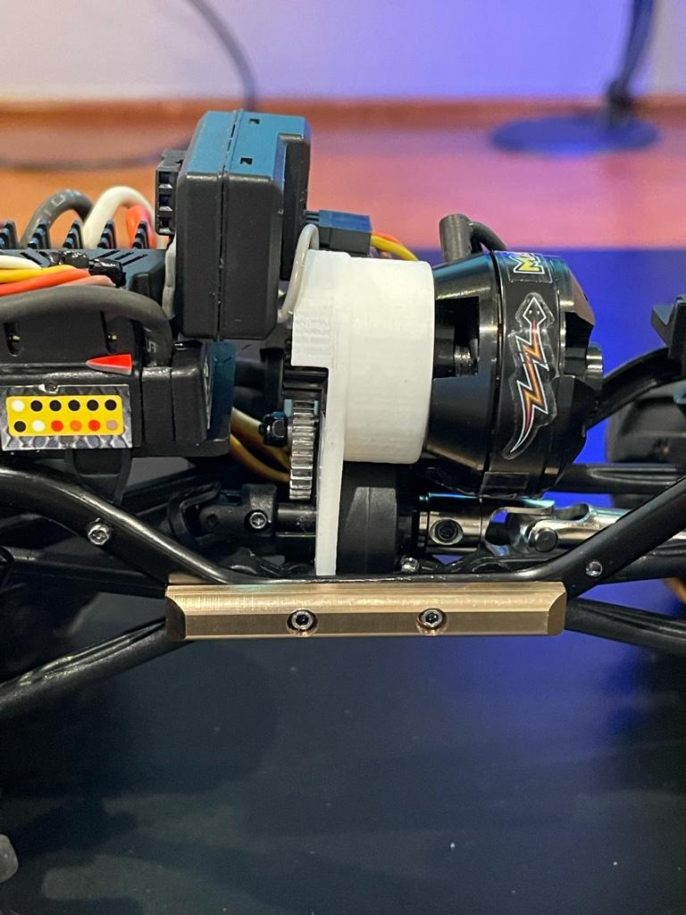

The surpass motor and the gamy RC mount shift a lot of weight to the driver side. My coil over shocks have too be adjusted a lot on one side to compensate. Or else your body is super tilted. That kind of bugs me. The suprass motor with the HR spur and an 11T pinion is super slow. Its also someway loud. My deadbolt with a 050 motor runs circles around this thing. That said, I have much much better low speed control with the C10. But I think that has more to do with the mamba ESC. I suspect the mamba with a 050 long can motor would be just as smooth.
All in all, I would not doo this again. I think the 050 motor is better bang for the buck. It doesn't massively throw off the weight balance like the surpass motor does either. Plus you dont have to cut anything up too make it work.

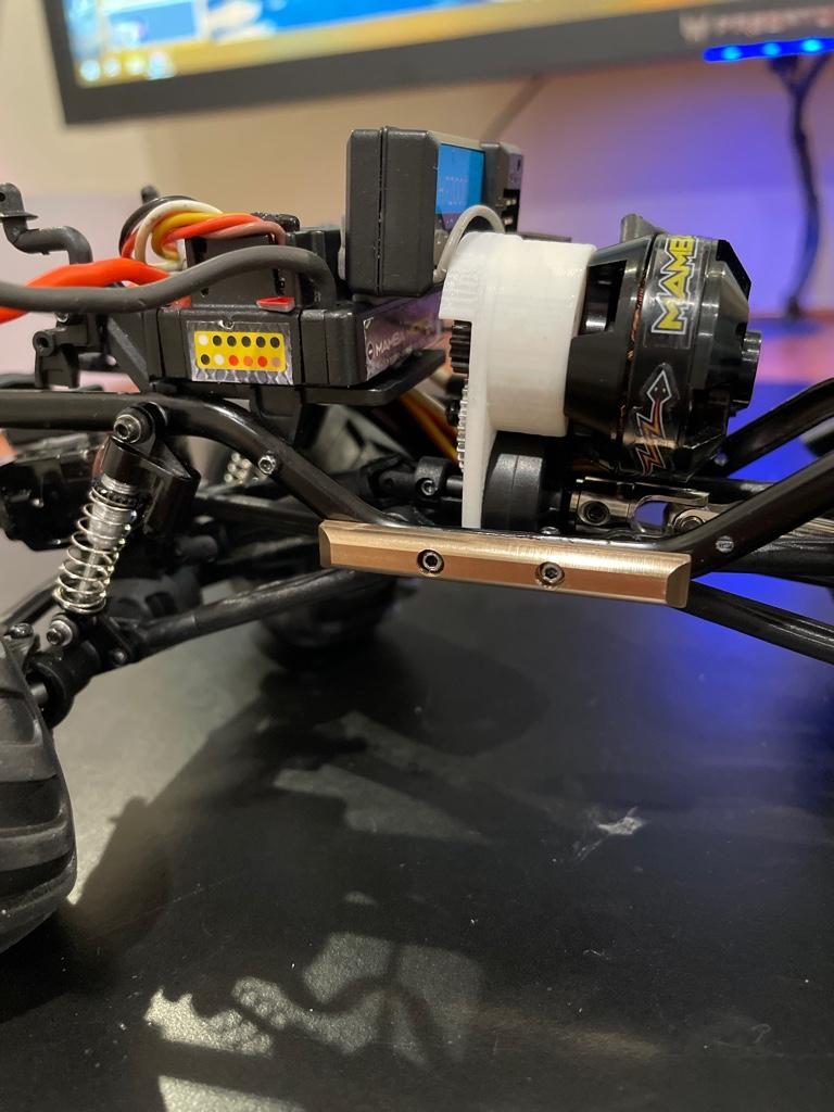

The low center of gravity plate tilts the motor towards driver side in order to achieve lowest possible mounting spot. When using this plate weight does get shifted to that side but can be resolved by placing battery towards passenger side. Although some bigger batteries may not allow for that to be done. In these cases the 380 brushless mount used for Revolver works as well and in that case motor is centered on frame for better balance at the cost of slightly higher center of gravity. Its a balancing act when trying to give up one thing to achieve another.

That all makes a lot of sense. Thank you. I fixed my issue with one of these on the other side of the lower frame.

I got the DIRTYCUSTOMS reverse surpass motor mount off eBay which mounts the motor towards the battery. For the SCX24, I feel this is the way to go.
1.) You dont have to cut your receiver tray off.
2.) The motor is much more centered.
3.) You can flip the battery tray the other way and can keep the battery where it is stock, just scooted back some.
I highly suggest you get the REAR FACING version. As I mentioned, you only have to flip the battery tray. I cut off the long legs of my tray. But you can keep them on and just have them hang below the frame. They dont touch anything.
