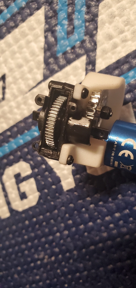

Your internal gearing in the transmission.... is that upgraded? Mine is white. Yours looks silver?
And please keep us posted. Im trying to crawl and fling mud at same time! "thumbsup"
The gears are kyx metal gears on the back side, and Hot racing spur.

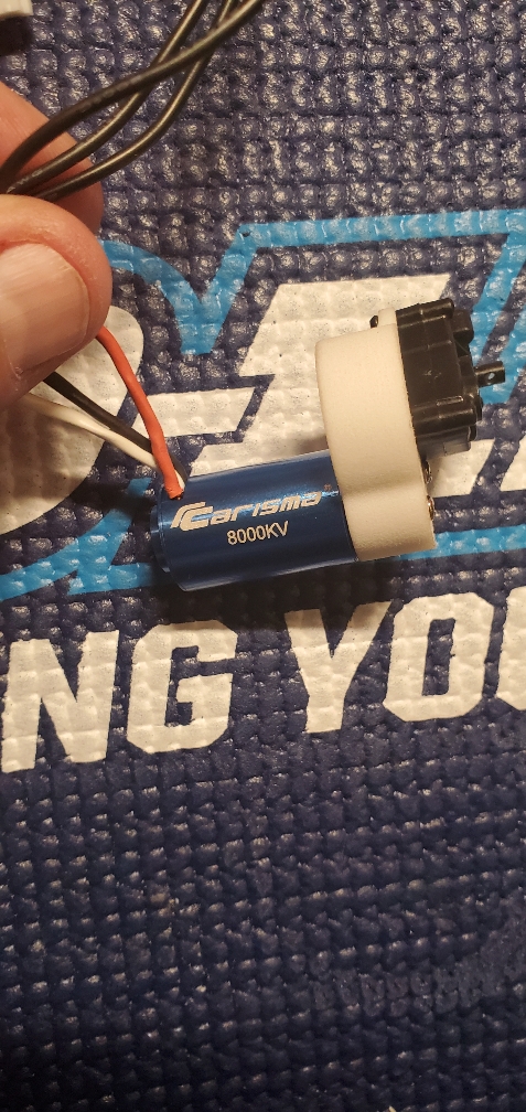

I have put this rig together and it is sick. 8000kv 130 motor with Furitek lizard esc. It will slow crawl better than stock even with a much larger pinion, and flat out rip at full throttle. I will be doing a video soon and will post a link here.
