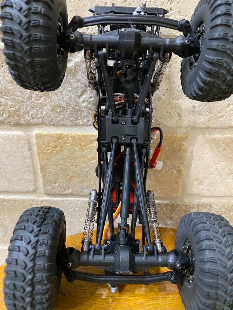

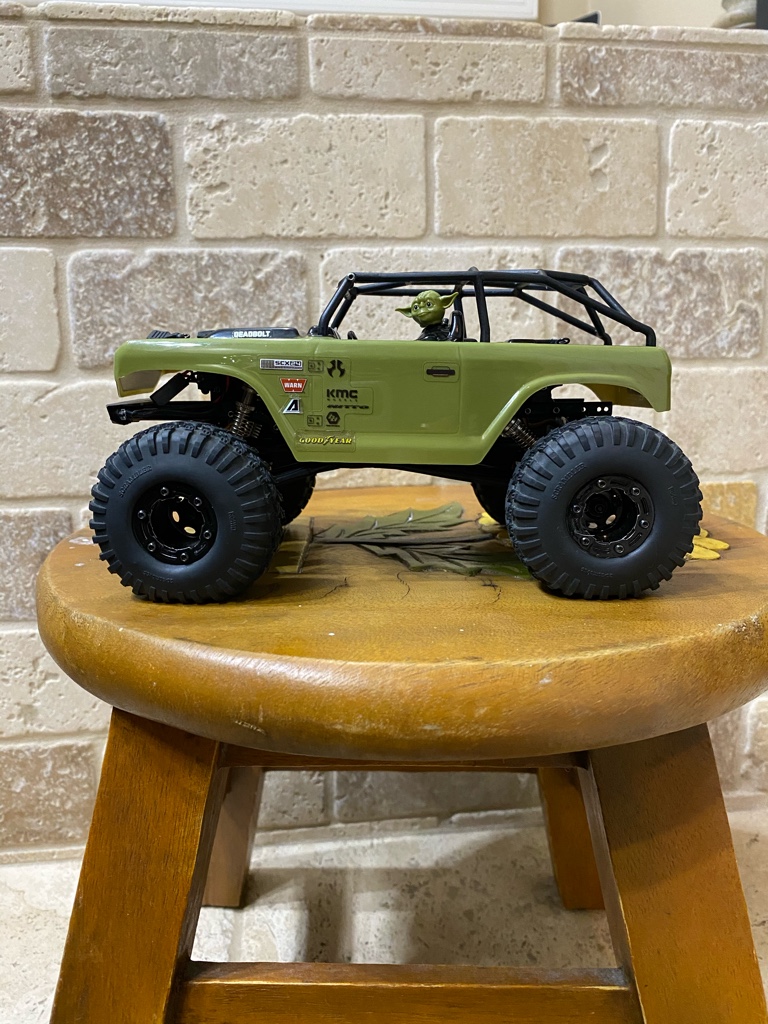

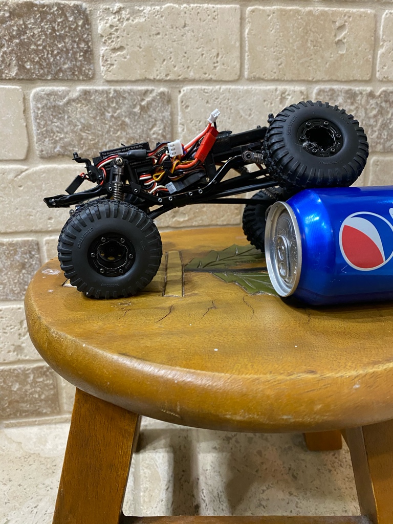

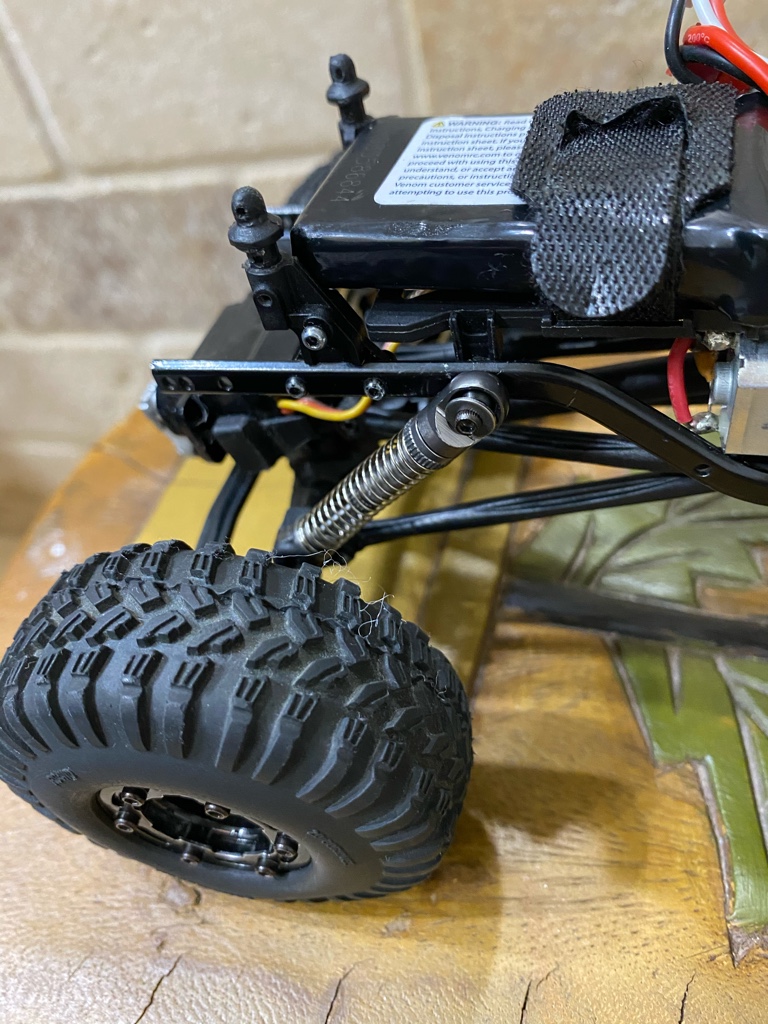

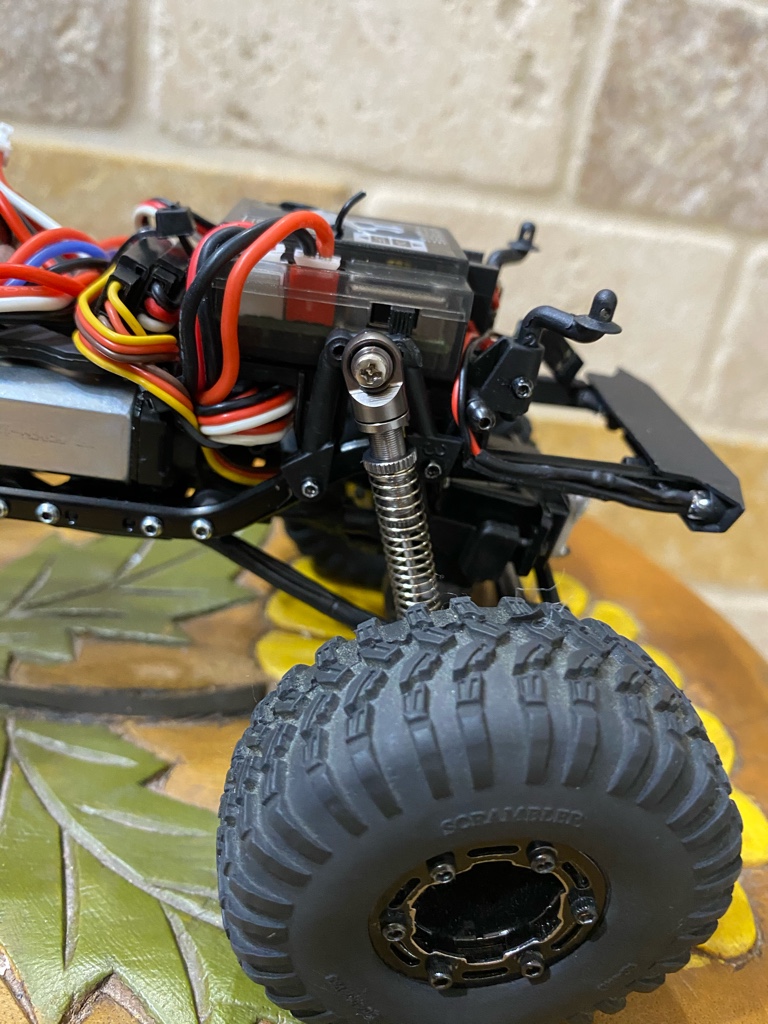

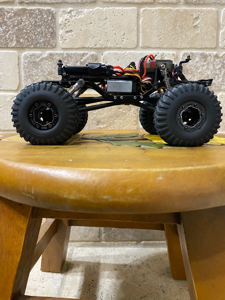

Finally picked this back up!
Added a 050 long can motor off a 1/24 barrage. Also used the metal pinion off the rc4wd motor I had in the scx24. I had to drill holes in the motor plate. Easier than I thought that would be.
This motor is much better than the rc4wd motor I had it in. Either motor is an improvement but the long can seems to have even more torque than the rc4wd motor gave. Which I thought was a pretty good improvement to begin with.
I also added some front shock towers off an RGT 1/24 junker I had laying around. I now finally have all 4 matching shocks. Which are the cariama oil shocks. I love them!
Here are some pics.
Current mod list:
Stock ESC\RX
ECX 1/24 050 long can with 11t pinion.
4WS using 2 emax es08ma servos.
4 Linked front end. (Wishbone rubbed axle)
Servo signal reverser
Scrambler tires.
Crawlwer Innovations Soft micro foams (LOVE THESE)
Hbx monster wheels.
Solder wrapped wheel barrels.
Cariama oil shocks
RGT front shock towers.
Relocated rear shock top mount
430mAh 2cell
