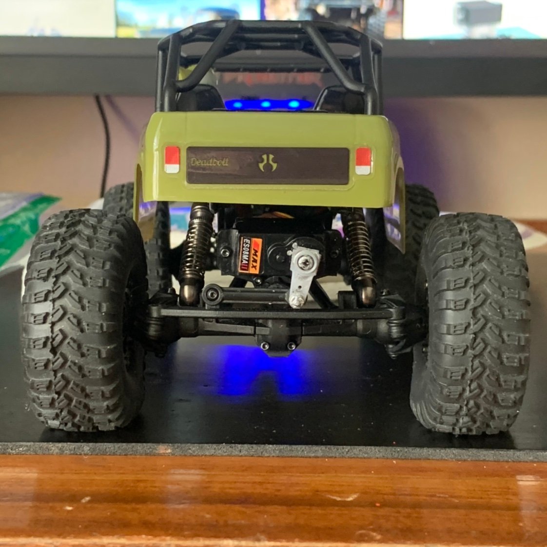

Got my carisma oil shocks on. I used the stock springs with the stick spring lower. I used the Carisma mounts up top with longer bolts going into the battery tray mount.
I could not use the carisma ball end mounts on the bottom because I have 4WS and they limit the turning radius by hitting the c hub.

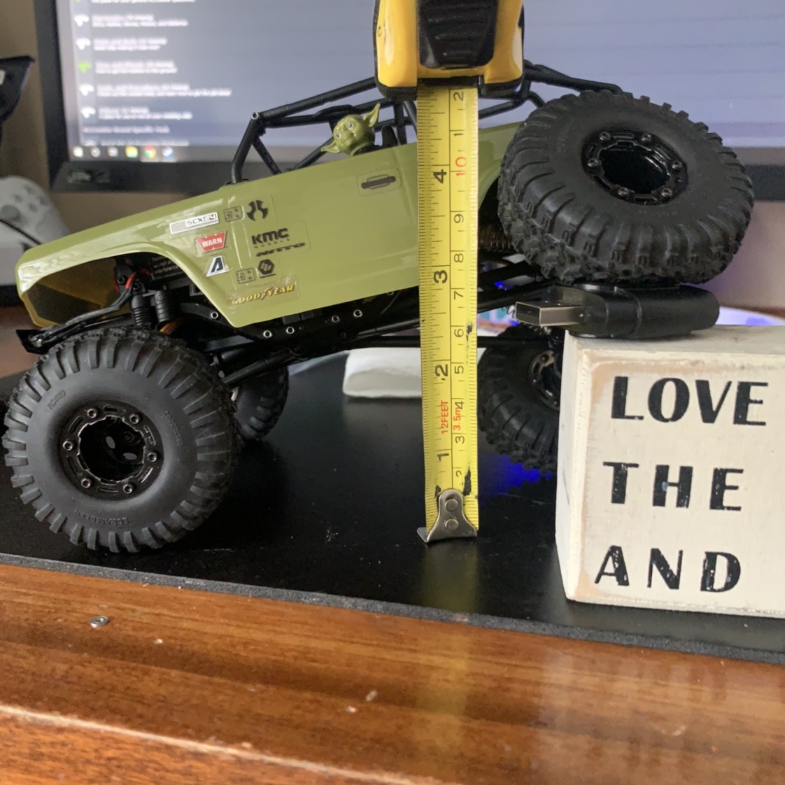

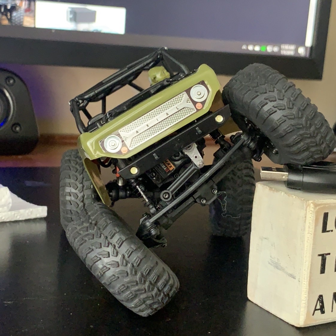

They feel no different than stock since I’m using the stock springs. I just have way more articulation. The rear axle almost goes full vertical. I must have 65mm+ of articulation.

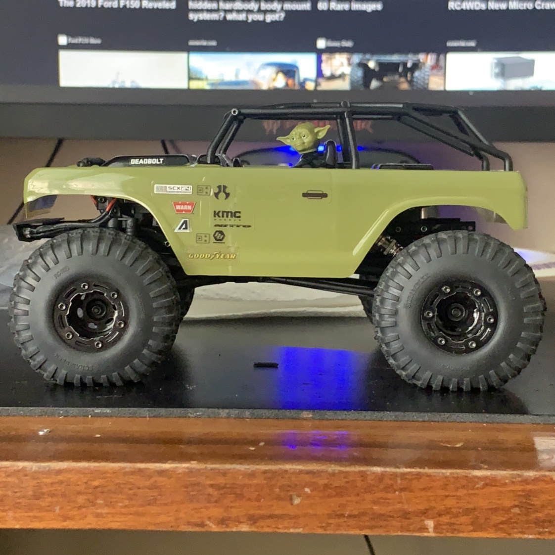

It sags in the rear a little to much and I can’t put anymore preload on the shocks.
Messing with rgt adventure shocks springs now.

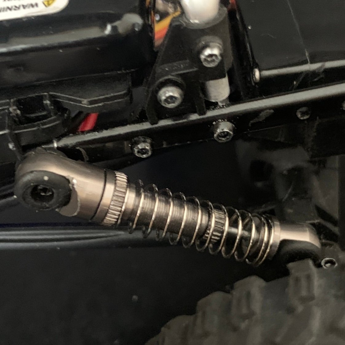

Carisma oil shocks are bad ass! I used some rubber o rings that you typically use to shield wire going through a wall. And they hold onto the stock ball ends just fine. I had some RGT springs which look identical to the carismas. I cut those down a few rings. And this is end result.
Check out that flex!

Correct. I found mine at my local hardware store. Im sure any rubber tube would work. Mine are tight enough to not come off at all. But much easier to remove than plastic on metal ball caps if that makes sense. I left what little oil was in mine alone. I didnt add any yet.

I also have mine installed to the hole your battery tray connect though. And I have cut springs to make it sit where I wanted. Stock height spring is too tall.
RGT springs are exactly the same size and I used those to save my carisma springs. But they look and feel identical.
