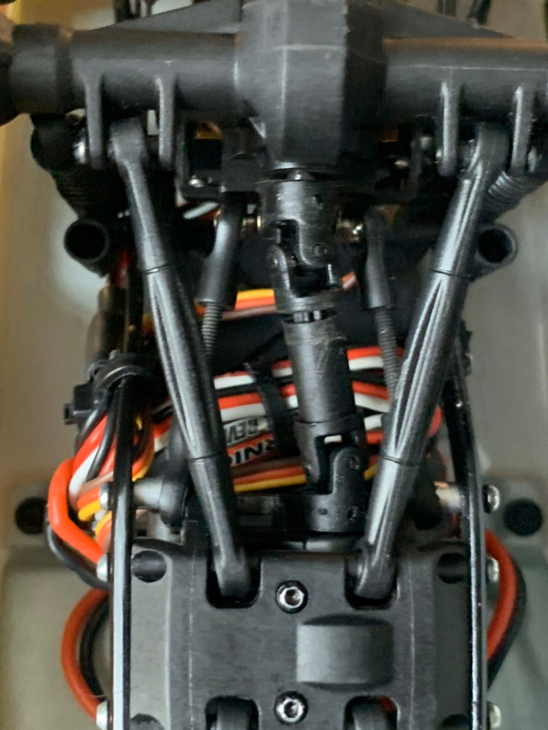

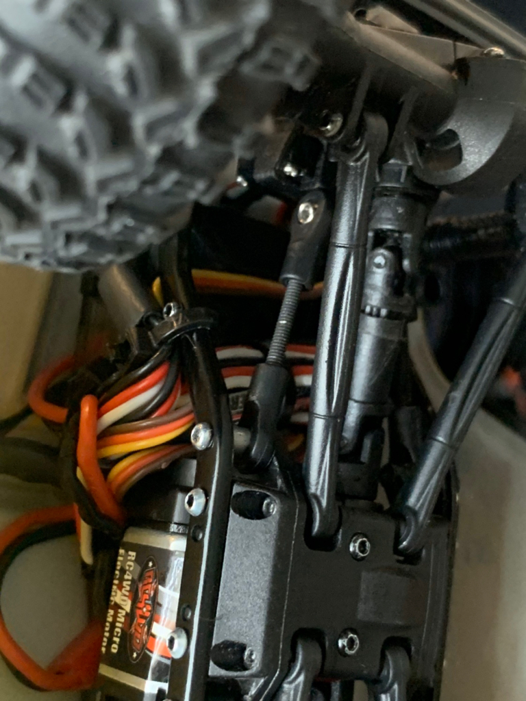

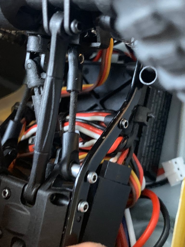

My front axle wore my three link “chicken bone” down and was starting to make noise.

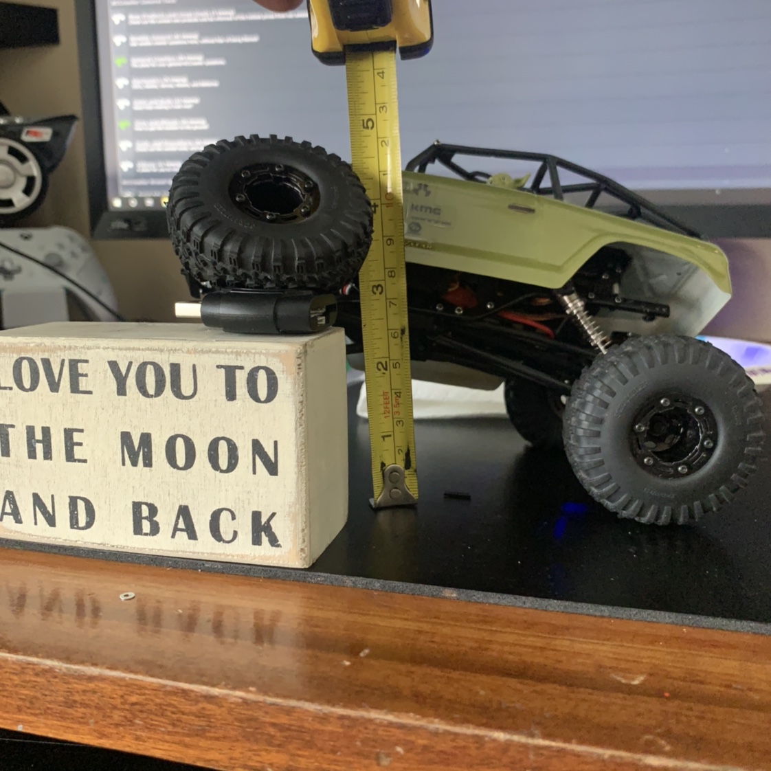

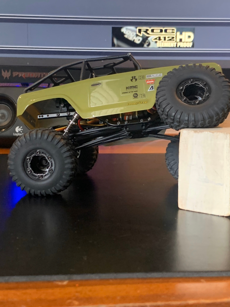

So I 4 linked the front end with spare parts I had laying around. It solves the drive shaft from rubbing, but I lost 5-8mm of articulation?!
I only changed out the chicken bone. And I keep my links the same length as the chicken bone so I’m not sure what caused that but oh well.
Before I 4 linked articulation...

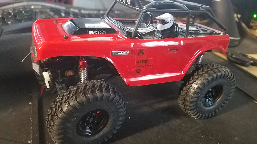

Finally got around to installing these little guys. Nice little shocks but the springs are too stiff. Finding softer springs might prove difficult so I might just try to cut these down a bit. They sure look nice though, that's for sure.
