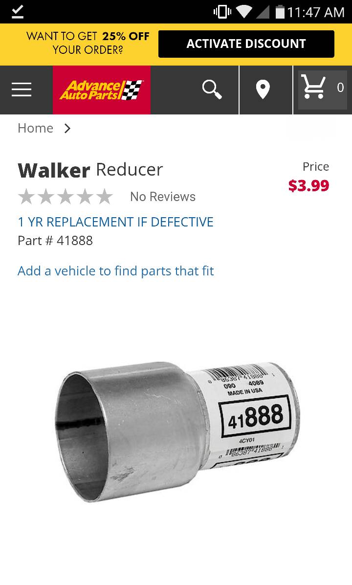

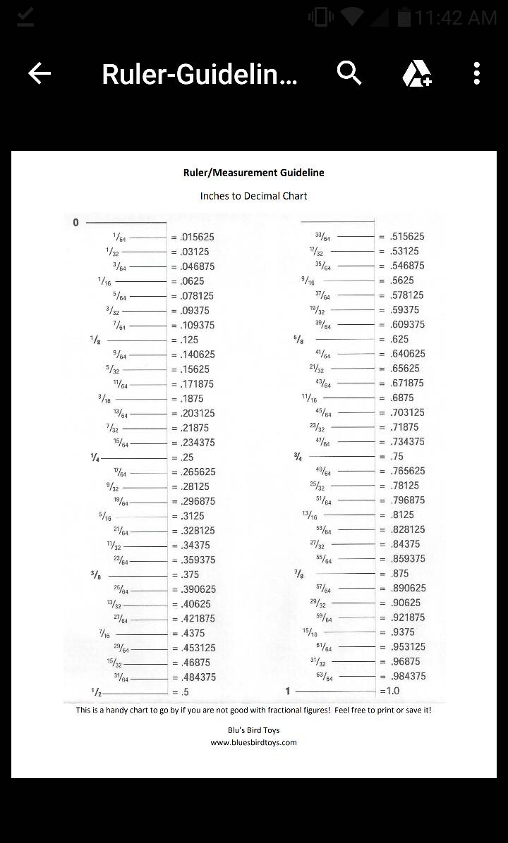

I was thinking bout the new pipe for inner ring option and came up with this 43mm is 1.693 inch and if you convert that to fractions using this handy chart. You end up .02 mm or so bigger then 1-11/16" advanced auto parts has a walker exhaust adapter/connector in that size for $3.99 if it really needed the .02mm you could expand it with the tool. But i doubt you would have to or you could just ca the ring to the tire and hope the foams are good but i wouldn't
