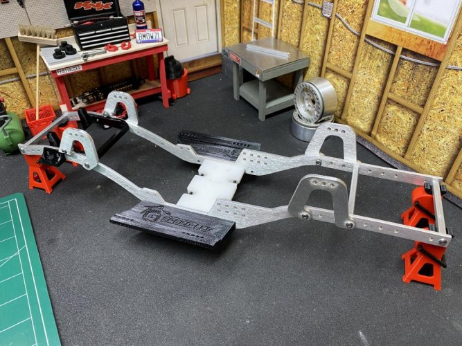

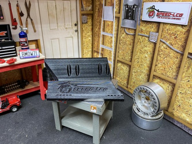

New Class 1 build has arrived in the B-MOW RC Garage! I had planned on starting this build later this year, but decided to get a head start on getting the parts delivered to the garage.
To keep up with my obsession with the GSpeed custom rigs, I picked up the V1-C1 alum rail chassis kit. It comes with the rails, shock hoops, V1-C1 printed sliders and I chose the white delrin skid plate and the G-MP panhard mount. Also picked up the GSpeed square chassis spacers in clear and the G-LD laydown servo mount.
Besides the chassis and accessories, here is what I have so far:
- RC4WD Mojave II cab
- RC4WD Marlin Crawler pre-bobbed bed
- Axial AR45 portal axles (Take offs from my SCX10.3 JLU)
Parts and accessories that are planned and still needed:
- Body parts & pieces to finish the Mojave II body
- Incision driveshafts
- Dravtech short shocks (was going to use the Traxxas 2660 big bores, but
they are unavailable everywhere)
- Transmission still undecided
- Electronics still undecided
- Wheels and tires still undecided
- Misc. items still undecided
There is still more I need to get planned out for this build, so I'll be taking this build slow and steady. Hopefully have a functional rig by this fall.
Here are a couple garage pics of the chassis and body.

Another piece of the fun arrived yesterday. These are the GSpeed V1-C1 hard body mount sliders. They were out-of-stock when I ordered the chassis, but the very next day when I checked they were back in stock.
These sliders were designed to mount the TF2 Mojave II body. They use the same technique to hold the body on as the factory TF2 slider mounts. There are holes along the edge of the slider to install long grub screws to hold the body in place.

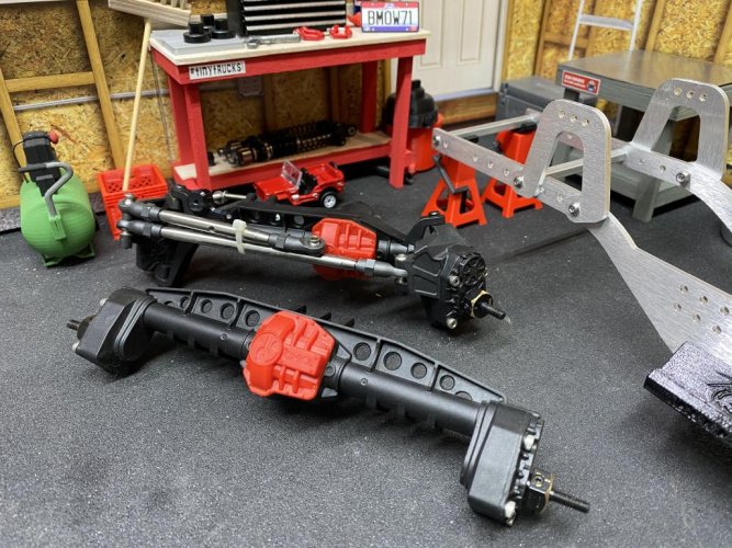

I forgot to add the pic showing the axles on my previous post. I'll be using the AR45 portal axles that I took off of my SCX10.3 JLU. These axles got replaced with a set of the new Axial straight axles. These AR45's are still fairly new and in great condition. They only saw about one battery pack of use when they were on the JLU.
These axles are still stock with stock gearing. I did add the Bowhouse RC aluminum panhard mount and a set of Samix 6mm brass hubs when they were on the JLU.
