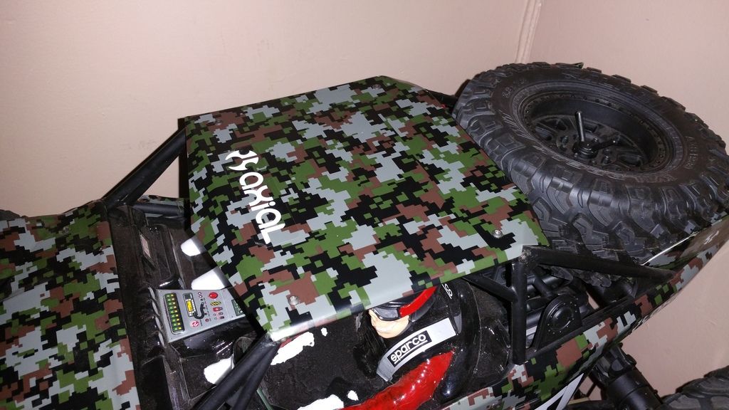

So I got my T-Bone stuff and went to install it all. This is my first impression of the company and my first purchase so obviously I'm eager to see how it goes...
The roof looked like I imagined. I think this thick delrin roof should help absorb impacts from rollover a lot better than the stock piece of lexan. Fit was perfect.

I like the roof panel and it will definitely be better than stock. I wish someone would make a top that wraps around the cage a little. The corners of my Yeti Jr and the XL get the worst of the grinding. I think i will try to mold one using some left over Kydex i have from my knife sheath and holsters.
