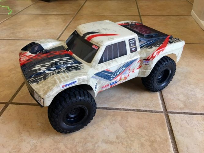

Here's another visual "upgrade". Ever since I saw these trucks side by side I knew I wanted the Score Body on the Yeti rolling stock. Nothing wrong with the Yeti Jr body, it looks very nice in fact, but the Score body is so much nicer. Those Score Jr wheels and tires are just too damn small to have any effectiveness off road unless your biggest obstacle is a nickel. As luck would have it, I caught a Score Jr body on eBay about a week ago for less than $30 shipped. The box shows up today with the brand new Score body AND the full set of TT wheels and tires with a nice little note. What a cool guy! Anywho, I immediately pulled the Yeti body off and had to compare them side by side. It's hard to believe these are the same scale. I guess the 1/18 scale Yeti body is supposed to replicate a Polaris RZR in comparison to the TT JR. :ror: It's quite obvious to me that the larger set of wheels and tires belong under the much larger truck body so I will start working on making this the truck it should've been, the same way I was forced to with replacing all electronics. :lmao: More coming....

Got the body trimmed and fitted last night. First I had to install one of the tiny Score Jr wheels and tires just to confirm how wrong they are for this body. It was worse than I thought. Looking at the top pic, it's immediately obvious which one of these wheels is the right choice for this truck and body. So with the correct wheel and tire reinstalled, I lowered the body back onto the chassis and started cycling the suspension. I was surprised at how little trimming was actually needed. At the points where there was most contact, I only had to trim less than an eighth of an inch and less everywhere else. The Score body has a nice lip on all four fenders you can use as a guide. 4 quick cuts with the lexan scissors and a couple adjustments and she's tucking the tires with no more rubbing. This turned out great and for less than $30 shipped I'm pretty happy. I even have a set of hilariously small tires for scale accessories or whatever I can find. I'd highly recommend this to owners of both trucks. If you have the Score, buy the Yeti Jr wheels and tires. If you have the Yeti Jr, get yourself the Score body and trim it up. For those wondering how much weight this adds, the Score body is only 5 grams heavier. I can live with that, especially since I lost 40 grams of weight up high by switching to a lipo battery.

Excellent! This is exactly what I wanted to see and what I next intend to do with my SCORE. Up until your post, the only glance I had of this potential was a brief moment in Hemistorm's video when he casually dropped the SCORE body onto the RR.
