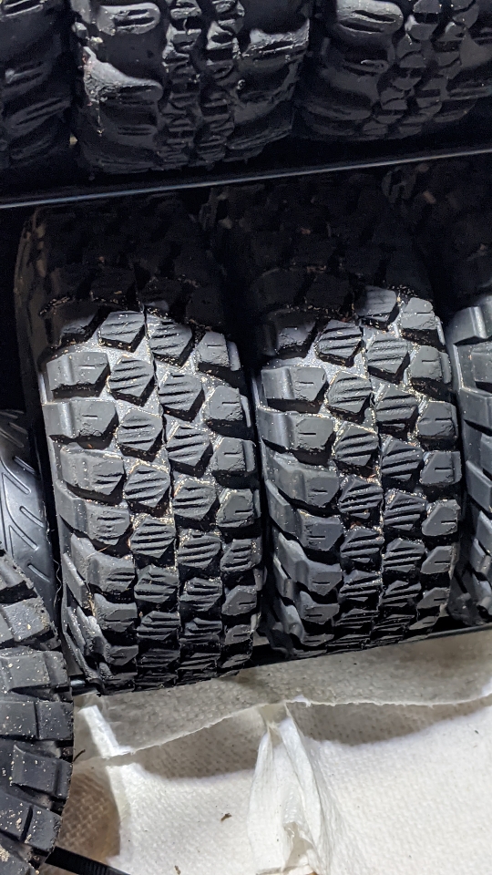

WD40 is more of a solvent, cleaner, degreaser then an actual "lubricant." A solvent works to break down the rubber making it "in theory" a little more sticky.
Do you recommend one sipe cut per lug or two? Also, can you elaborate on the WD40? thx.....
Some people say to remove tires, remove foams, put into sandwich baggie, fill half way with wd-40, and let sit overnight [emoji15], personally, i just remove tires, remove foams, spray lightly inside the tire, but coat it. Then spray the outside/tread/sidewall thoroughly over a piece of cardboard, or inside an open box...let absorb, repeat, let sit, repeat getting lighter each time with the actual spray, while making sure ive covered at LEAST all of the treaded area of each tire. Let dry/wipe off with clean rag or "dab" off excess...install.
I managed to fit two sipes per lug, woth a dremel cutoff wheel, speed set to 3 on a 1-6 scale. Just make sure the sipes come from one edge of the lug, through to the other edge, if space allows-tool-wise. Heres an example of a different tire, which i managed to fit 3 sipes on most lugs.

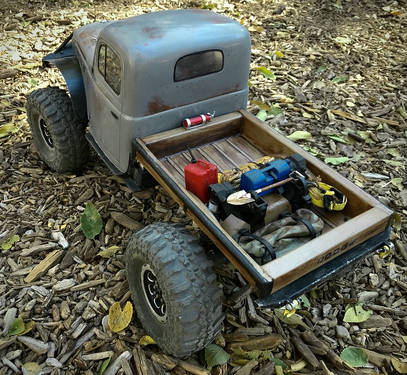

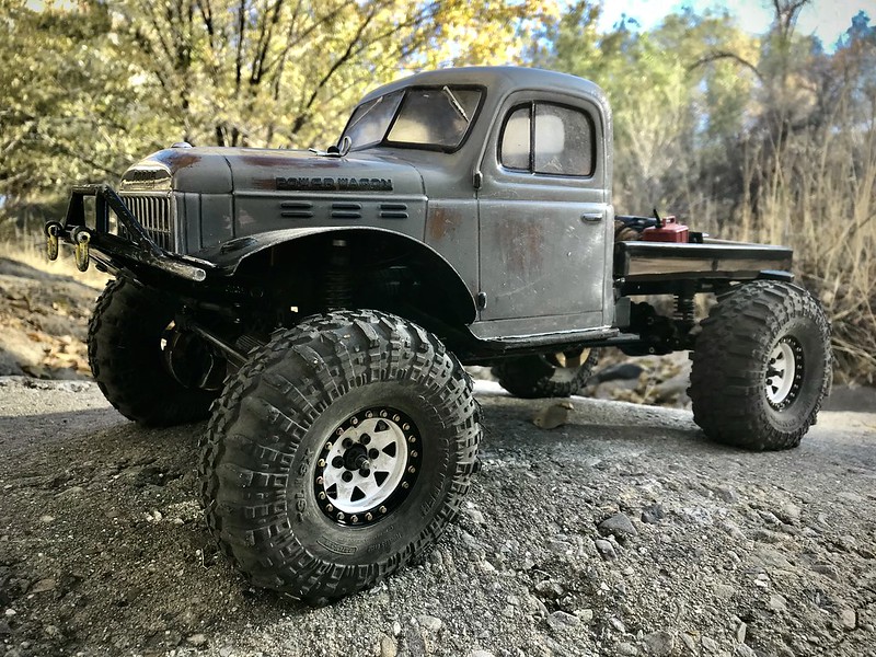

Always thought the power wagon/ flatbeds were pretty cool, so decided to build one up...chopped a bunch of plastic and lexan. Cut the lexan bed to make it a flat bed and mounted some stuff to hide the shock towers/brace a bit.
Sanded inside of cab and painted with some acrylic paint to add texture, rust. Same with bed to add some woodgrain and dirt texture.
Without going full retard scale think it turned out pre good"thumbsup" ...I roll and bash my bodies up pretty good to spend weeks painting up a body and detail...think id cry if I were to damage a rig like some of the folks put time into. But its pretty dang cool the detail in some of the rigs out there!
Crawled really good, like seeing the tires on the back and narrow bed. nice low center of gravity too.

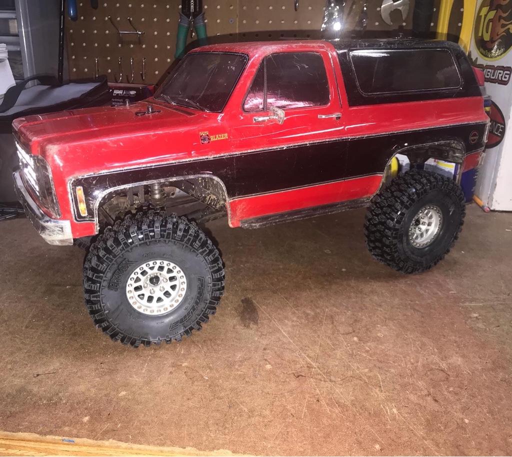

and some new SSD white 8 spoke beadlock wheels today...
(can see old wheels in this photo v)
Realized none of the beadlock bolts were tightened:x ...already lost a couple.
Didn't have anything to do that so made a tool outta a hex bolt and nuts.
probably will need to add some loctite at some point
Looks great! I like those rims!
I’ve been very happy with the ssd portal brass like you got.

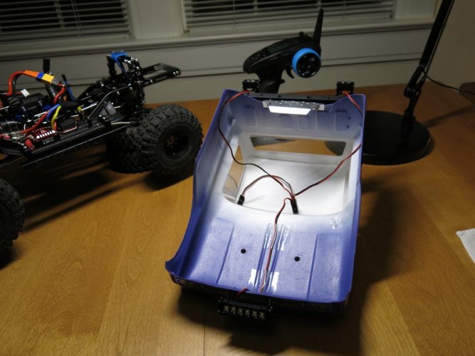

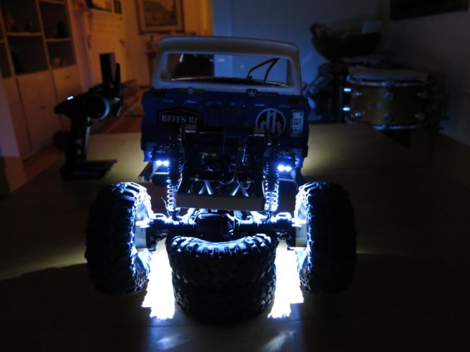

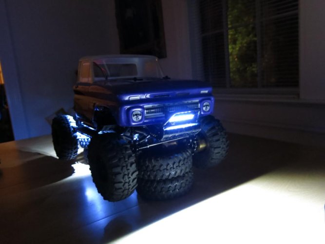

RCBee Finally got Gearhead Lights Installed
Finally got these bad boys right in time for Daylight Savings Time They are Bright and fully Waterproof ... Buzzzzzzz..... Buzzzzz.....

Gearhead Lights Video Awesome Lights
these Gearhead lights rock and look great on the Honey Comp Crawler

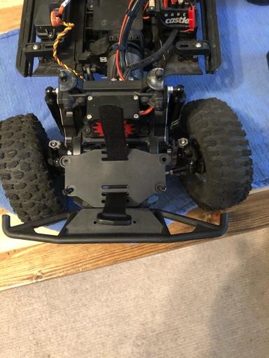

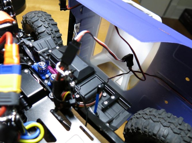

So I came up with a hair brained idea of moving the battery totally up front right behind the front bumper.
I figured the extra weight would help keep the front end down.
I ordered up the Traxxas small battery tray to mount up there.
It showed up yesterday, I quickly mounted it and charged up my big 2200 mah pack, figuring more weight the better.
Here is the quick mount job that worked well enough.
Headed out to the rocks aaaaaaaaaaand it did not work worth a lick.
Front still rose up pretty good.
I’m thinking I’m running to heavy weight of shock oil (30wt) even with three hole pistons.
I’m constantly having to push the truck down, which I didn’t have to do with no oil.
So, my next step is to go back to light oil like I originally had with the different springs.
If I am still not happy, then I’m going back to the stock traxxas shocks next season.
