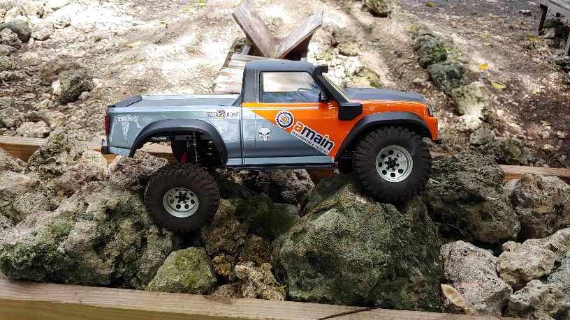

I finally got my truck out for its maiden voyage. 45/9 gearing with 2200mah 3s in up front battery tray. HW1080 with a Holmes Hobby Crawlmaster 12t, 4.35" Pitbull Braven Berserker Alien Kompound tires, and SSD steel wheels. I'm in South Florida with a lot of coral rock. These tires don't climb well on man made wooden obstacles, but on the rock these tires reign supreme.
I found out very quickly that I need weight up front. The battery isn't enough. Steep climbs were tough. My son brought his Wraith. That thing is "The King" out there.

I really like that color scheme a lot!
I take it the coral bites pretty good. I’d love to be able to try rocks like that out.
Reading your post about the front battery tray gives me an idea. I have a heck of a time with my front unloading when going up.
If I got a front tray and place my packs there, hopefully that would help keep it down better.
Great looking rig!
