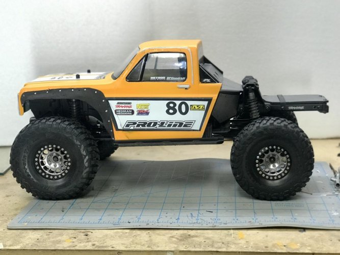

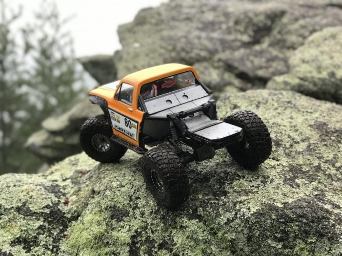

Scratch built a cover for the back half of my “Truggy” - parts bin build. I’m really happy with it so far👍🏻

Scratch built a cover for the back half of my “Truggy” - parts bin build. I’m really happy with it so far[emoji1303]
Wow. That looks awesome! I may do this to my Bronco if the get the nerve to take the chance and cut the bed off. What’s it built from?
Crap that looks great ^^^ ! Love that paint and that custom back half is perfection.
Thanks! Pro line 80s Chevy C 10 body I had sitting around. Painted on the outside with some leftover camel yellow Tamaya PS, some black and some white Duratrax. “Quick and dirty” haha
For the back half is leftover polystyrene. I first made a template from thin cardboard. Traced and cut it out. Then I used the corner of my workbench to form the bends.
I really went into it not giving a crap because it’s a beater body that will see a lot of rocks.

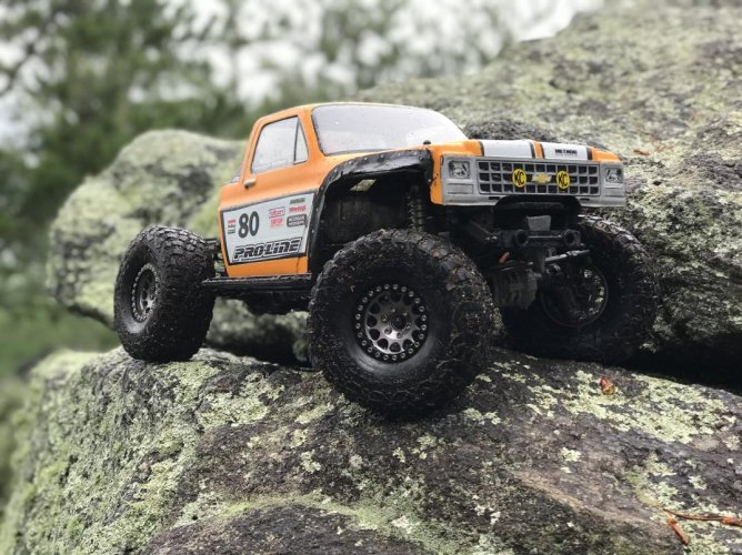

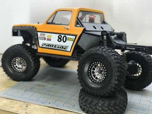

Let’s try this again... TRX4 #2 got some new shoes. PL BFG and crawler innovations deuces wild foams

Trx4 #2 got some new shoes. Proline BFG mud terrains and Crawler innovations deuces wild foams.

Thanks for the kind words! I’m using the heavy duty Deuces Wild for XL sizes. I’m using the CWR-3005 on all four corners, per Ed @ crawler innovations. Definitely reach out to them via their website! Super helpful and theyll tell you what they suggest for your exact tire and truck weight, usage etc.
Our trucks see an occasional creek bed and I wanted something waterproof. I questioned the firmness at first but keep in mind that they soften up as they break in. Now I think they’re perfect. I went with crawler innovations because of the diverse product line and I thought it fit my application the best.
I use qtr inch foam to fill the slight air gap but that’s just preference. Also, I like the way crawler innovations clothes sale fits on the pinch ring in the wheel. The pro lines have a raised ridge or center spline if you will that are made to fit within the recess in the center of their wheels. I know people that use pro line forms on non-pro line wheels and they work great but it’s a preference for me.
