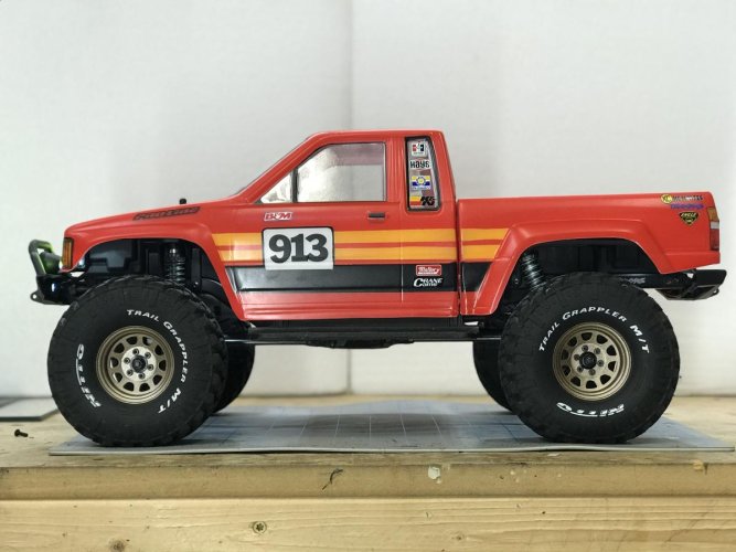

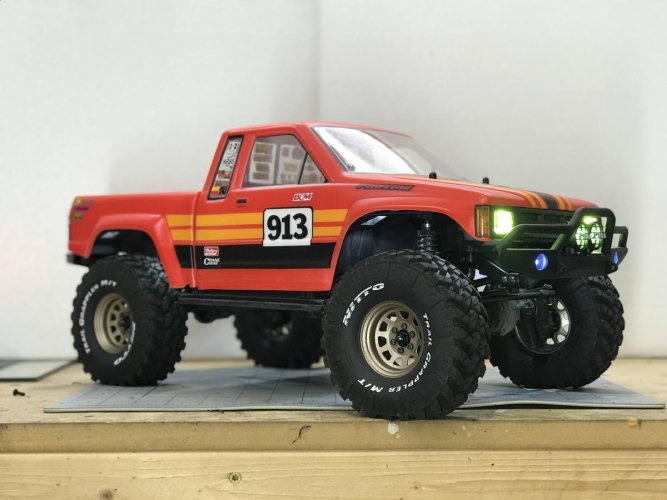

Buddy and I finished up his new Ford body and took it out for a shakedown run. My D110 and Bronco used to out-drive his in many situations but as of yesterday he is now able to outperform my Bronco. With his old top-heavy D110 body, the edge used to go in my favor but now with all he's done... the COG is lower, the longer wheelbase gives him a firm advantage in hill climbs, and he's balanced the weight front to back. We can still do the same lines but my Bronco bounces around more which leaves mine a lot of times, not pointing exactly where I wanted it. His is better planted and more controllable time after time on the same lines. I'm happy for him though. He's worked hard to get this truck not only looking great but performing great too. I'll dig up the dusty build thread and update soon.
Bro I love the way that Ford looks!!! And I'm not a Ford guy! Nice work brother!!!
