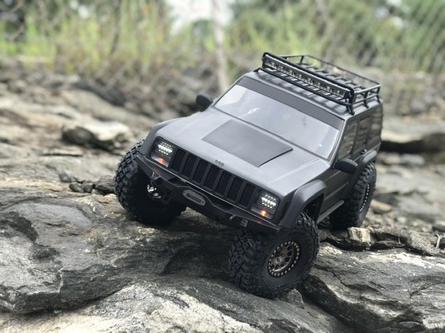

I’ve always liked the Axial XJ body and decided to build one. Fits well on the TRX4 I think! Just a few finishing touches like RC4WD metal emblems and some trimming.
Got the metal emblems on and snapped some pics at work. Ready for the weekend.
That’s probably the best looking XJ I’ve seen, great job!
