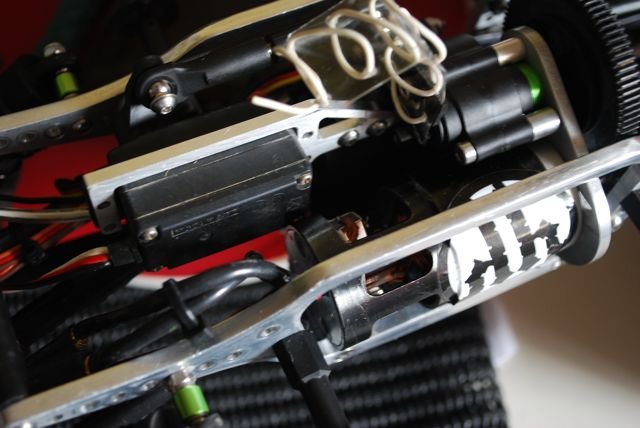

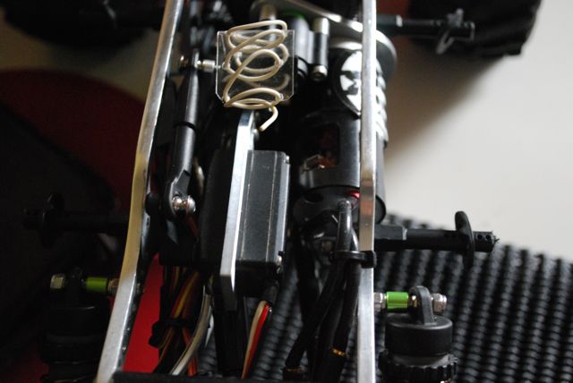

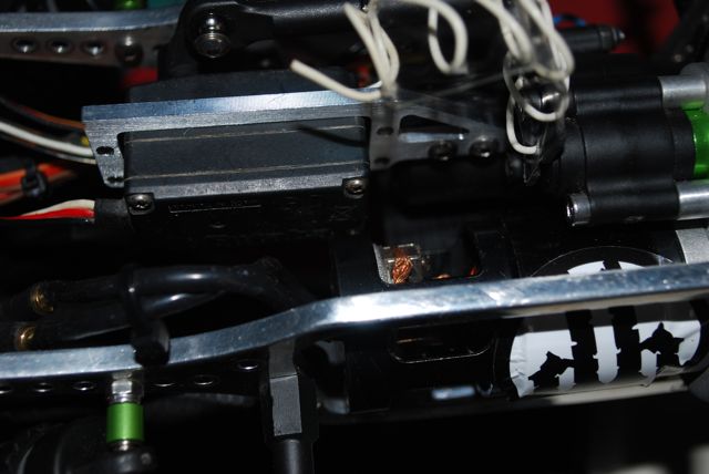

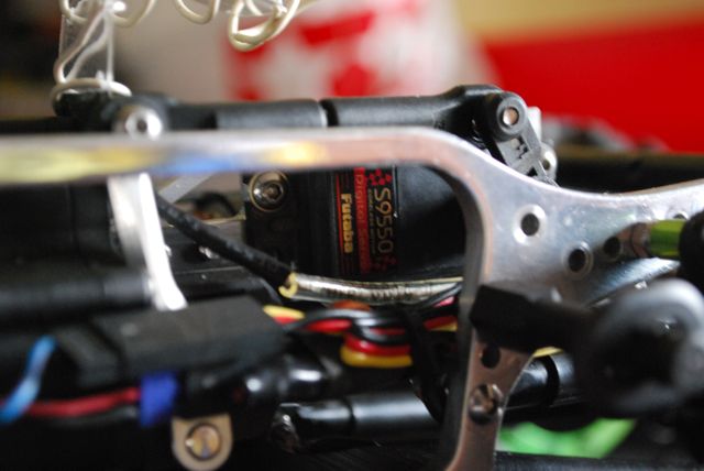

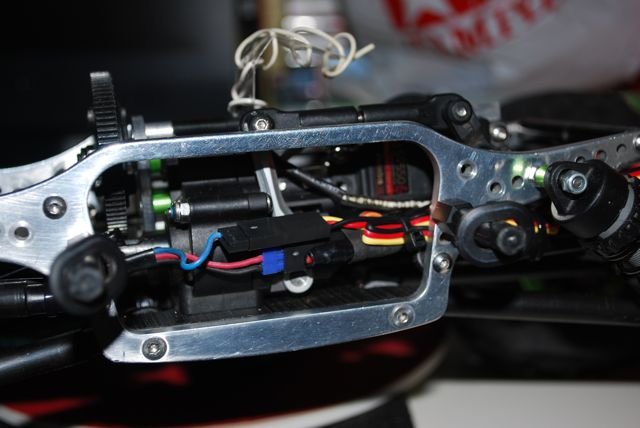

Here are some pictures with a 7T Puller and the Futaba Low Profile Servo "thumbsup"

Does anyone know of a cheaper alternative to the 9550 low prof servo for those you us using Coblat motors?
Here are the dimensions of the S9550.
Weight: 1.6 oz (45g)
Length: 1.6" (41mm)
Width: 0.8" (20mm)
Height: 1.0" (25mm)
The fit is quite precise with extremely minimal tolerance-- it will be a bit tedious, but you'll have to do a match-up as there seem not to be a standard sized for these low-profile servos (e.g. Hitec low-profile servo).
