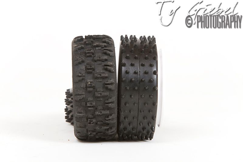

Not sure these are made for 1.9 wheels... Maybe 1.7s...
Mounted on Tamiya 1.9 rims. And compared to Tamiya rally blocks.
Set with a narrower wheel.
I got these tires for ice racing, but they are really soft. It might take a couple months for me to report back on these.

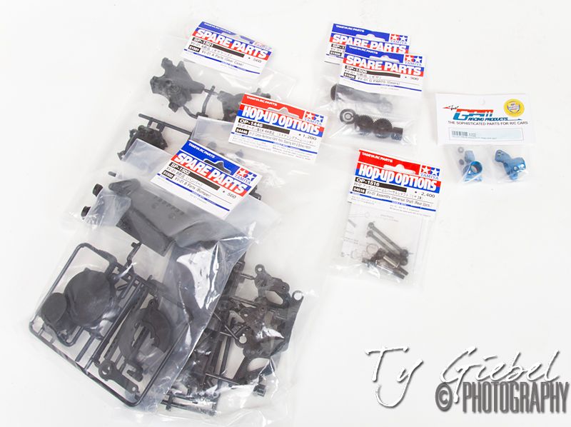

Some extra parts, one pack of reinforced parts, rear CVDs, and rear metal knuckles.
Hopefully sometime this week I will have time to start installing parts.
