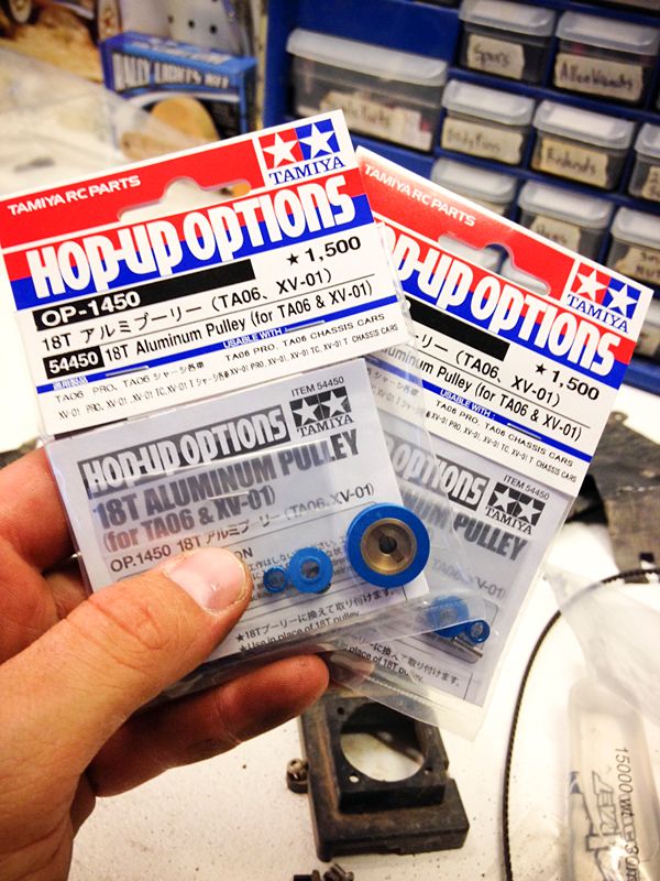

And pulleys. My existing aluminum pulleys were showing some wear, this over time can cause the belt to slip or wear prematurely, so I ordered two new ones and on they went.
